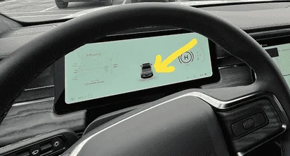

Been driving EVs for 4 years now and stick since I started driving. I was paying more attention to the brake lights in the on-dash representation and was actually bothered by the fact that the brake lights don't come on until I'm braking harder than I normally do coming to a stop in traffic. In a stick that's not a problem since you could just graze the brake pedal just enough to trip the brake lights. I love high regen, but it does seem like they should come on with slightly less deceleration.

Since it's right there in front of me on the driver display I can see when the brake lights come on during deceleration. When I'm driving an ICE and pass someone I let off the brake and coast to decelerate. If I do that in the Rivian it looks like I'm passing them and then brake checking them. So I try and make a conscious effort to slow more moderately after passing.

Any other colorblind (or otherwise) people here who have a hard time seeing the brake lights on the dash? I know they're there but it's very difficult for me to see in most conditions, even at night!
