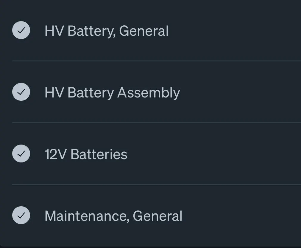

Update
So the Service Center told me there’s this great new feature Rivian just rolled out within their app where we can send service messages to one another. Well only problem is it doesn’t work. When I go to the messages in the app there’s no option to send anything and I’m not receiving any messages. I was told to try to uninstall and reinstall the app, but that I would lose the connection to the Rivian (i.e. PAAK). I don’t want to do this because I like checking in on my car - I can see where it is (out in the parking lot versus inside the service center shop), what windows/doors are open, etc. All that to say the bad news is I’m not receiving any updates. The good news, since I kept the iPhone app, is that I can see it was in the shop today and was charging. The battery error message was no longer in the app either. Within the service appointment was the screenshot below. So, all in all, even though I’m in the dark (I could call, I know…but then I’m on hold and they transfer me and the SC is annoyed…), it seems like there’s progress.
More to come…

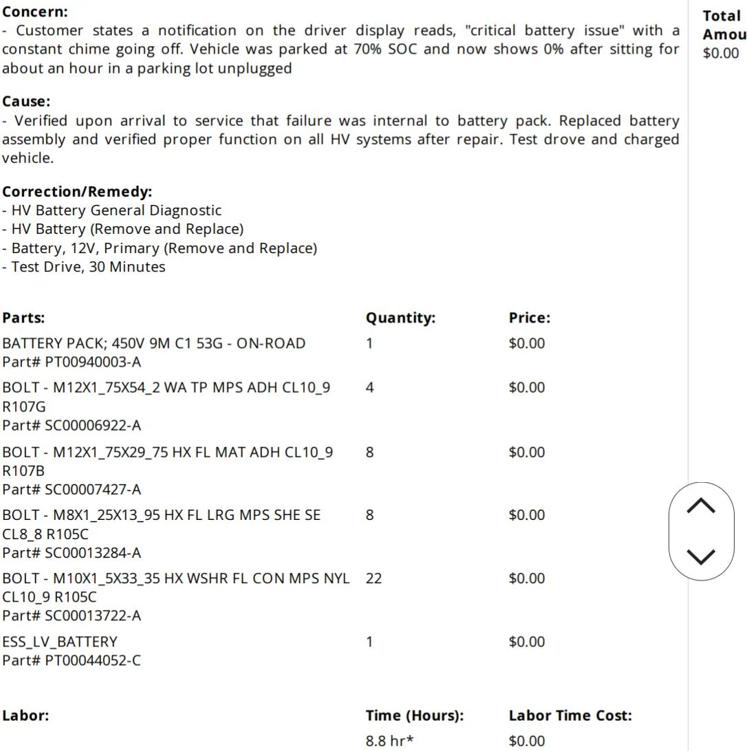

The HV battery has been replaced. I’m told it was charged and test driven and everything is fine.
Importantly, when I pressed, I was given NO explanation as to why or how this could happen, nor if I could expect it to happen again. Pretty disconcerting.
On the positive side, I have a new battery and hopefully this was a one and done. The service was fast (tomorrow will be one week from it bricking and getting towed), and the loaner was nice.
Fingers crossed…

Closing the loop here. Hopefully my sharing this adventure here will help others in the future when it happens to them. Attaching the work order. Vehicle is back in my garage with new batteries. Let’s ride!
