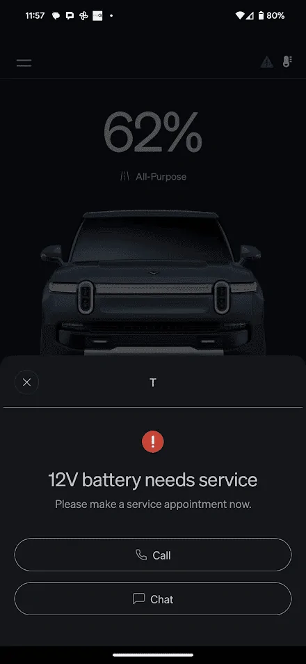

Has anyone had any repeated "12V battery needs service" warning pop itself multiple times, but be easy to clear? I've had it three times over about a week. Chat Service had me reset truck, cleared it up. Second time it came up was just before the latest OTA, so that restart also cleared it. Today, third popup, but just waiting about 20min and it was gone by itself. Second Chat Service session today did not have me do anything, aside from teaching me how to trigger diagnostic capture, but it was clear before I did that. I've have no visible issues so far, but ... I've been through 12V battery failures in my Leaf and Volt before, and it can be quite the confusing experience.

This one? Yep. Mine didn't go away during the initial testing that service chat had me do, but after charging on a slower charger for ~8 hours it went away. Until the charge session ended and I checked again later. Currently missing but I'm sure if I didn't have the vehicle plugged in right now it'd come back. Planning on letting it sit overnight unplugged before I bring it in to service.
Yes, that one exactly. Given my other vehicle experiences and these related forum post stories, I'm a bit leery of chalking it up to software.

Identical conditions and my R1S is not throwing the same error. I would push Rivian to look at it deeper.

Yes indeed... waiting to hear from Nashville Service Center about feasibility of a mobile service visit.
