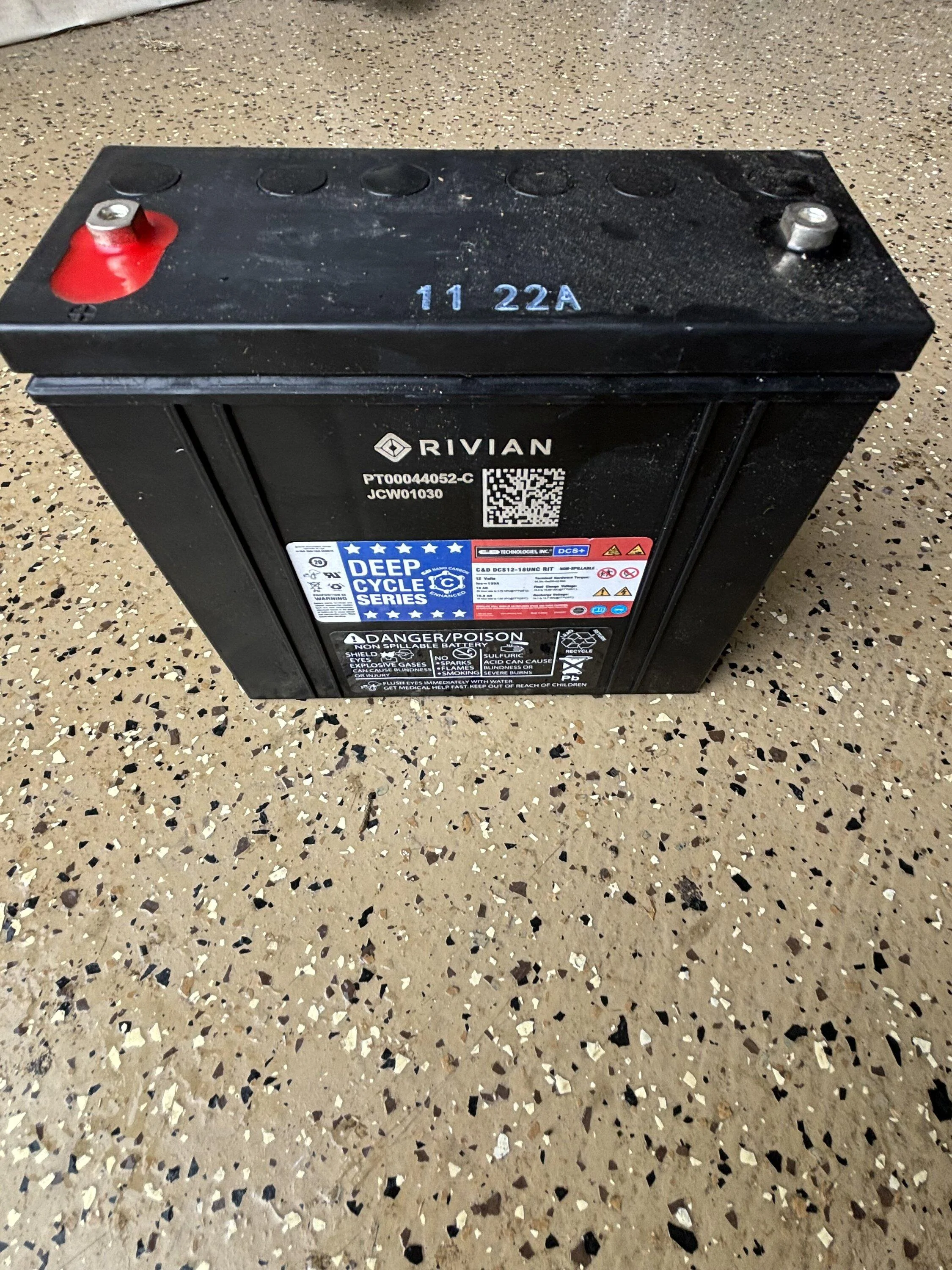

My R1S has been resuscitated. If you wish to bore yourself to death-read on:
Lessons learned are (1) never park your car in your driveway in such a manner that you could block your other cars. This will only validate your significant other's assumptions regarding your intellect; (2) good luck jumping your Rivian using the tailgate module (up the arse)-it just won't work, (3) don't warm up your car (at least until Rivian has fixed this issue).
Rivian SC got a mobile tech out around noon today, which was very fast. He replaced the 12v battery within 15 minutes. Btw-that battery is smaller than a bloody moped battery! Alas, that did not solve the issue. He then used his laptop to diagnose the problem. The culprit, ladies & gentlemen, was the VDM. For those of you that think that this is some sort of sexually transmitted disease-you are wrong. It is a Vehicle Dynamics Module (the tech told me). I have absolutely no bloody idea what this does. Only thing I know is that my car is now working. It is located near the foot pedals. He did something with his laptop and got down by the foot accelerator and did more things (technical jargon) whilst I worked hard at sipping my tea and asking useless questions to which I did not understand the answers to.
The VDM issue is apparently more common than we thought and Rivian is investigating it. Thank you all for your advice and great sense of humour.
