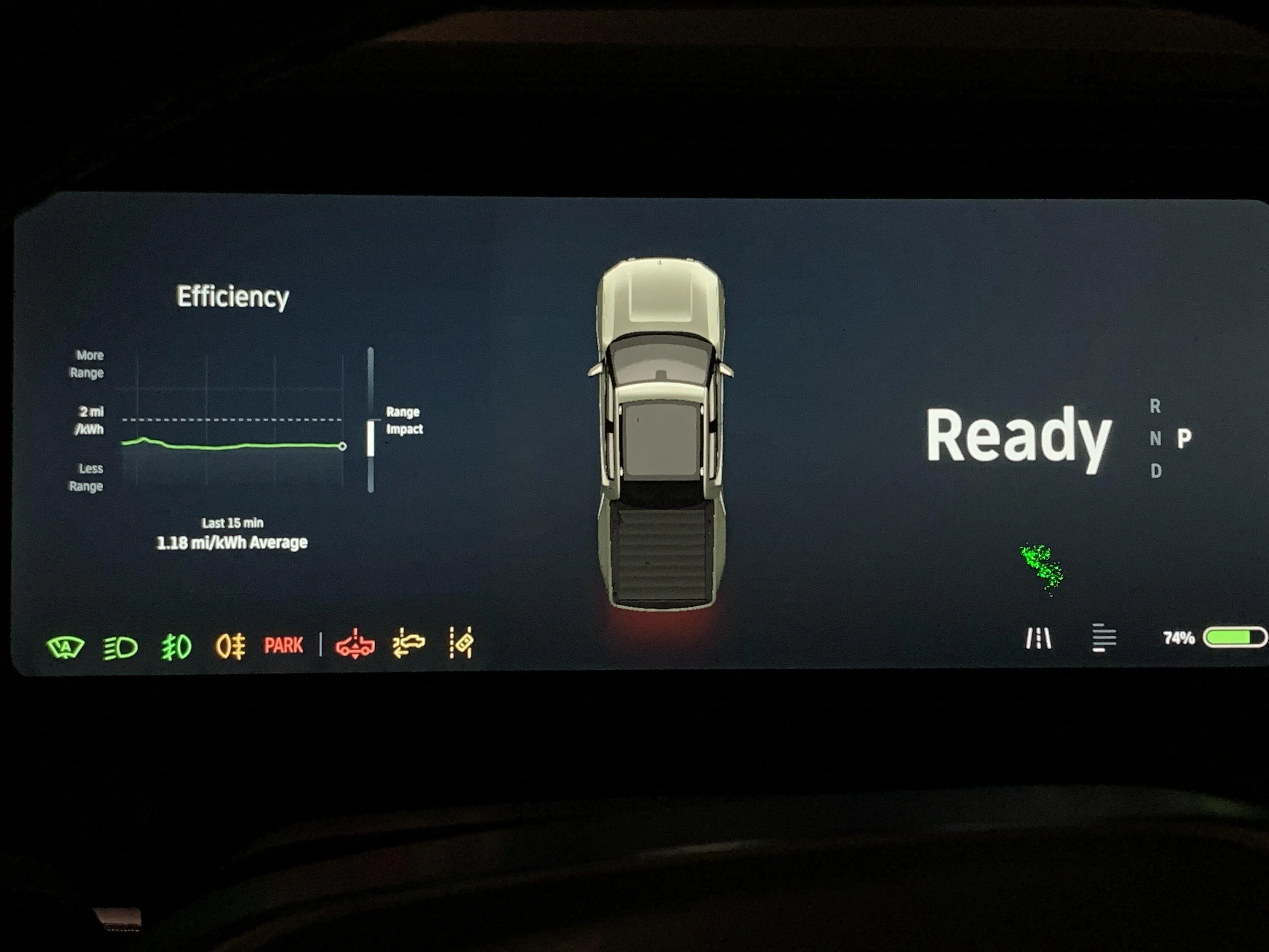

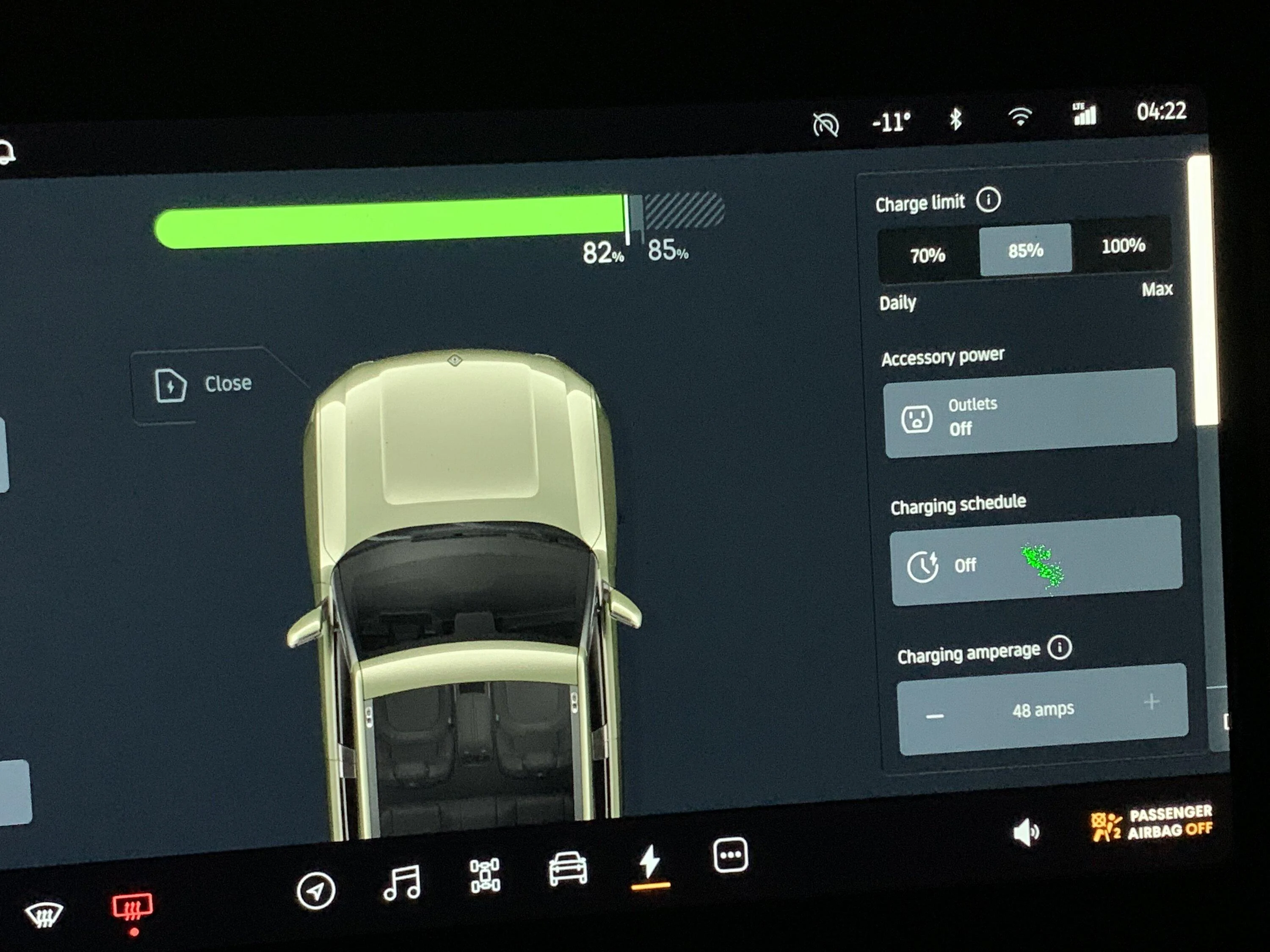

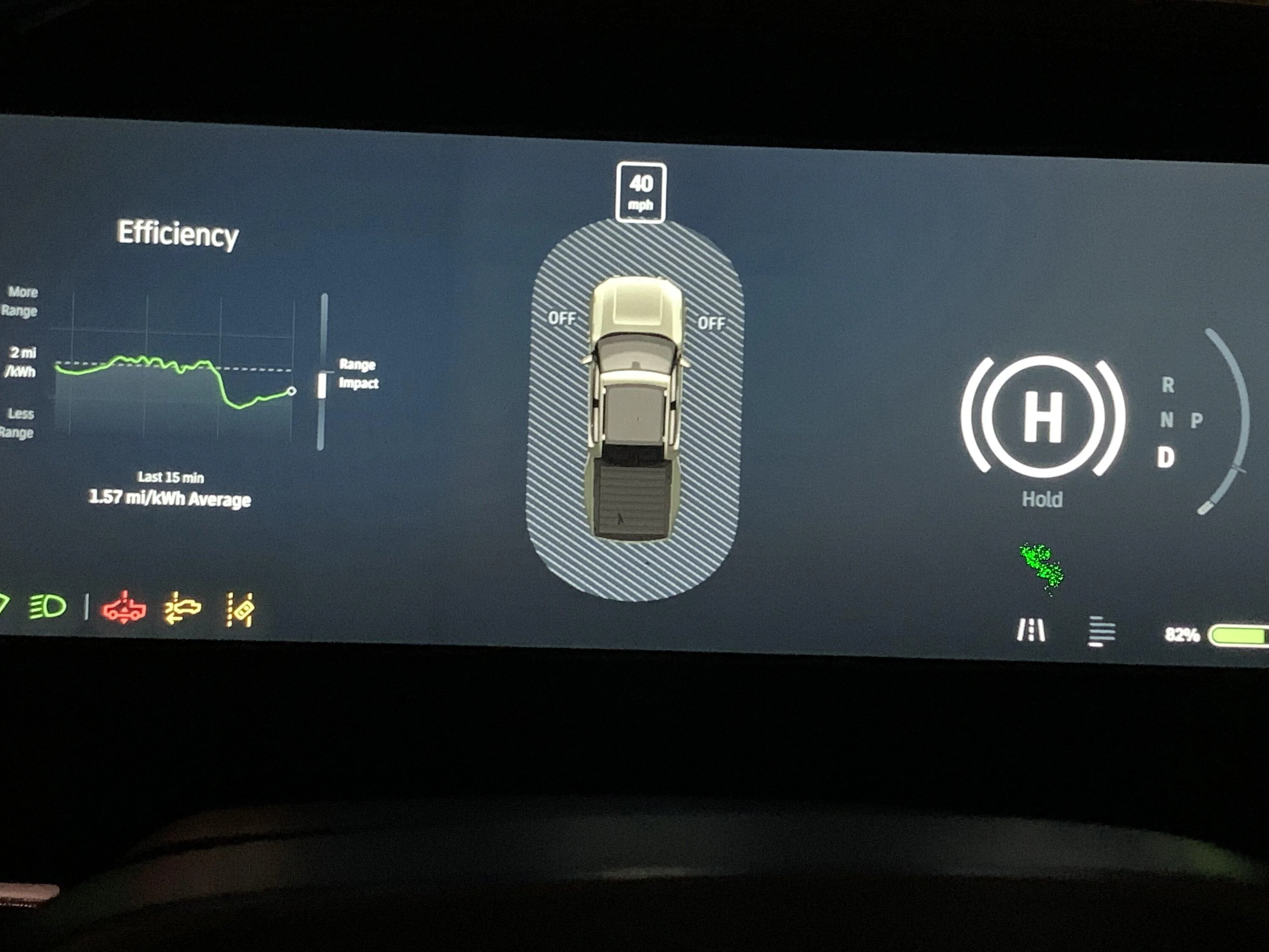

…and this are the results of 25-27 miles of driving in -11 temps. No kneeling mode or adjusting to snow mode(air suspension warning on dashboard) and efficiency mileage drops significantly (as expected). All sensors are off too…
Rivian R1T R1S Cabin Heater Impacted Significantly by Outside Temp CA3D7C81-E1F7-4DB3-8CD9-3A3BE514DCE6
Rivian R1T R1S Cabin Heater Impacted Significantly by Outside Temp D1719C7F-0435-4AA5-BA38-321229518D59
Rivian R1T R1S Cabin Heater Impacted Significantly by Outside Temp 533A6759-9C2E-4837-8631-BD4DB4F1335F

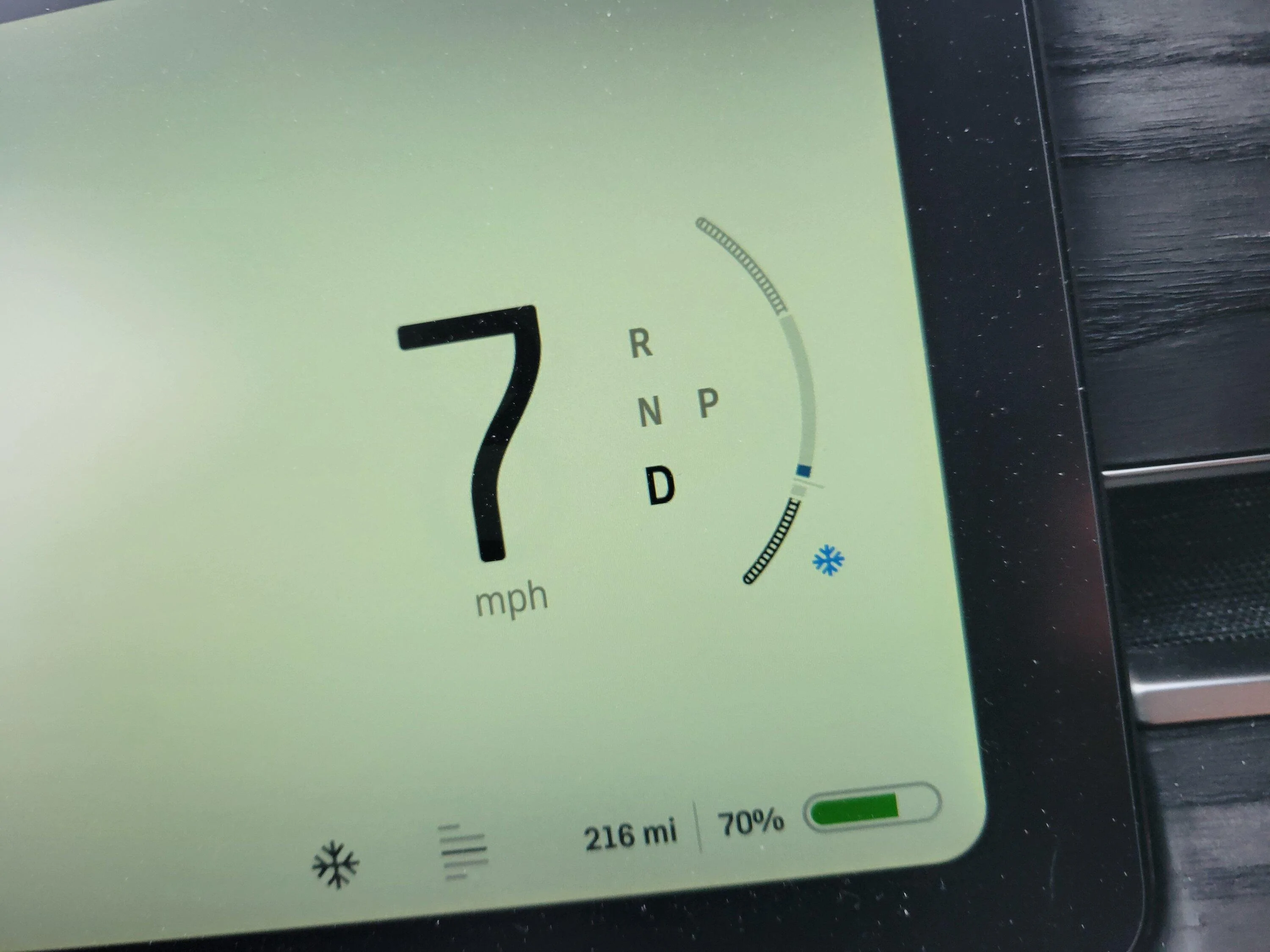

Rivian R1T R1S Cabin Heater Impacted Significantly by Outside Temp 20221223_082051
Definition of cold soaked. So cold regenerate braking did not exist. It shows a sliver available but was basically coast mode. ?
