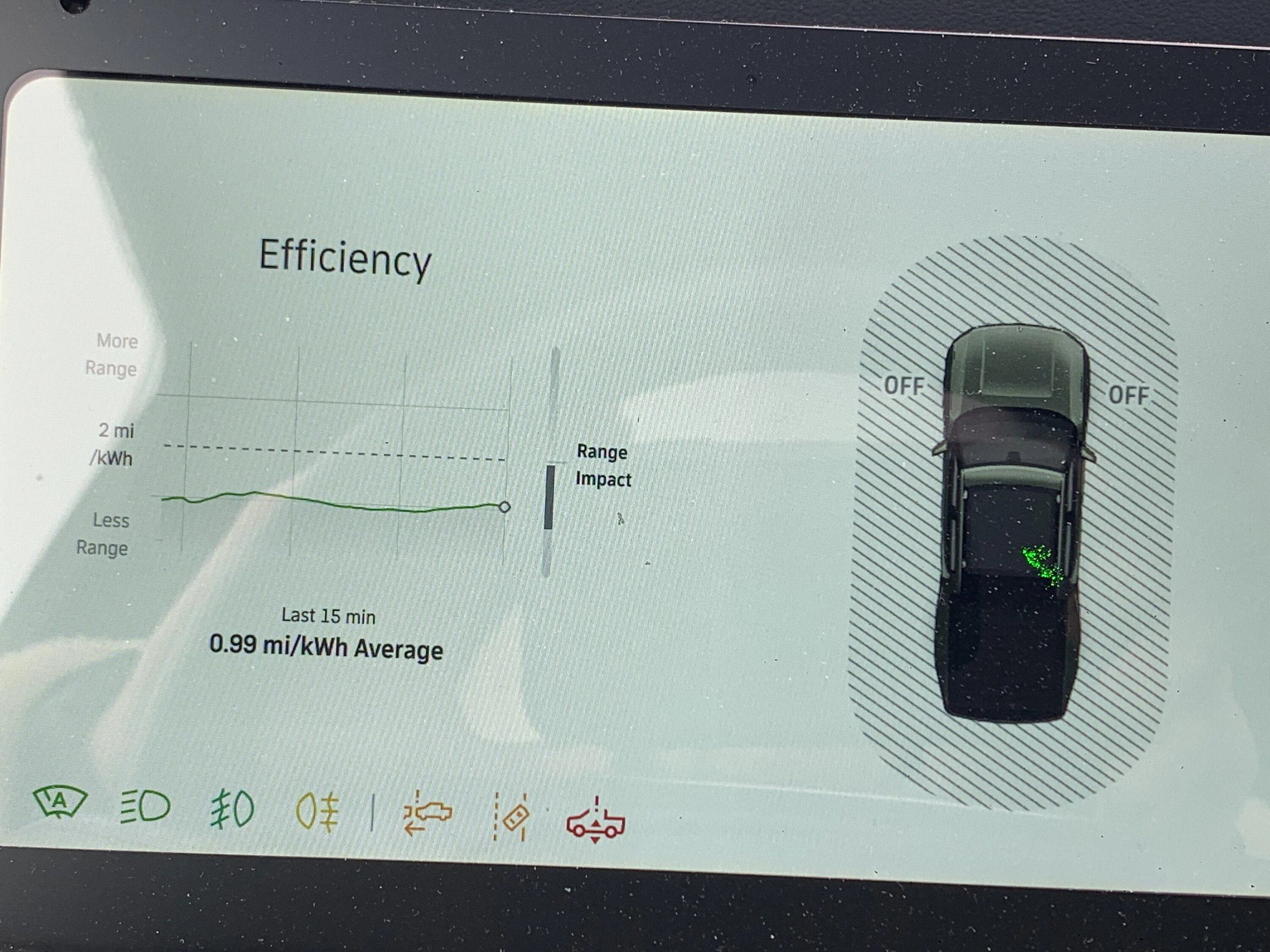

I disagree. It is -8f today and I had no issues with it being plenty warm (better than preheating an ICE by running engine for 20 minutes to get heat) and unless one is traveling to extents of range, range degradation is pretty meaningless for daily uses. It would have to get to as bad as .5m/kwh to be even to a TRX or Raptor for cost per mile of fuel. And I have not seen worse than 1.25 m/kwh. So still alot less money and as much fun.
My worst efficiency numbers so far…
I am guessing you did not precondition the battery and cabin (while being plugged in) prior to departure?

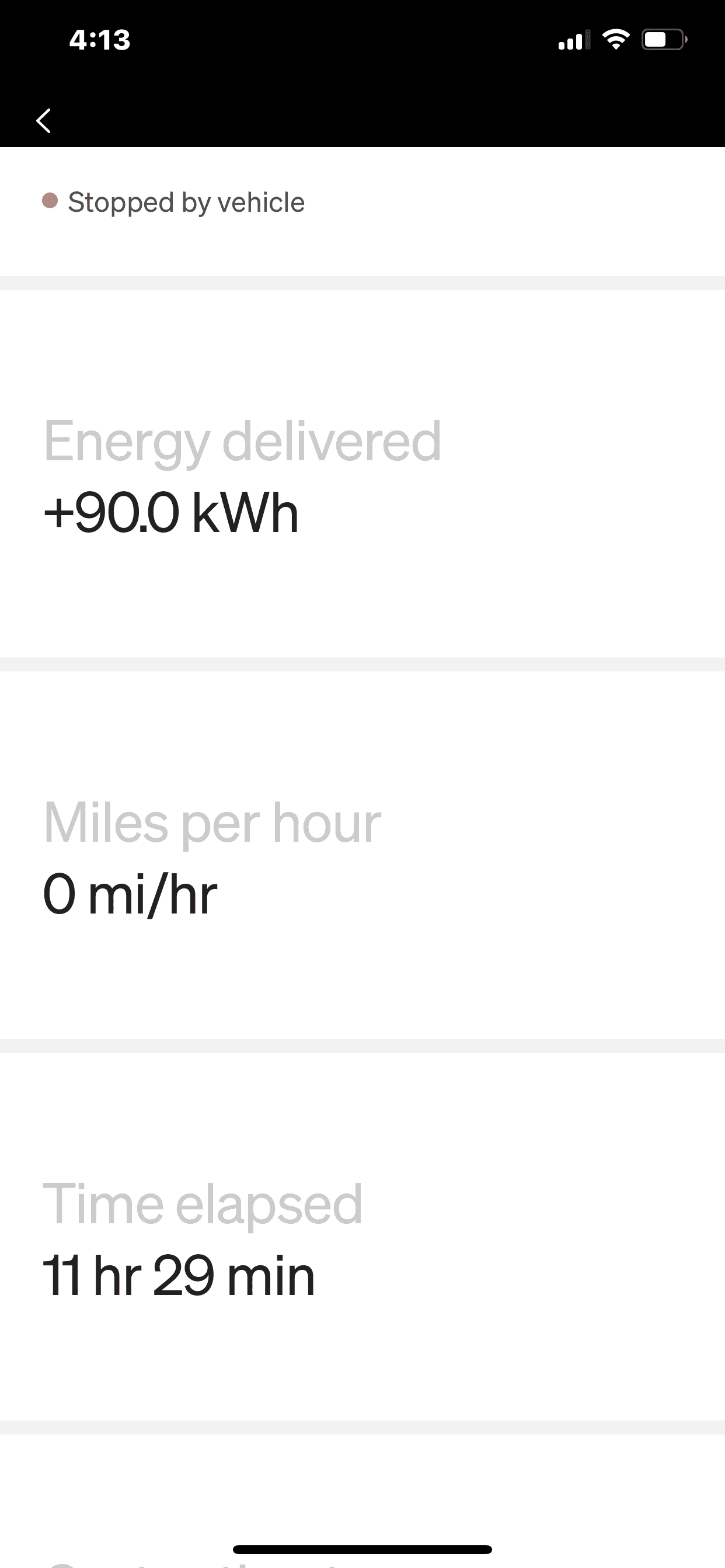

[/QUOTE]
For this short trip, ur right. No precondition but for first trip (at 4 am) I have plugged all night long just to play safe considering the weather (-11 F)
