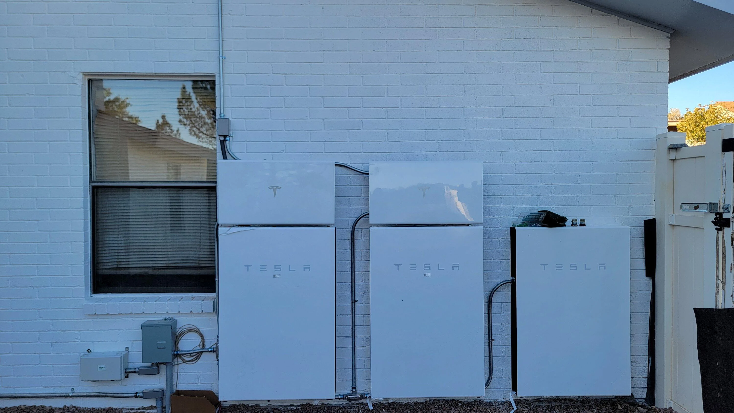

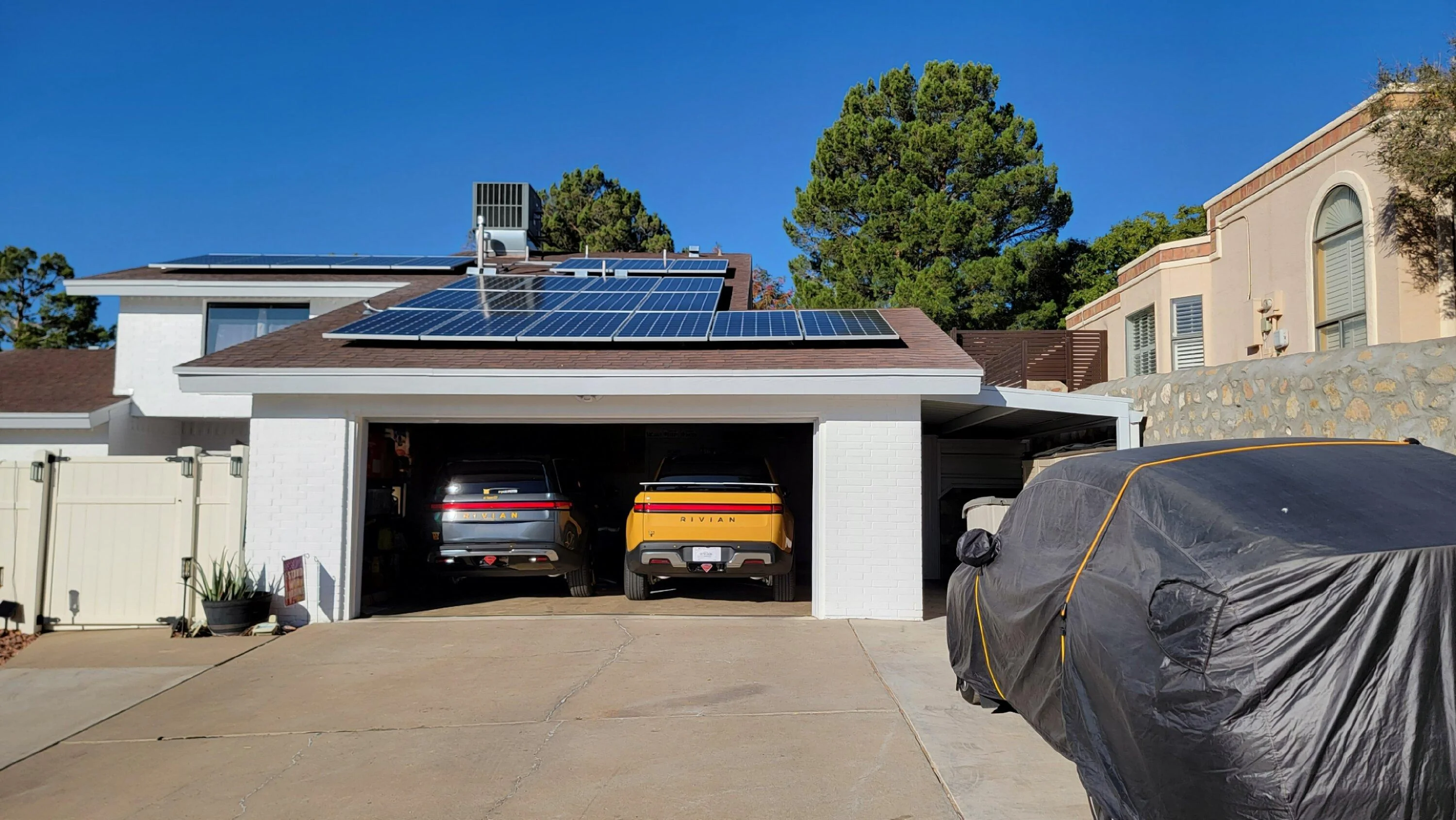

My solution to stay off grid while living within the city limits; a 15.5kW solar sytem with three Tesla PowerWalls to keep my house powered up 24/7 and to occasionally charges my two Rivians, one Tesla and one Zero electric motorcycle :rock:
Are you completely disconnected from the grid?
Is that a commercial RTU on your roof?

I should be able to because my system's maximum capabilities is approximately 400% that of my average monthly usage; weather dependent, of course :fingerscrossed:
That's awesome.... in that case you would want to stay on... Feed thst excess back to the grid. Especially if your utility pays retail vs wholesale.
I have community solar right now. Mainly because of the payback time, wife doesn't want panels on roof, and we don't plan to be here long term... Maybe another 3 years or so. Our dream is to build our forever home with grid being the backup. Design from the get go with a solar roof. 100% offset plus some extra for future needs.

1 Tesla Powerwall = 13.5 kWh, correct?
If your vehicle’s battery state of charge were low (<20%), you need to charge your vehicles during the day, when the sun is providing energy, rather than draw energy from the Powerwall(s) overnight to recharge to ~80%+?
