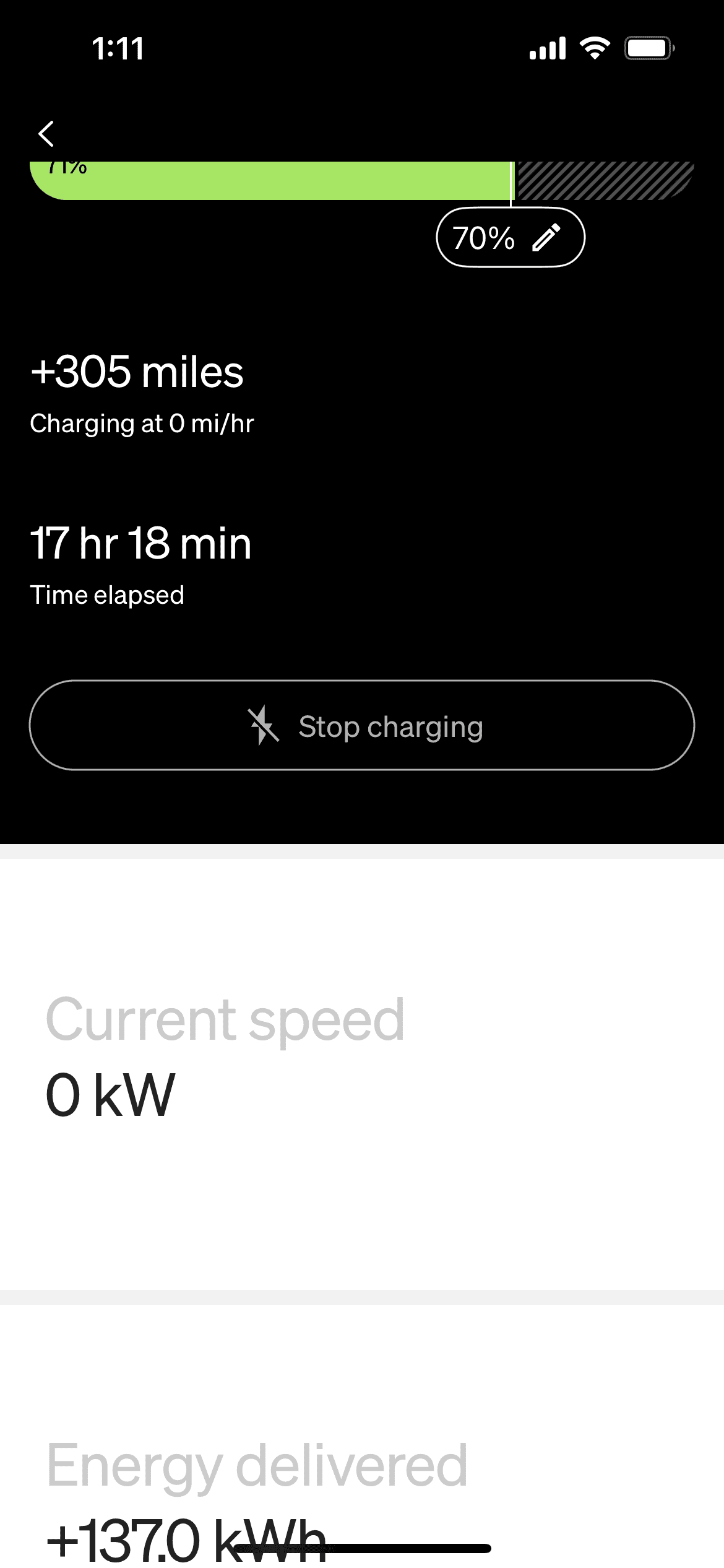

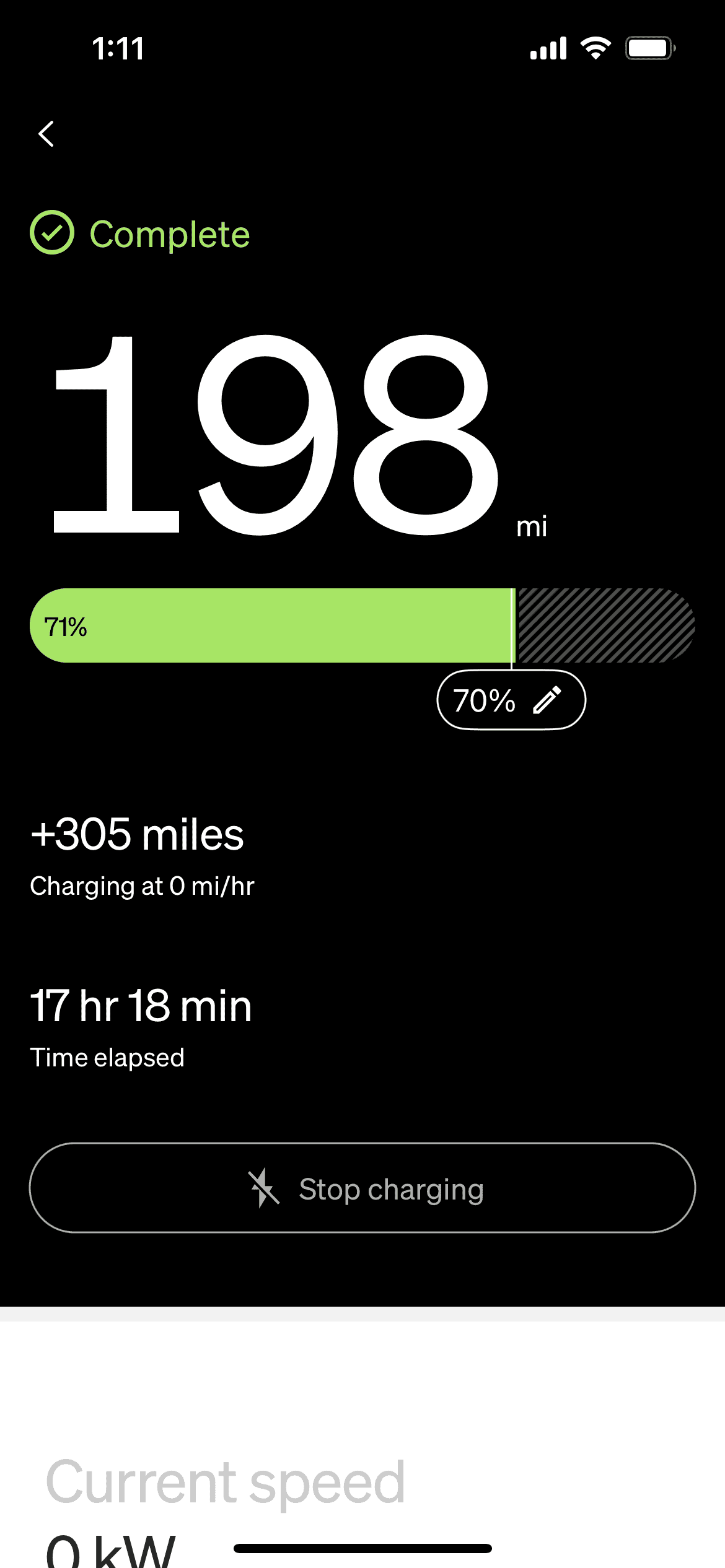

Don't trust the app. For example my truck says I added 137kWh in my last charge last night (from ~30% to 70%) which is of course impossible. I had seen something similar the other day. I mean I love how I added 305 miles of range to my truck to get to 198 miles.

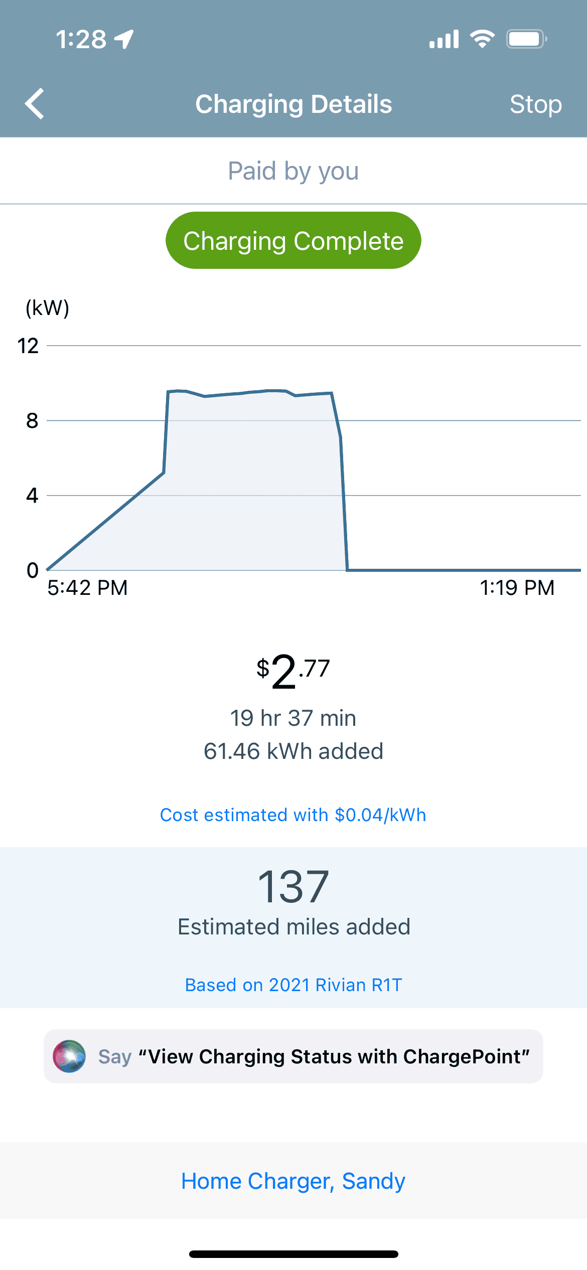

Or your truck isn't turning off (door not closed/frunk not latched/etc) and you are wasting a ton of energy. I would actually look into that. What does your charger say it delivered? Your charger could have added 305 miles if your burned over 100 miles while sitting there. My app has always been accurate.
Could be that high if you left the truck on and windows down in sub freezing temps.

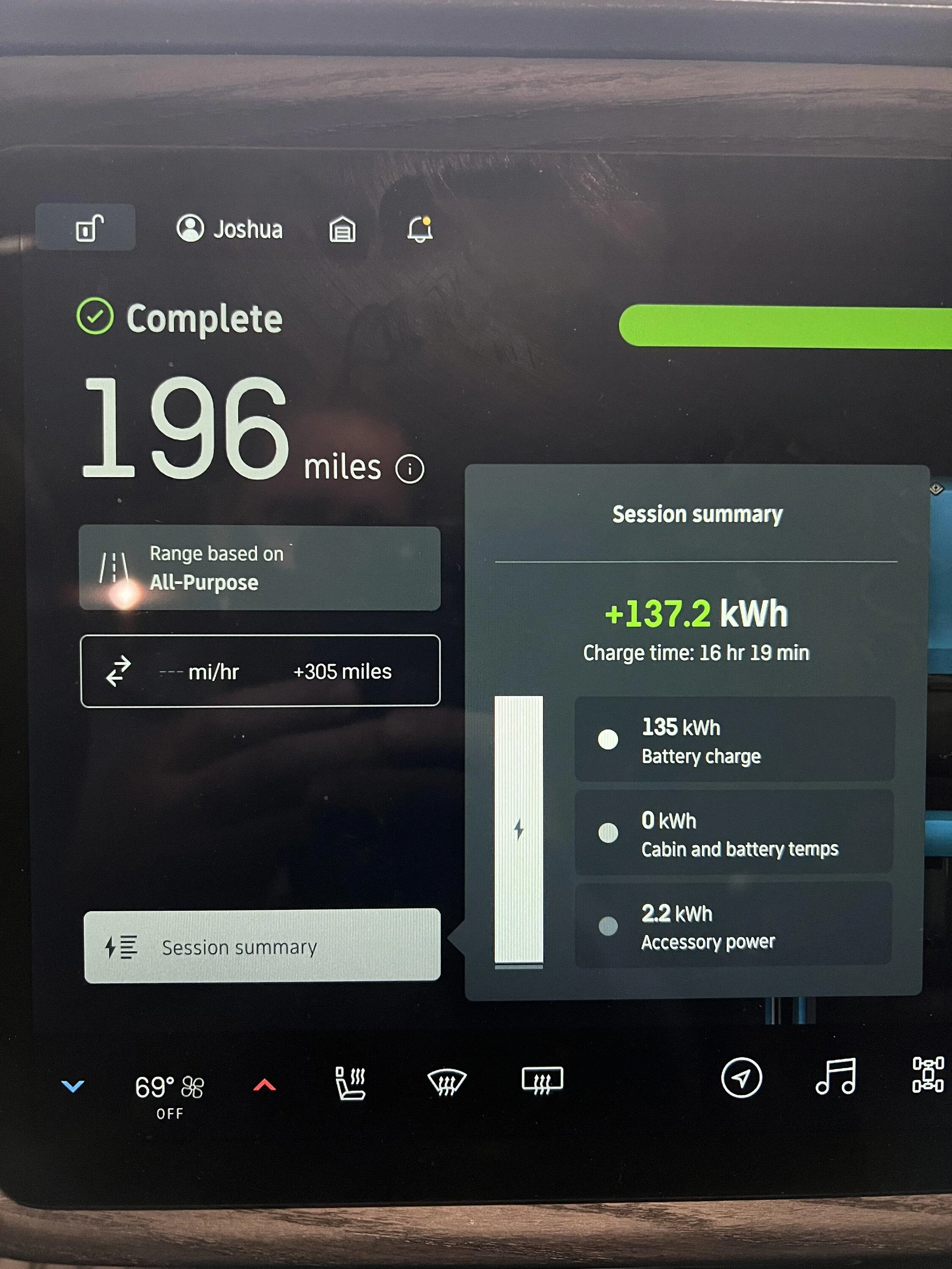

Nope it’s not right. Would be impressed if the truck charged 137kWh in my 8 hour scheduled charging time (10pm to 6am) at 9.6kW.
Rivian R1T R1S Charging time discrepancy being showed between vehicle display and phone app 9DFB01A9-9834-4F01-8EFC-F770A5EA7210
Edit: on a second look seems the truck is confused too.

Looks like it's a bug where it just starts the calculation from when your scheduled charging kicks in until you unplug it. I don't see anything weird going on like that in my charging history.
