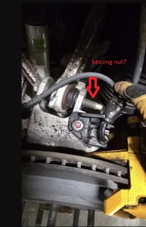

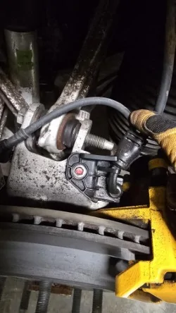

My ’22 LE R1T had a similar issue last year with ~20K on the odometer. After crawling under the truck, I discovered that a rear suspension toe-link bolt had come loose. Fortunately, the bolt itself was still in place—the nut was missing. I made a quick trip to the hardware store to source a replacement in case the Service Center couldn’t get the truck in right away.
Even though I replaced the nut and torqued it to spec, the Service Center still went above and beyond. They had the truck towed to the SC and had a loaner R1T waiting for me. In the end, they replaced all associated parts and hardware, including the rear subframe, to ensure no tolerances had been compromised.

@Jonger1150 - Yes, the nut was missing from the toe link bolt. The torque must have been out of spec then just vibrated off the bolt.
