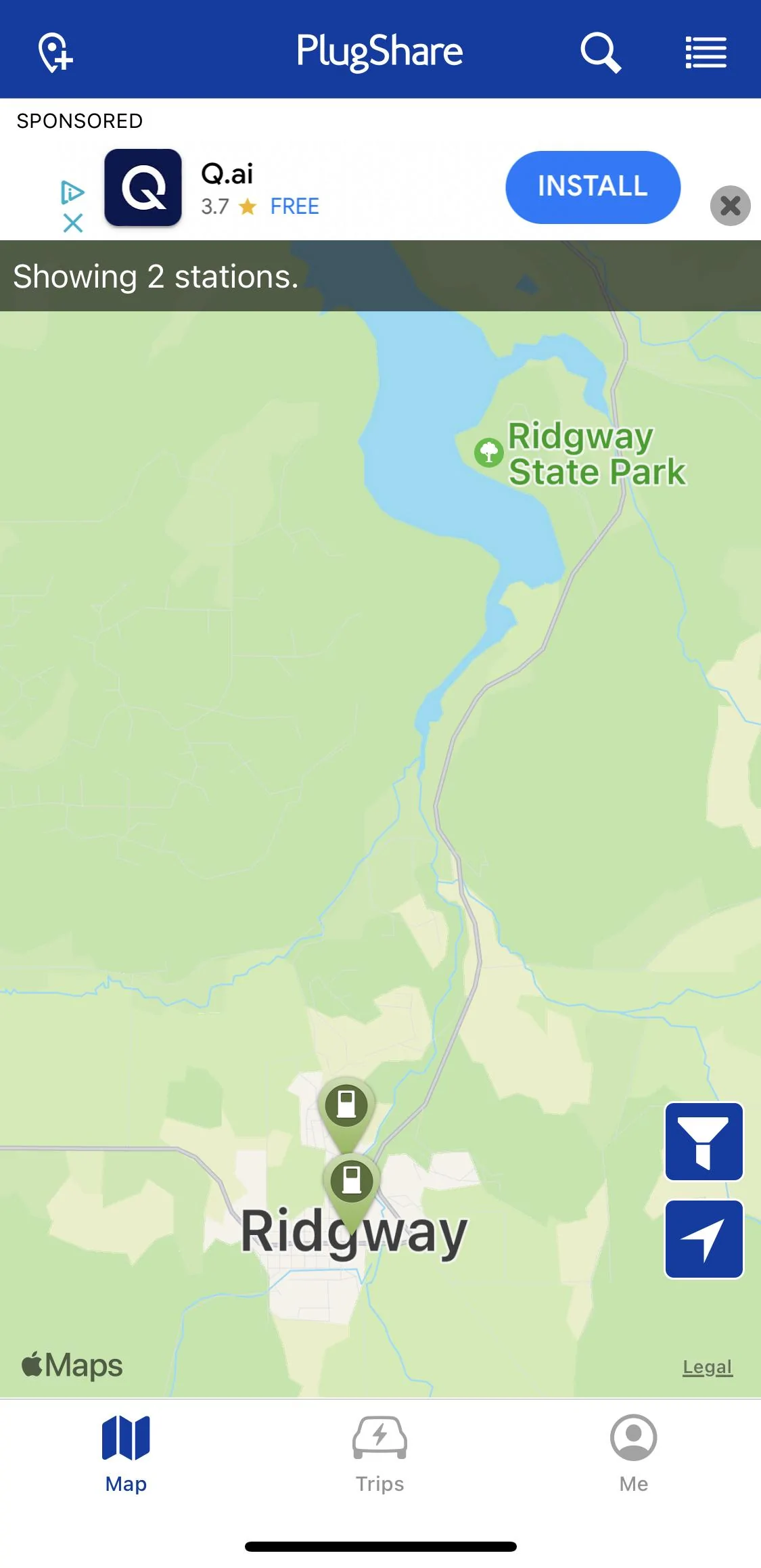

Were Rivian Waypoints not installed or operational at Ridgway State Park?
And I guess you didn’t want to sleep in your truck while charging in Ridgway overnight?

Didn't see any Waypoint chargers or signs to such in the park. I don't think they've built them out yet, just made the agreement to do so.
I slept in the RTT at Ridgway on the way down. I didn't yet have an adapter for the 30a socket (that'll be delivered tomorrow) so I would have had to settle for 110v. I didn't bother as it wouldn't have changed anything enough prevent the trip back to Montrose. I'm assuming though that you were joking about using the low power EV chargers on the trip back. Was going to camp at Cimarron, but it was closed so I drove home.

Thanks. Sounds like I won’t need to purchase an adapter in order to use the free J1772 chargers in the town of Ridgway. I have used these chargers for my Tesla.

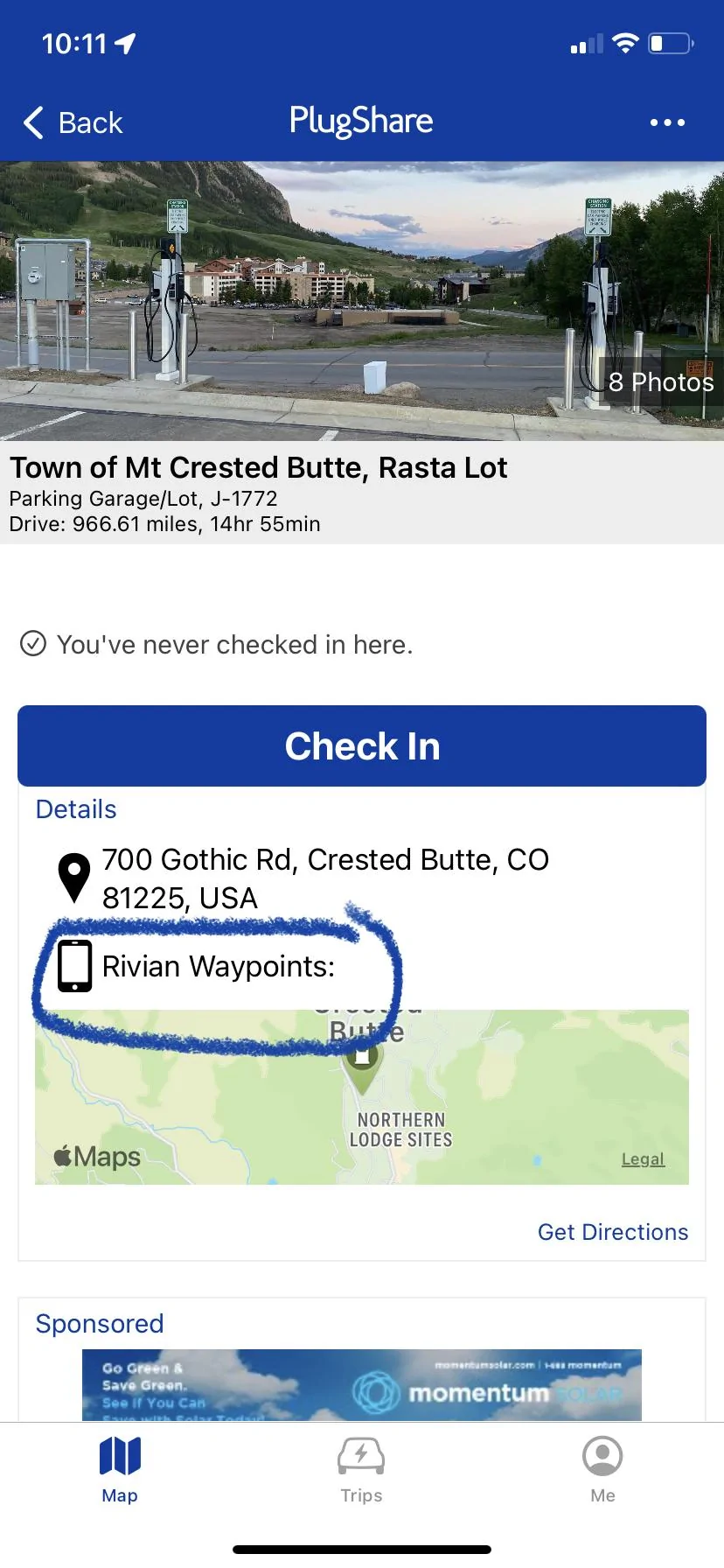

Just found these new Rivian waypoints in Crested Butte, Colorado. Is there a Waypoints map for Rivian?
