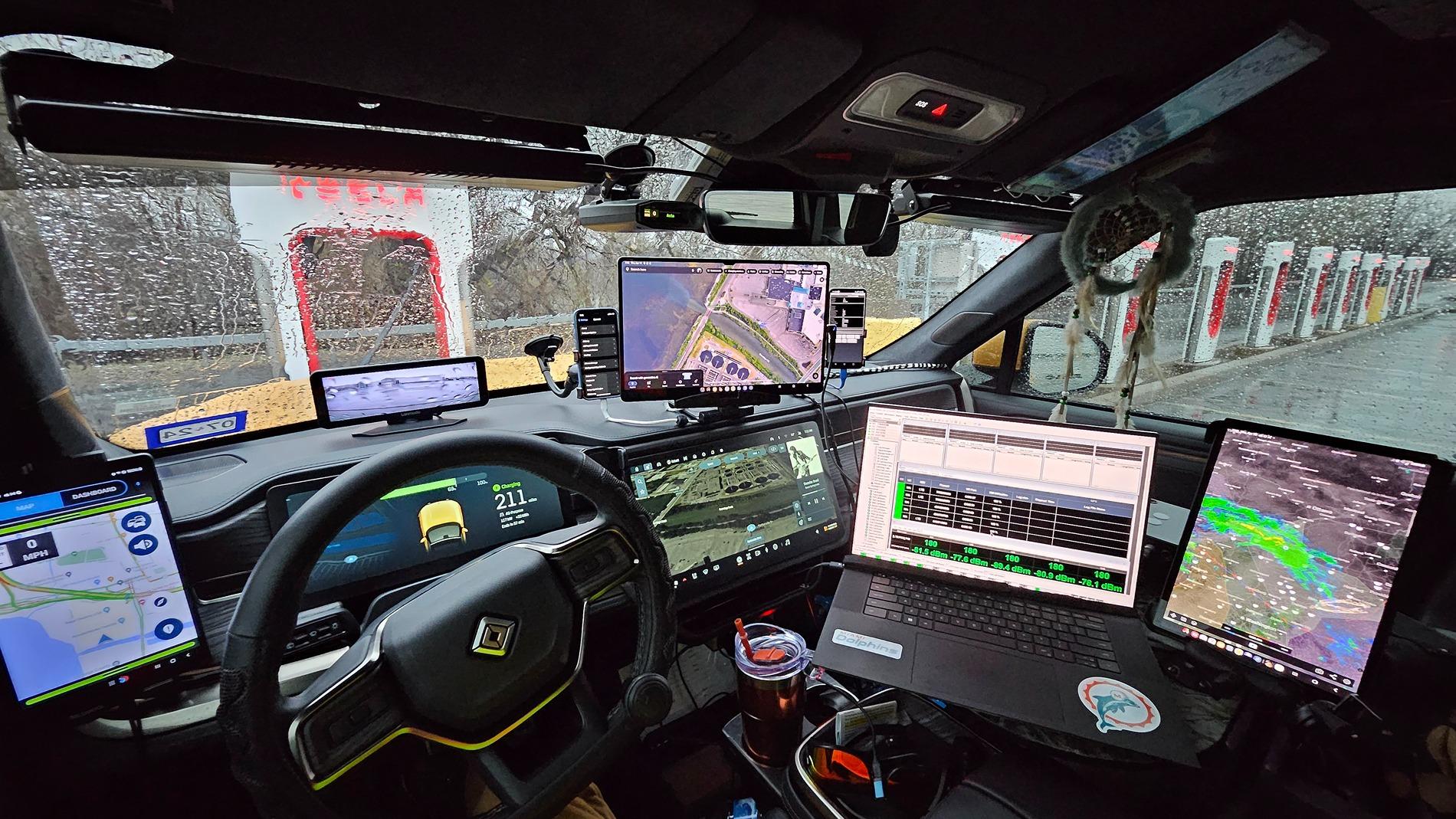

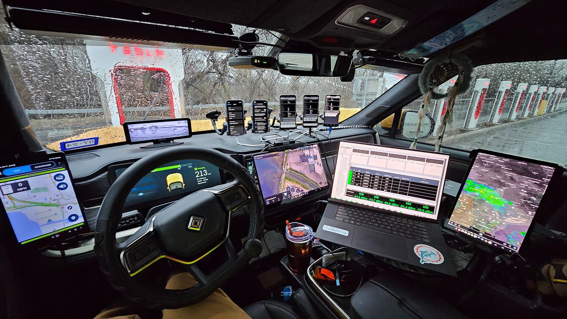

FWIW... I too ordered up the comma 3X & received it last week. The Chun Mag Quick Mount was ordered as well & should arrive by next week sometime & I did also order the Harness thru Lukas (in Germany) to help him with the development of this project & I hope to get his version of the Gen1 Rivian Harness by end of March or sooner... I can't wait for "hands-free" driving that was the main reason I preordered my R1S (aka "Tarkus") back in April 2021, just wished Rivian hadn't given up on that promise... buy I digress....
I got room for one more gadget in my "Mobile Wireless E911 Drive Testing Office"... :cool:

I saw your setup on Discord. Impressive. Mind me asking what it is that you do in that. And don't you have any trouble with your line of sight being impaired?
I test the Accuracy of Wireless E911 Calls by driving around a given county per day and making some 300+ test calls & no line of sight blockage with the current setup. I've been testing wireless E911 calls for some 20+ years (inside building using Z-Axis & outside driving). I luv to drive... :cool:
