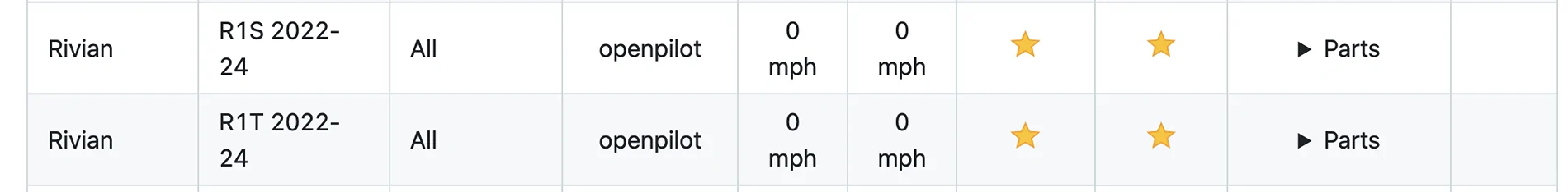

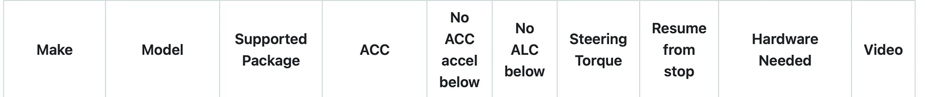

Thanks for all this information! It's a bit confusing because comma's web site appears to show basically complete functionality available for Rivian. Have these changes been merged or is there something they are counting as part of "all" functionality that's incomplete or janky?
Rivian R1T R1S Comma AI / OpenPilot Autopilot Progress on R1! Screenshot 2025-03-07 at 8.44.25 AM
Rivian R1T R1S Comma AI / OpenPilot Autopilot Progress on R1! Screenshot 2025-03-07 at 8.42.18 AM
You can use the release 3 staging fork. Just go to https://openpilot-test.comma.ai/ and load from there. Don't let it install OpenPilot (OP) from the main screen when the device starts up. Also make sure you set up a connect account and scan the barcode on the device and have it added it to your account.
The latest updates will be automatically pulled from that release fork until it goes into general release as part of the main OP software. Just make sure you connect it to WiFi or subscribe to their service to keep getting the updates. Once it is setup it, it will let you know if a new release is out so you can update it. Very simple, just like Mac or Windows updates at that point.
