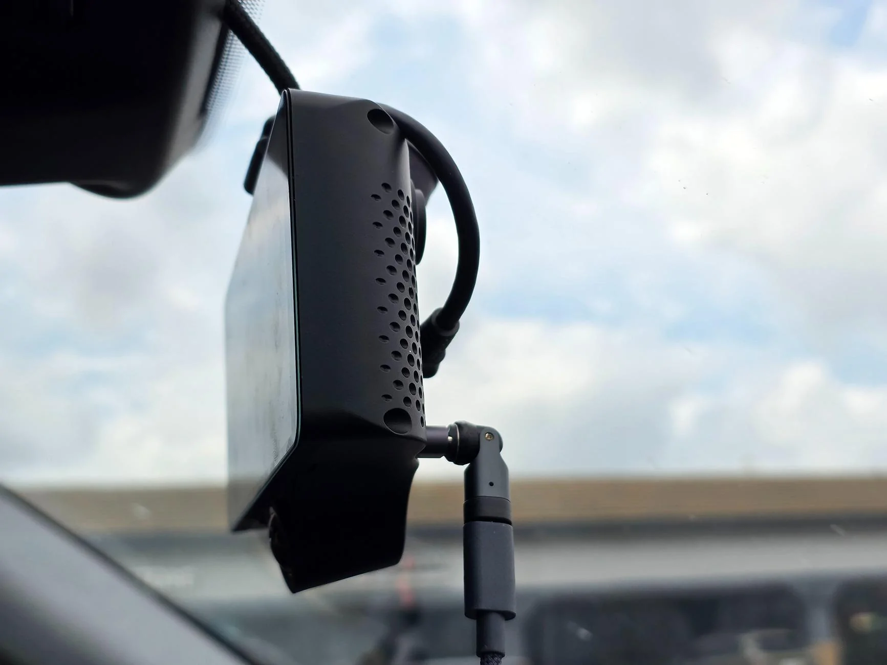

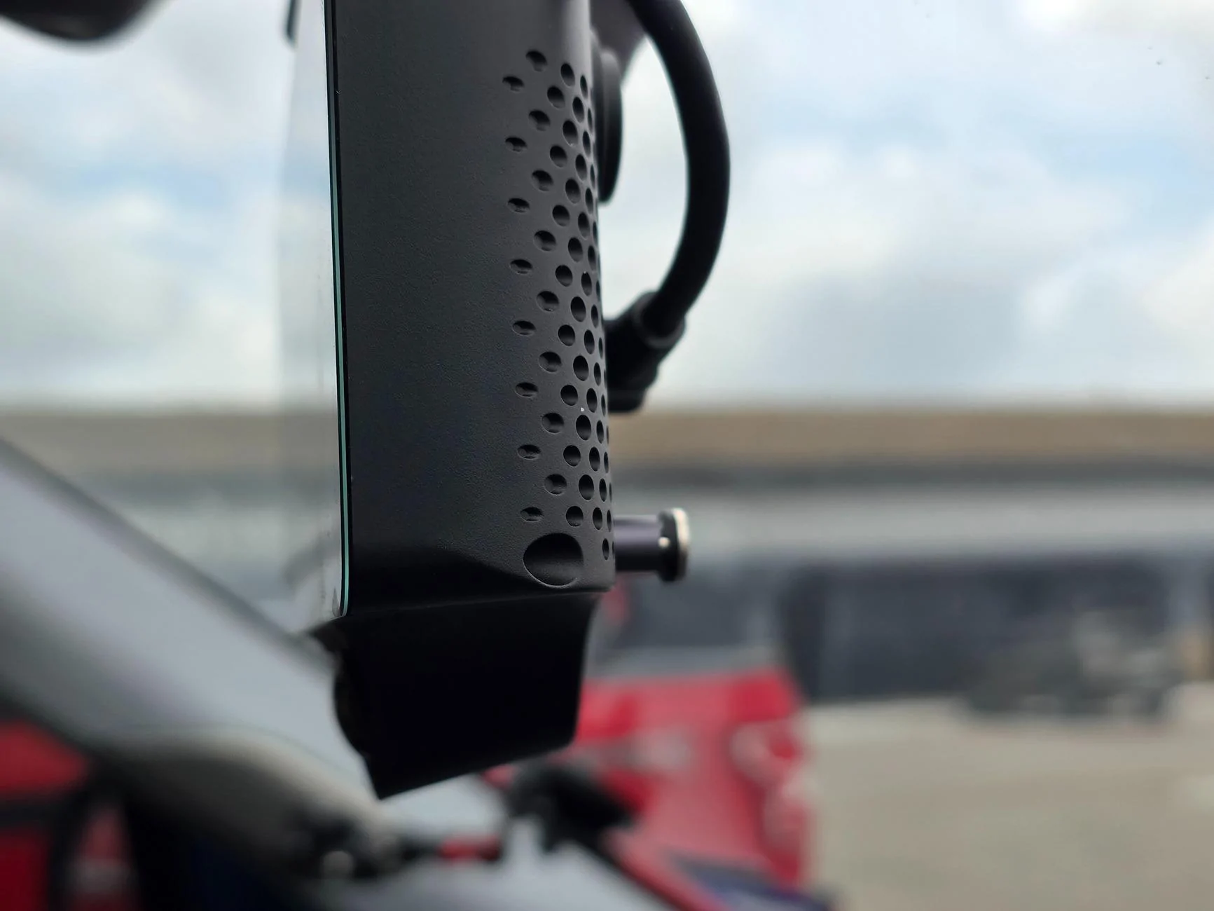

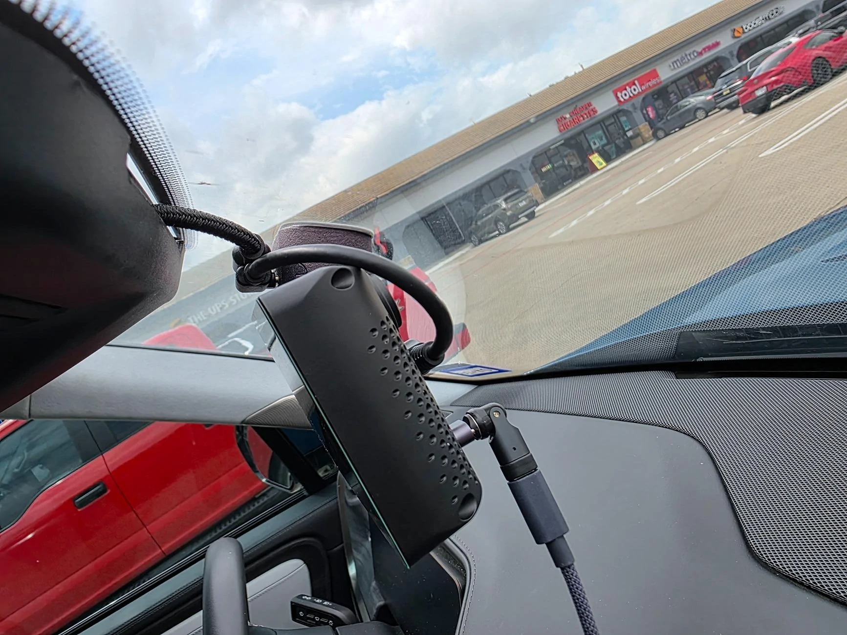

Perfect! thanks so much. I misunderstood that for the horizontal control, we would need to utilize a second USB port which may not work with the mount. Is the horizontal control a different box or accessory?
Yes, we would need to utilize the secondary USB port on the Comma for the additional signals for steering wheel button controls and blind spot monitoring, but you can still use the Chun mount. I just have an additional magnetic connector on the secondary port so it's still easy to take on and off. I'll take a photo of my setup so you can see.

I have the cable hanging down to the footwell for testing, but eventually I'll route it up through the A-pillar like the other one.

Thanks for the info. Bad news on needing a 2nd usb C as I assume that makes the magnetic mounts ( I have the beartech) effectively useless as it only makes connection to one USB port.
There are magnetic USB-C cables to minimize the pain. A couple of us are talking about this on the Discord and consdering a 3D printed mount for a USB magnetic plug. Janka is in there talking about a potential change too. Overall, the worst we will have to do is have a magnetic USB-C that is separate, but still quick.
ScoobieSteve
Steve
Mar 5, 2025
New England/NH
Thanks! this helps gain perspective! I will hope to route both cables at the same time on install. I like the idea of a magnetic USB-C for the 2nd cable. I appreciate you sending this!
