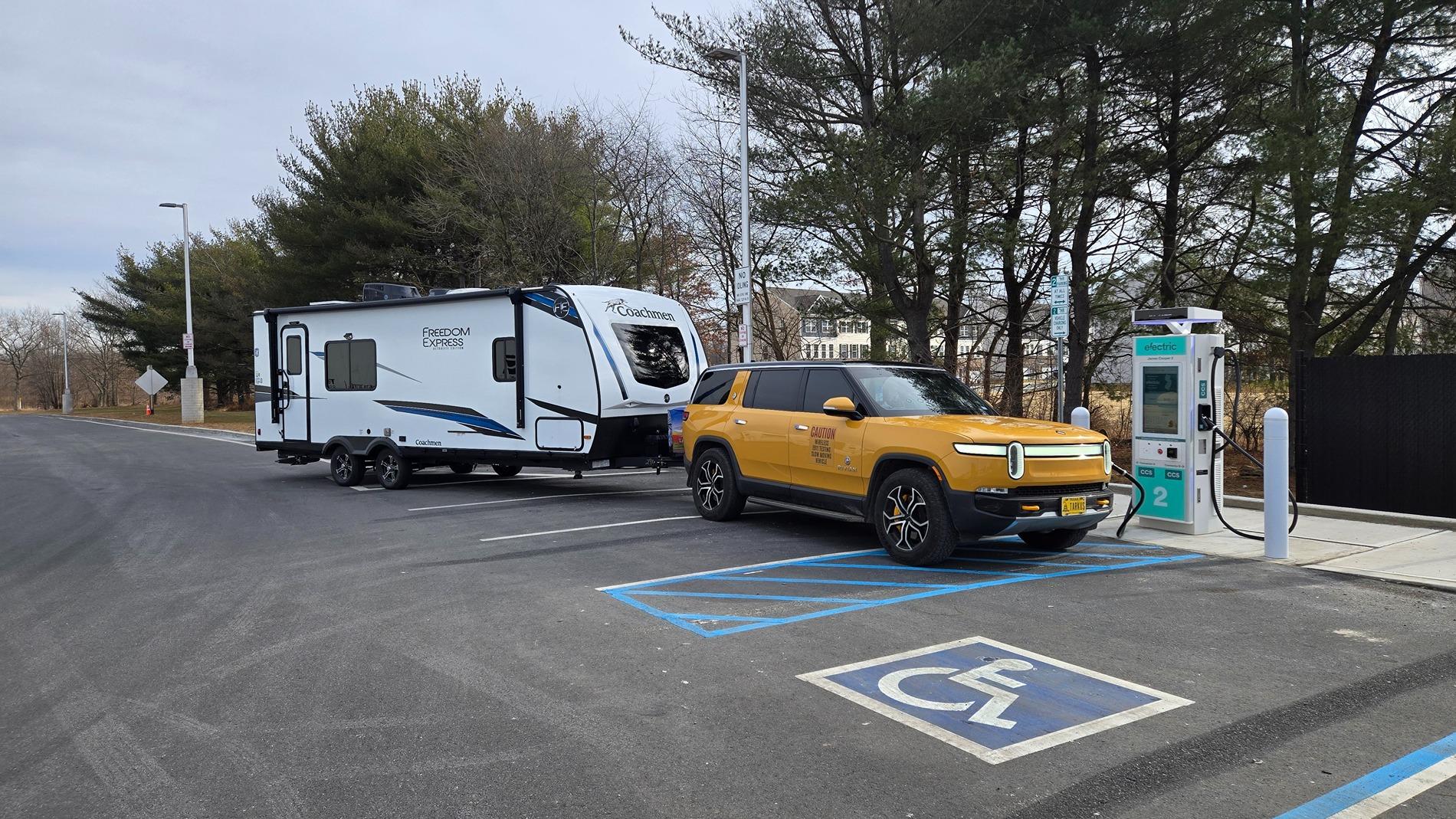

Sorry for the delay in checking posts here & Yes I have towed my 2024 7,000lb Travel Trailer & this Comma 3X works like a charm on every road (not just the very limited highways from Rivian's very limited database). I'm now testing the Lukas-Rivian-Sunny-Long branch & it is Awesome!
Rivian R1T R1S Comma AI / OpenPilot Autopilot Progress on R1! 20250208_095222

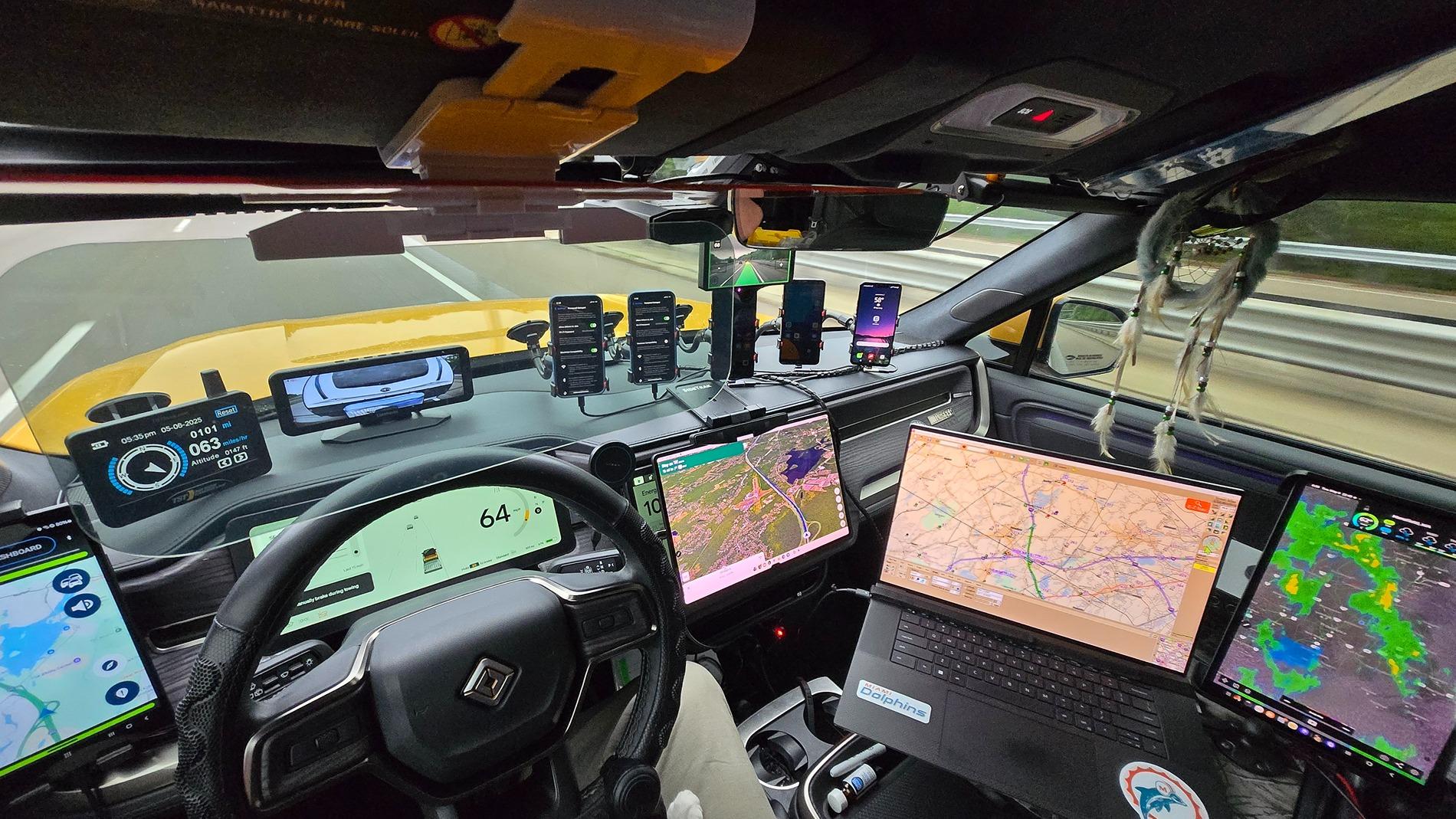

I "Officially" ran out of space for gadgets in my mobile office as well :cool:
Uh......Can you provide some context for those of us just reading through the discussion here. That is a LOT of devices in the cabin. What's the purpose?
Alex
Apr 24, 2025
North Carolina
2022 rivian r1t, 2026 model y performance, 1987 porsche 944S
I have the same setup actually. Fax machines is in the frunk. Gotta stay connected bro - get with the program.
