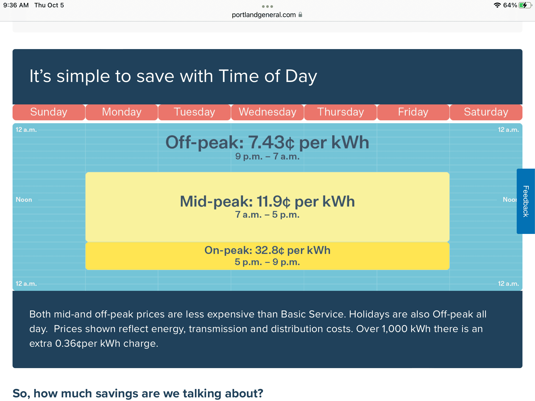

My PGE (not PG&E) rate is $0.17 for "mid-peak", $0.22 for peak, and $0.04 for off-peak overnight.
Yeah, to get my $0.28 "off-peak" rate (from 12am-3pm), I have to stomach a $0.59 peak rate from 4-9pm (and then $0.48 for the rest of the time).
