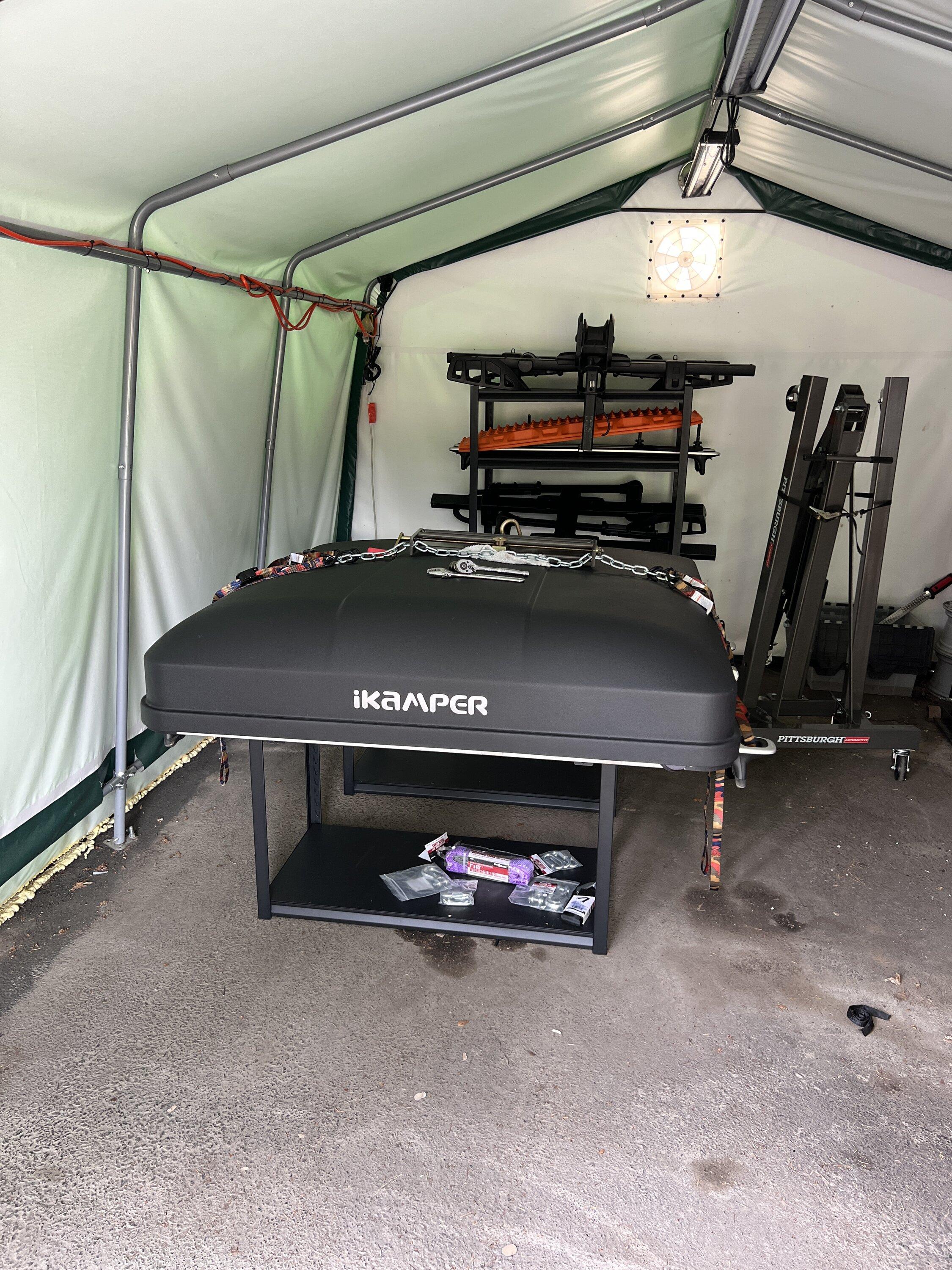

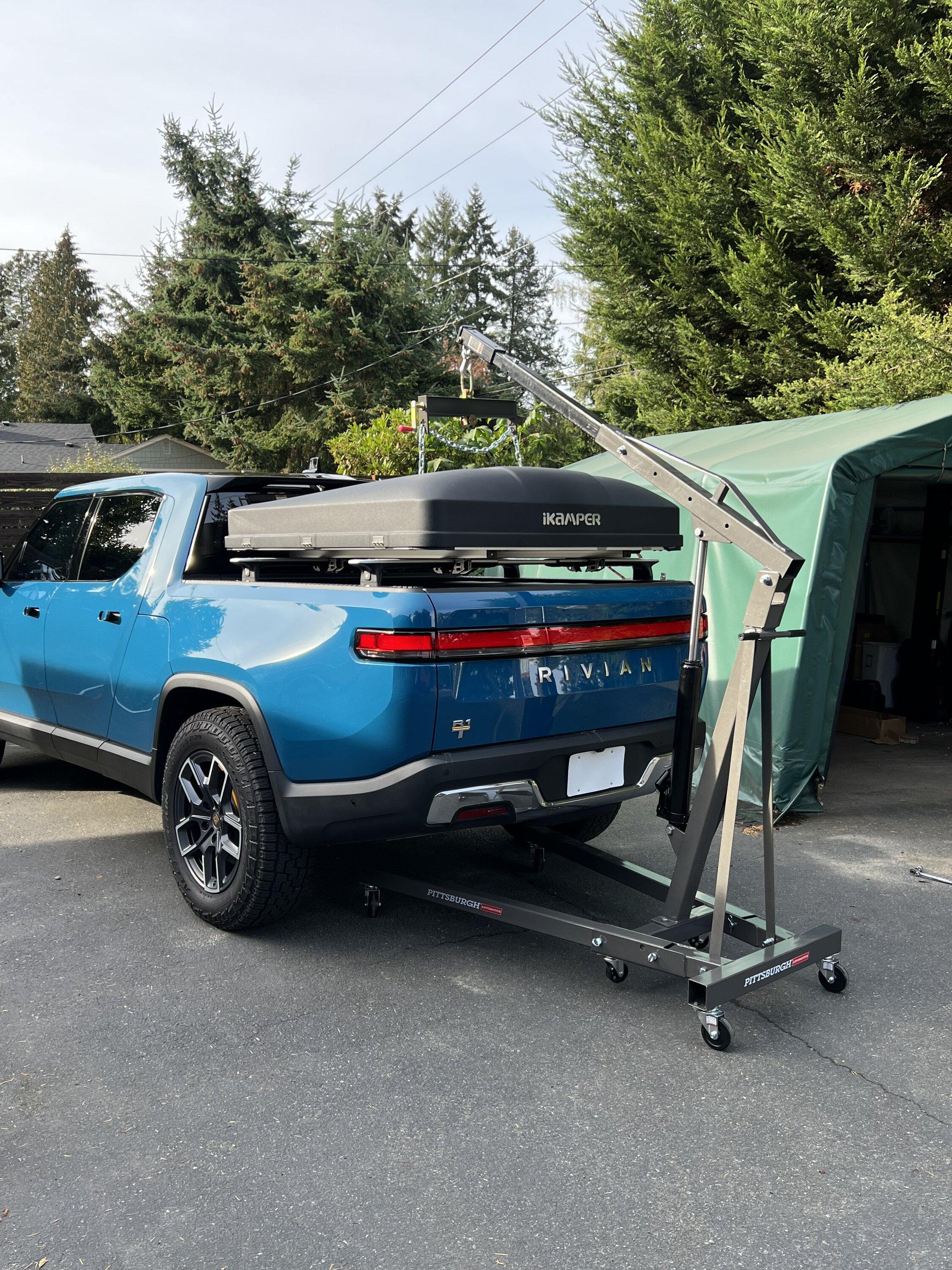

Ok, so I bit the bullet and went to harbor freight.
I bought these parts:
2 ton crane
Load leveler
Tie downs
Hitch extender
Hook
Quick Links

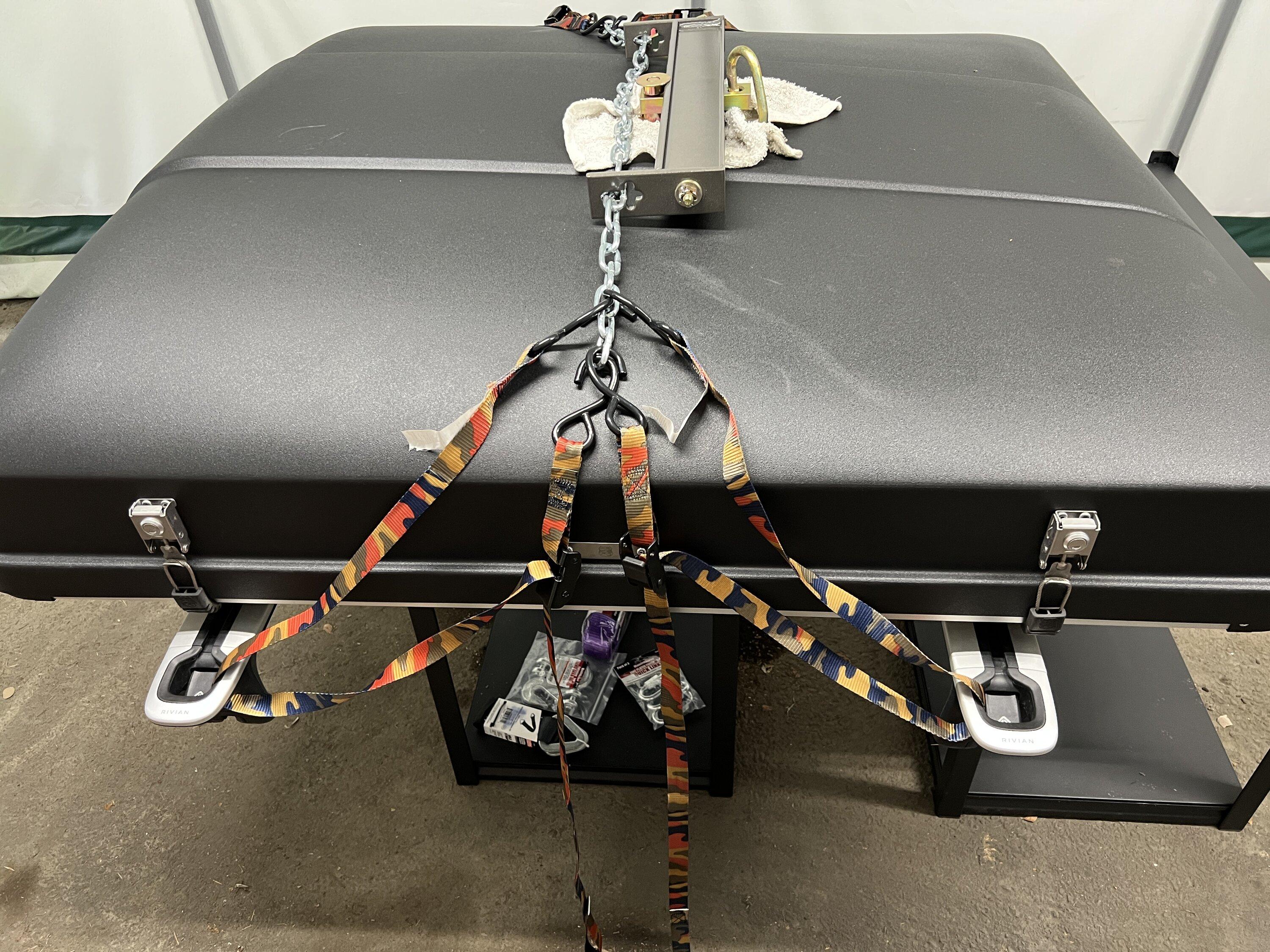

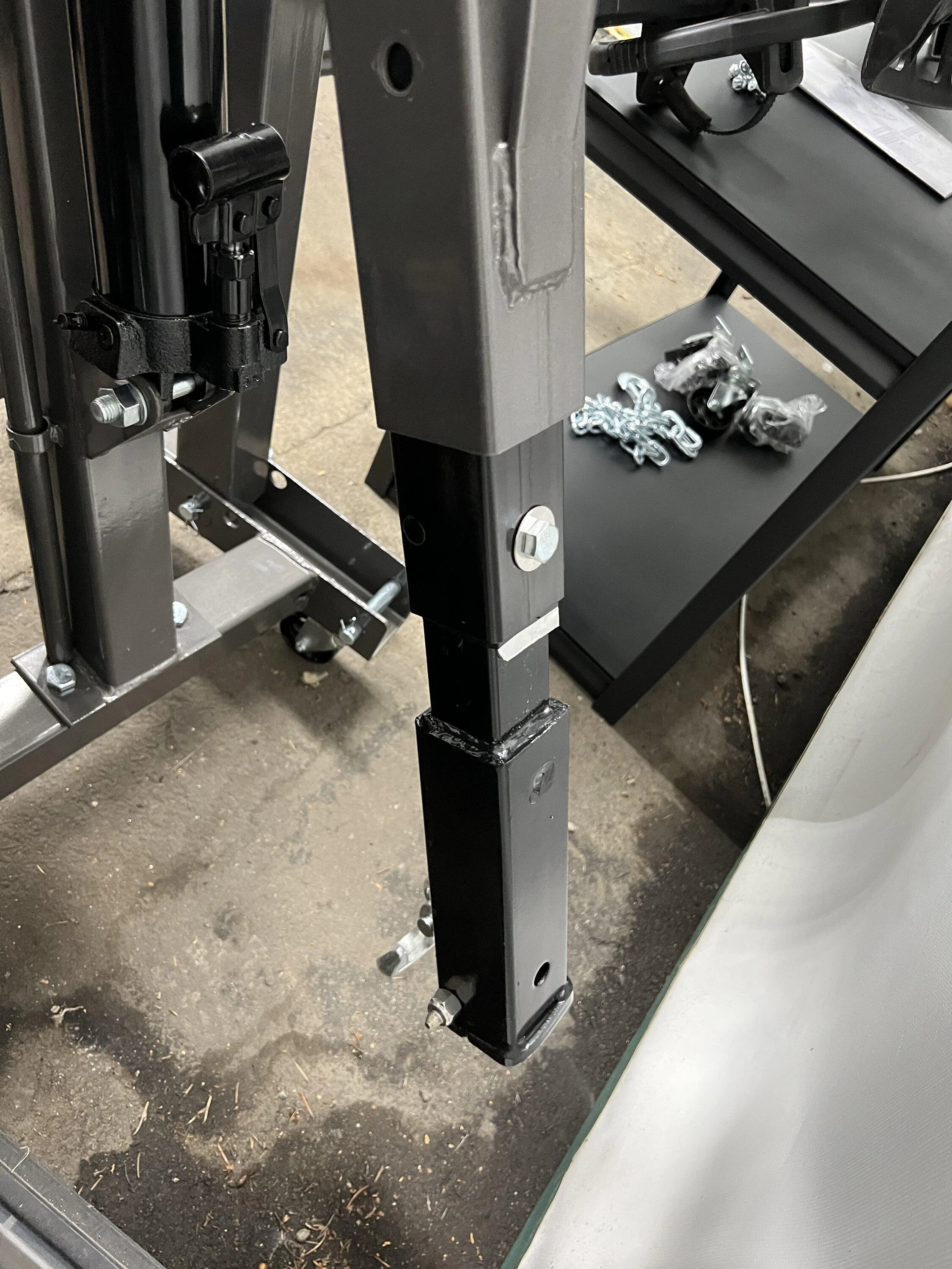

I added the hitch extender to the end of the boom, to get a bit more length.

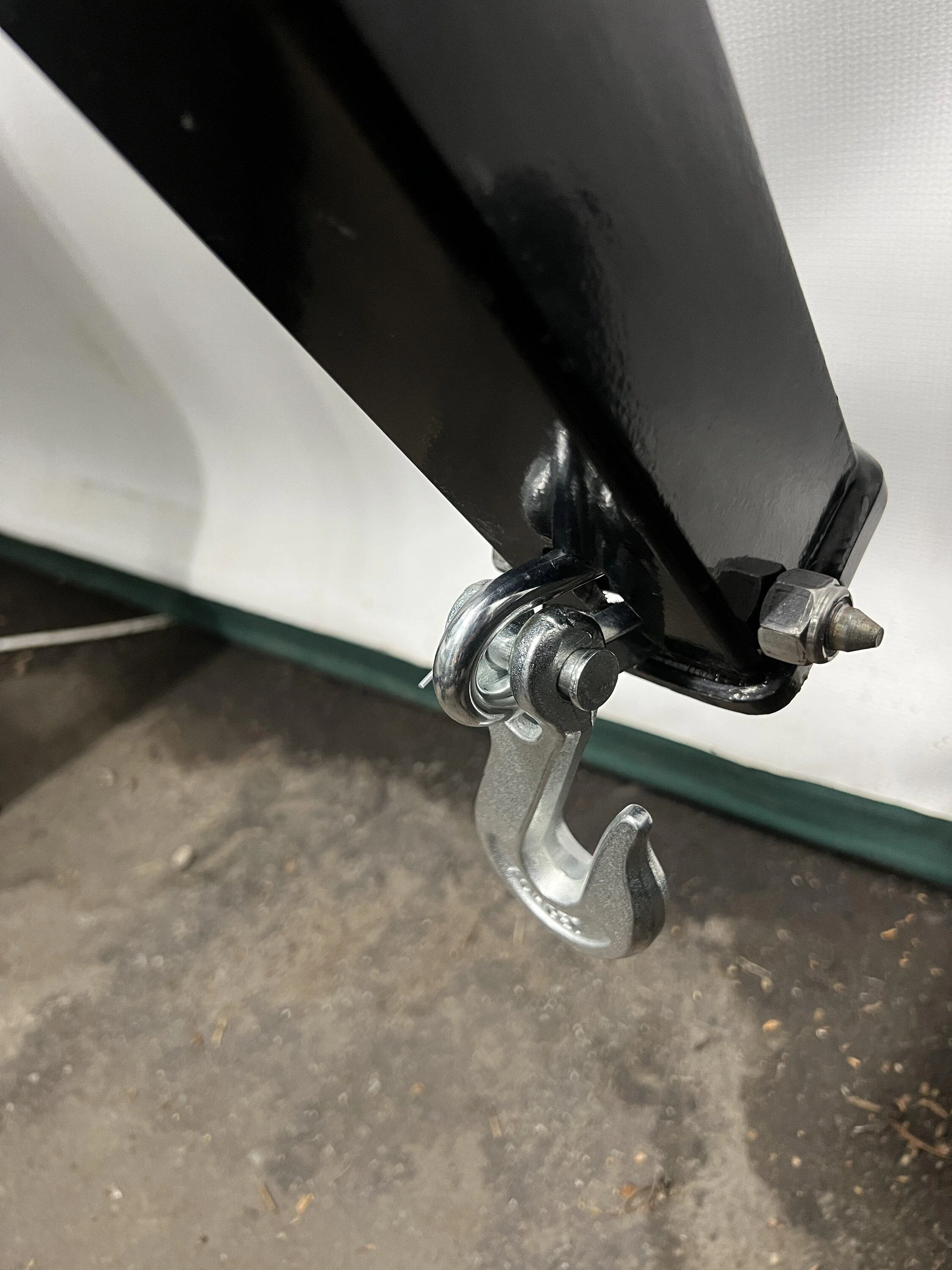

I drilled a 1/2" hole at the front end of the extender to put a bolt in for the quick link for the hook. This is the shortest possible way to have a hook, way shorter than the hook and chain that came with the crane.
Then I added the load leveler and attached the crossbars to that with some tie downs.
Worked like a charm! I forgot to take a pic with the tent dangling from the crane, but you get the idea.
