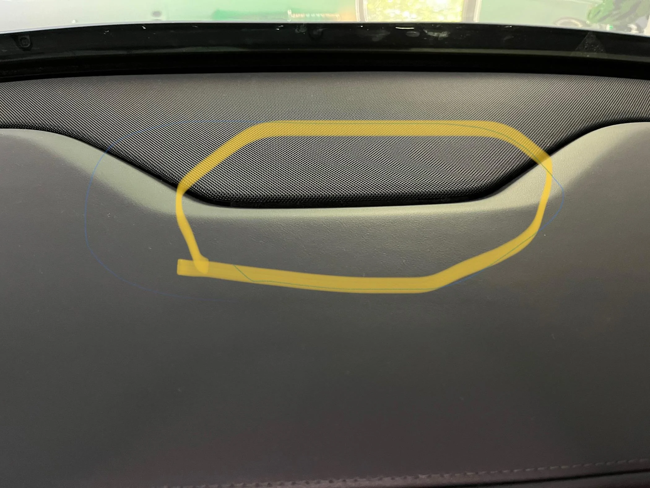

I fixed this with a 6 x 1/2 by 1/4 thick piece of felt. I used a plastic trim tool to gently raise the edge shown in the picture then slipped the felt into the gap where it is invisible but raised the grille enough to stop the rattling.
Pretty sure this is exactly or similar to what Rivian itself is doing and I would have done it myself but was encouraged to go directly to service for this.
Can you share where you purchased the felt and what color? Thanks!
