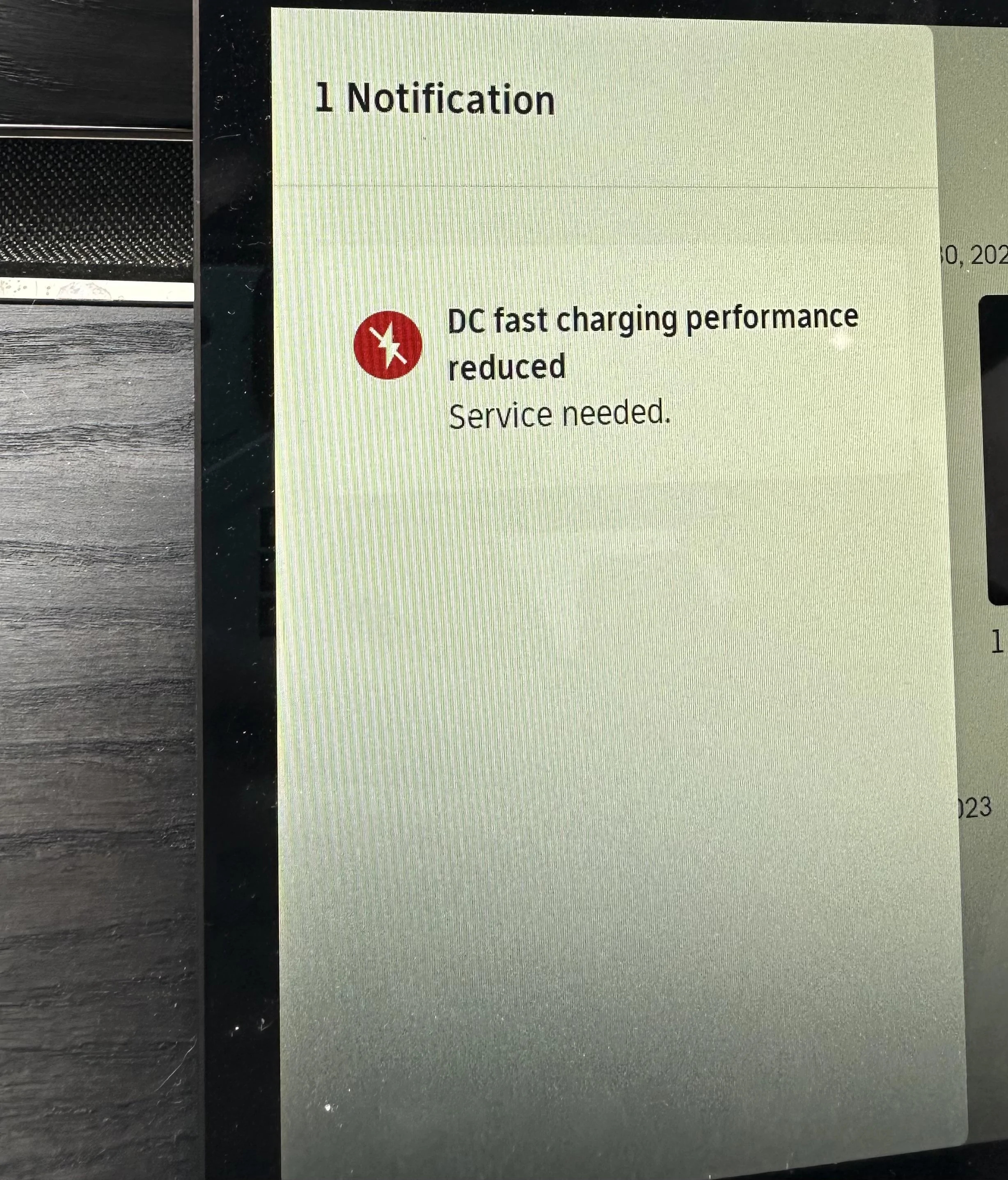

Has anyone else had this pop up recently? It comes on randomly on first start-up, but seems to go away on its own. Haven’t noticed any charging issues either

When I got this message Rivian ended up needing to replace the entire DC charging harness. Took a long time to get the parts in. Good luck.

I get this every time I drive now. Initially was occasional when I first started driving. . Took the truck to the SC. Replaced the wiring harness. Now I get error every time I drive at random times for a few seconds. Had the tech look at it when I had the recall fix at my house recently. Couldn't fix it, and he said there was no fix. Said it was related to two temp measurements being different by a certain amount. DC charging seems to work ok though.
The tech also mentioned Rivian had noticed my 12v batteries were low, and replaced them. not sure what to think about that.
