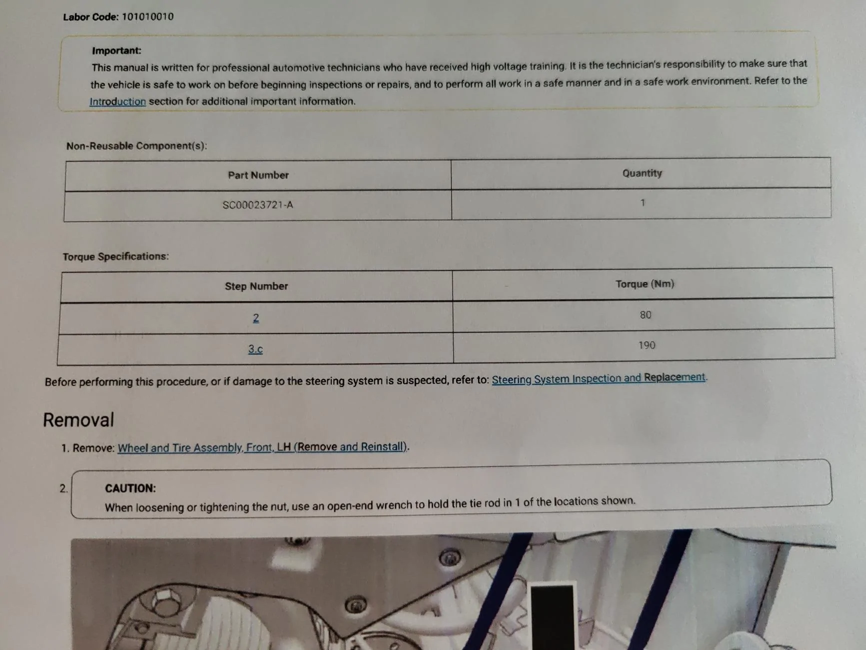

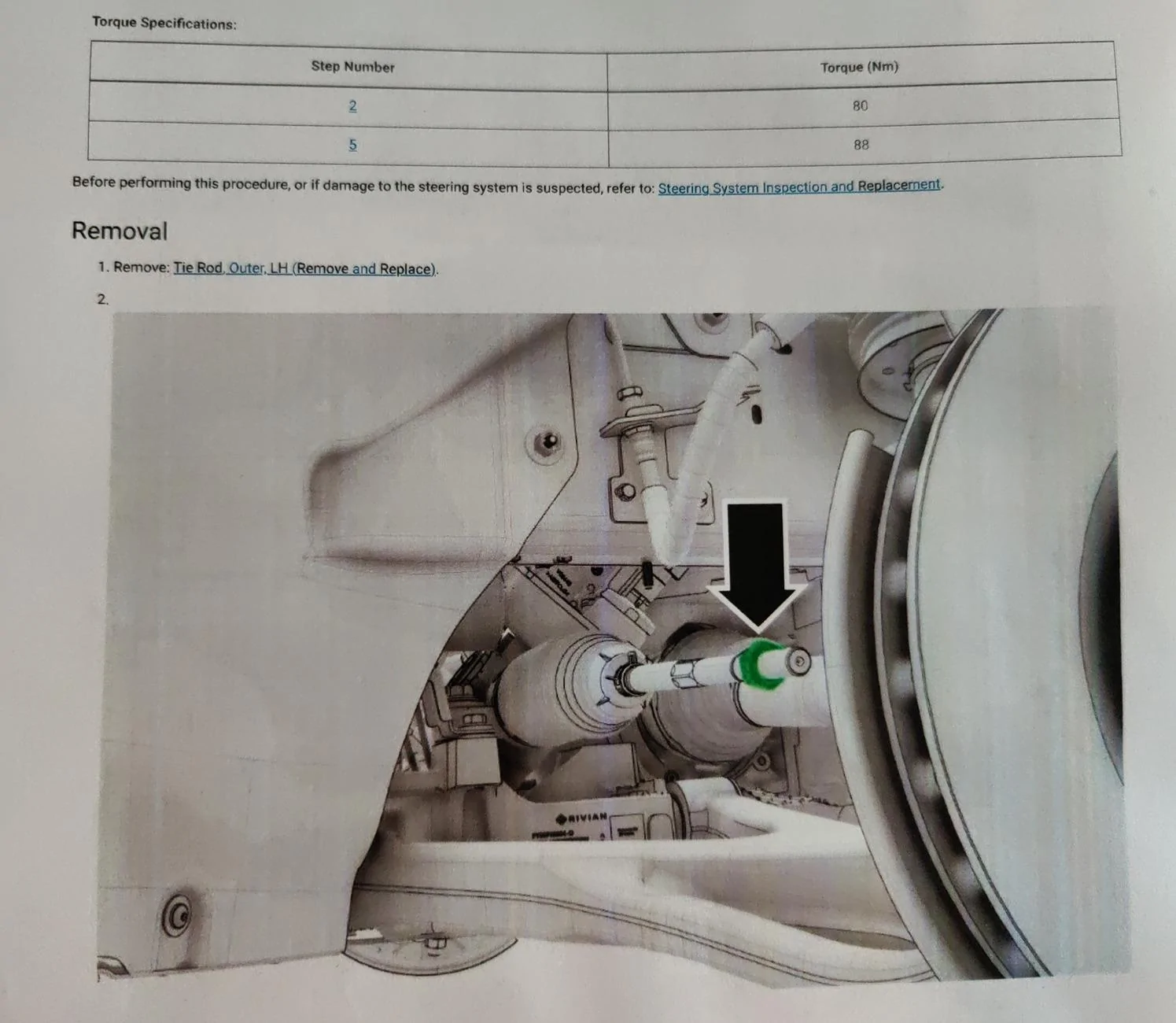

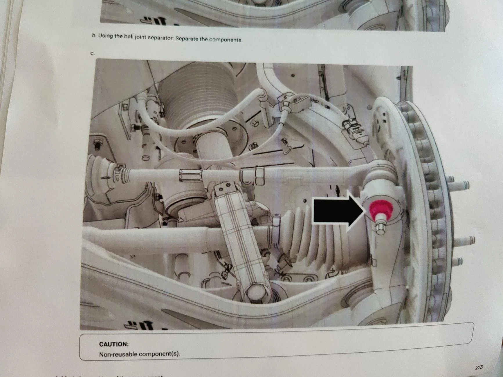

I got access to the service manual to get the torque specs to properly install the DHD sleeve.
Jam nut (DHD sleeve replaces this): 80Nm/59ft.lbs
Ball joint nut: 190Nm/140ft.lbs
