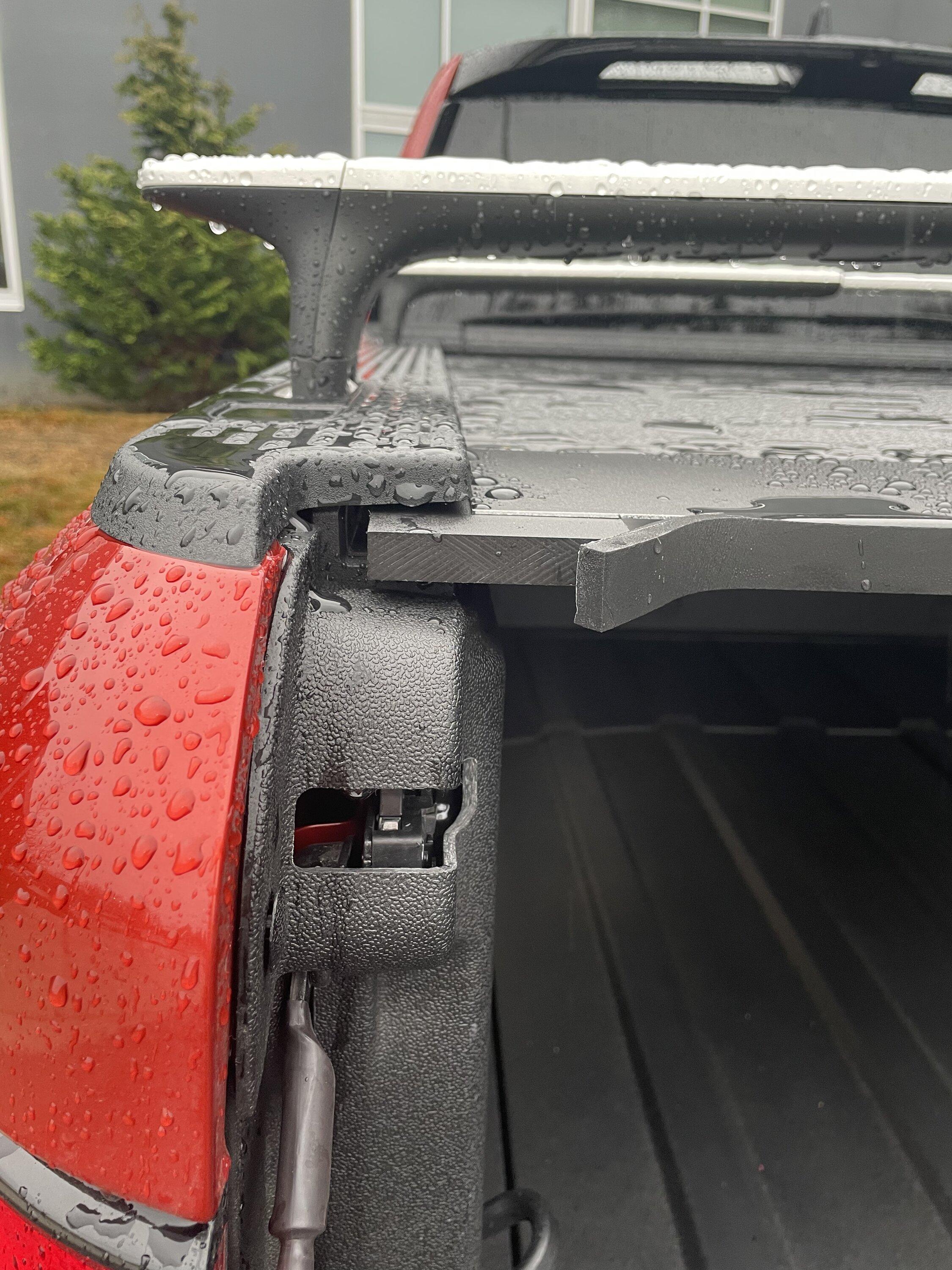

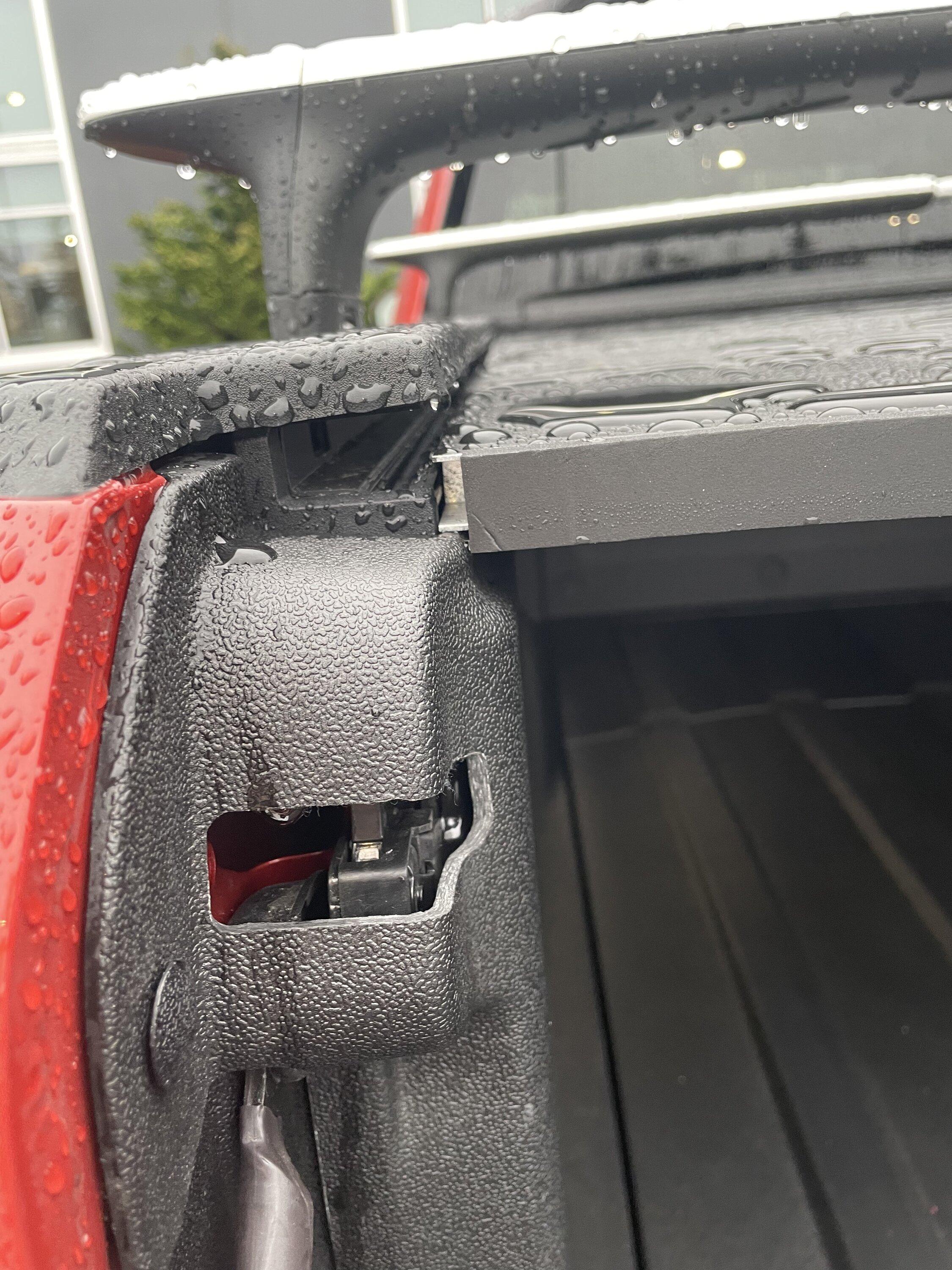

Sorry for the confusion. I am still working on the slides/end caps. For now the cover is sitting on the plastic ledge below the side slots (1st pic). The 2nd pic shows a piece of scrap HDPE that fits into the fence board and into the side slot. Hope this helps.

Did you consider using UHMW (further down the page on McMasster-Carr) for more strength and less friction?

UHMW is a better choice for the reasons you mention, albeit about 3X the cost. TBH, I had the HDPE left over from another project.
