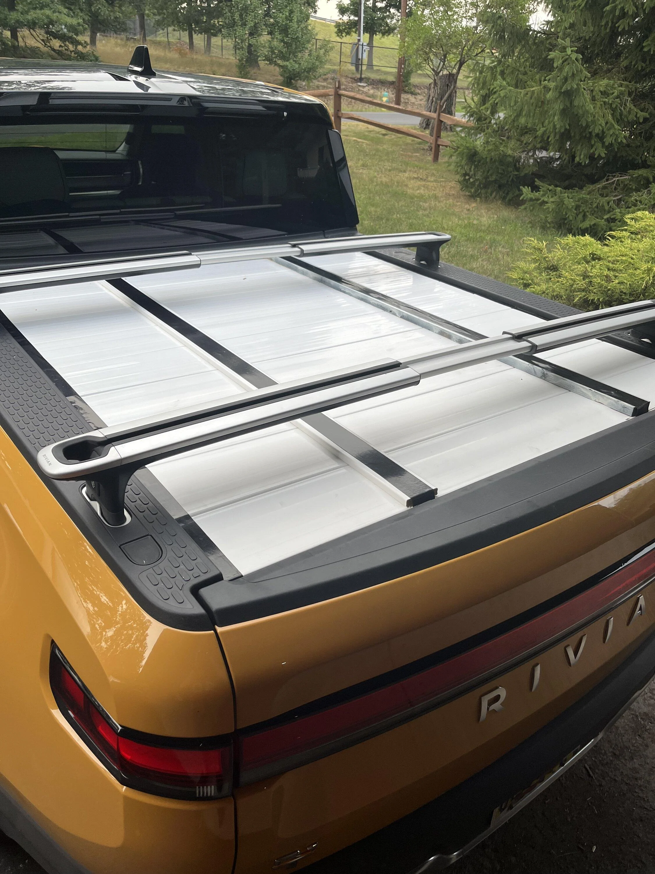

I received @Bf3's tonneau cover today. Impressively robust design. Heavier than I expected, but not excessively so. A few installation tips to anyone who follows...
  • The small piece goes in first, weatherstripping facing the cab. Try to get it seated evenly so that the final closing pushes it into place smoothly.
  • Make sure your next piece is the one with the hook piece of velcro. This will be the one you start attaching the "grab" length of velcro to.
  • Save your last piece to be the one with the remaining strip of weatherstripping. This will push up against the tailgate.
Even with a few mistakes in sequence I had it installed in about 10 minutes. You can have it fully unboxed and installed in less than 5 minutes if you take care of the tips above.
Bf3
Bill
Nov 12, 2022
171
492
Akron, OH
interrobang.store
Would it be helpful to label or number the pieces for a more straightforward first install? I could get some easily removable stickers or something.
Phatman113
Ryan
Feb 21, 2023
371
377
I accidentally put my velcro slightly angled, but now it helps me keep my plates in order... ;)
obfuscurity
Jason
Oct 29, 2022
328
483
Westminster, MD
Rivian R1T, Tesla Model 3, Audi SQ5
I think it'd be helpful to include the tips in your printout, but I'm not sure stickers are really needed.
the_mace
Apr 8, 2022
414
343
Boston, MA
Tesla Model S75D, Ford F350 Diesel, Mercedes GLC30
CTO
I went with the EV Sportline cover early on but not liking the sagging it does with wind/rain. The rollup is nice since no extra storage is needed but its hard to roll under the bars. Thinking of switching. I like the concept of no velcro Rivian has on their cover for the interlocking panels, just not sure when it would be available and i'd want to see reviews etc.
Anyone have pictures of this one with heavy rain on it?
How much does the whole set weigh when removed? I need to make sure my wife can move it.
Also saw the question above about a cooler and partial removal, is it all or nothing for removing it? We do partial unrolls of the EV Sportline one now when we need to fit hay/etc.
