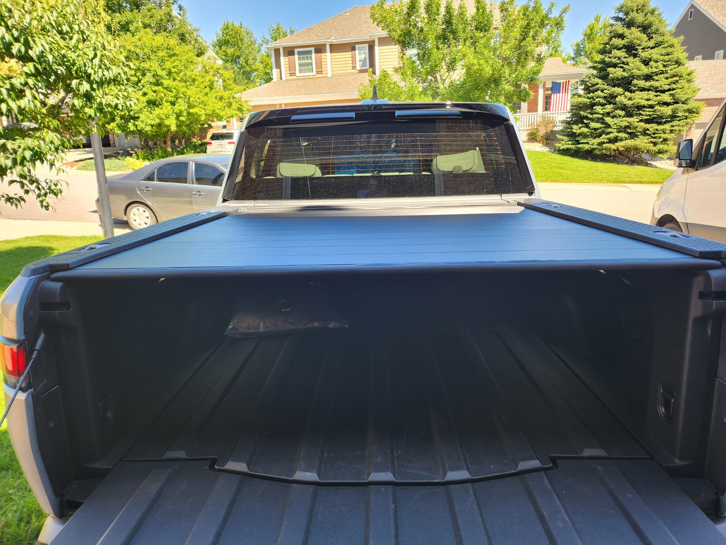

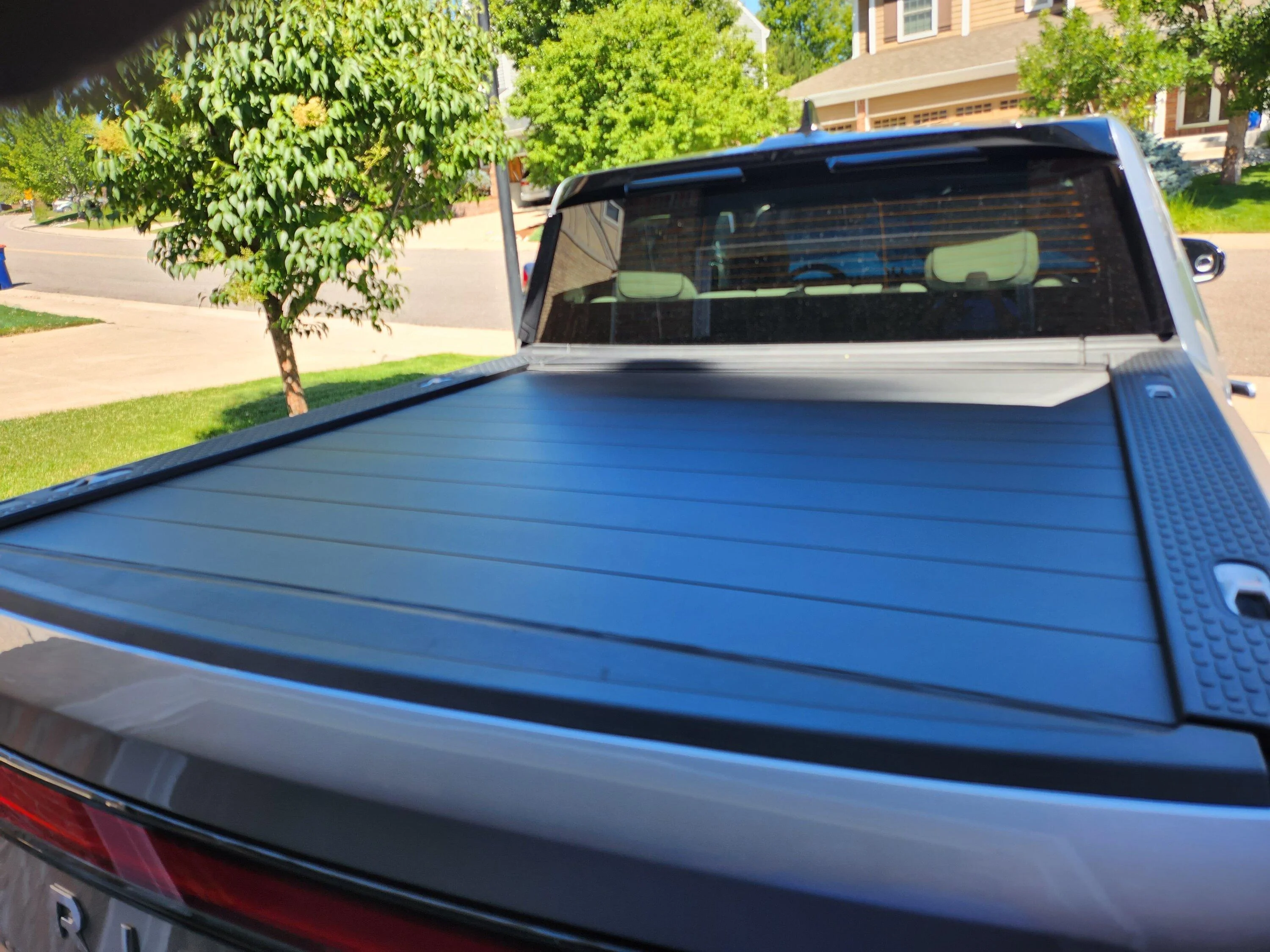

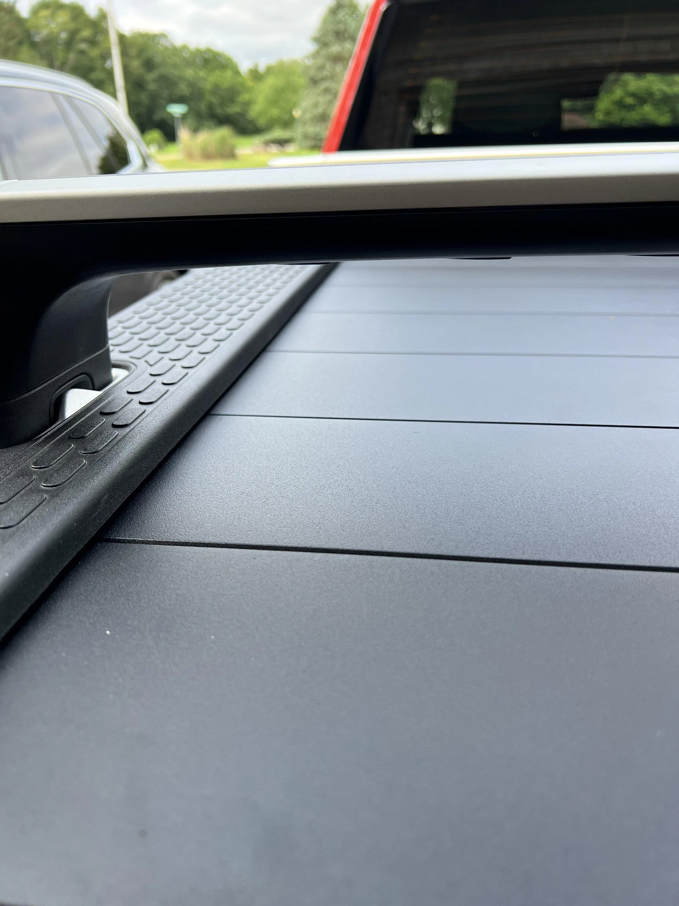

Yet another @Bf3 style tonneau.
I decided to put together my own panels but rely on Bf3 for the beautifully CNC machined sliders (https://interrobang.store/products/uhmw-slide-pieces-for-diy-tonneau) that made the build much easier. The sliders fit nice and tight with no need for glue.
I used a chop saw with an aluminum blade to cut the boards to 52.25" (since the sliders add 2x1.25") for a total of 54.75" width. The aluminum blade doesn't seem to be necessary per other posts but I had one laying around and the end result was clean cuts with no need for filing. I am glad I dry fitted the first joined panel since my railing seems to narrow by 1/4" as I get closer to the cabin, so I ended up adjusting the next set of panels for that.
Everything fits great with the parts list mentioned in this thread by @Phatman113 (https://www.rivianforums.com/forum/threads/diy-temporary-tonneau-bed-cover.10300/page-17#post-302660), as well as suggestions on the tools to use by @Phatman113 and @foxerson.
I ripped the last board to 4 inches after installing the other double boards and remeasuring again just to make sure my bed wasn't off. I ripped the final board with my circular saw with a metal blade and help of a jig () and clamps.
I used a mallet to install the weather stripping at the 2 ends and didn't need to pry them but had to go very slowly.

Nicely done! Looks awesome.

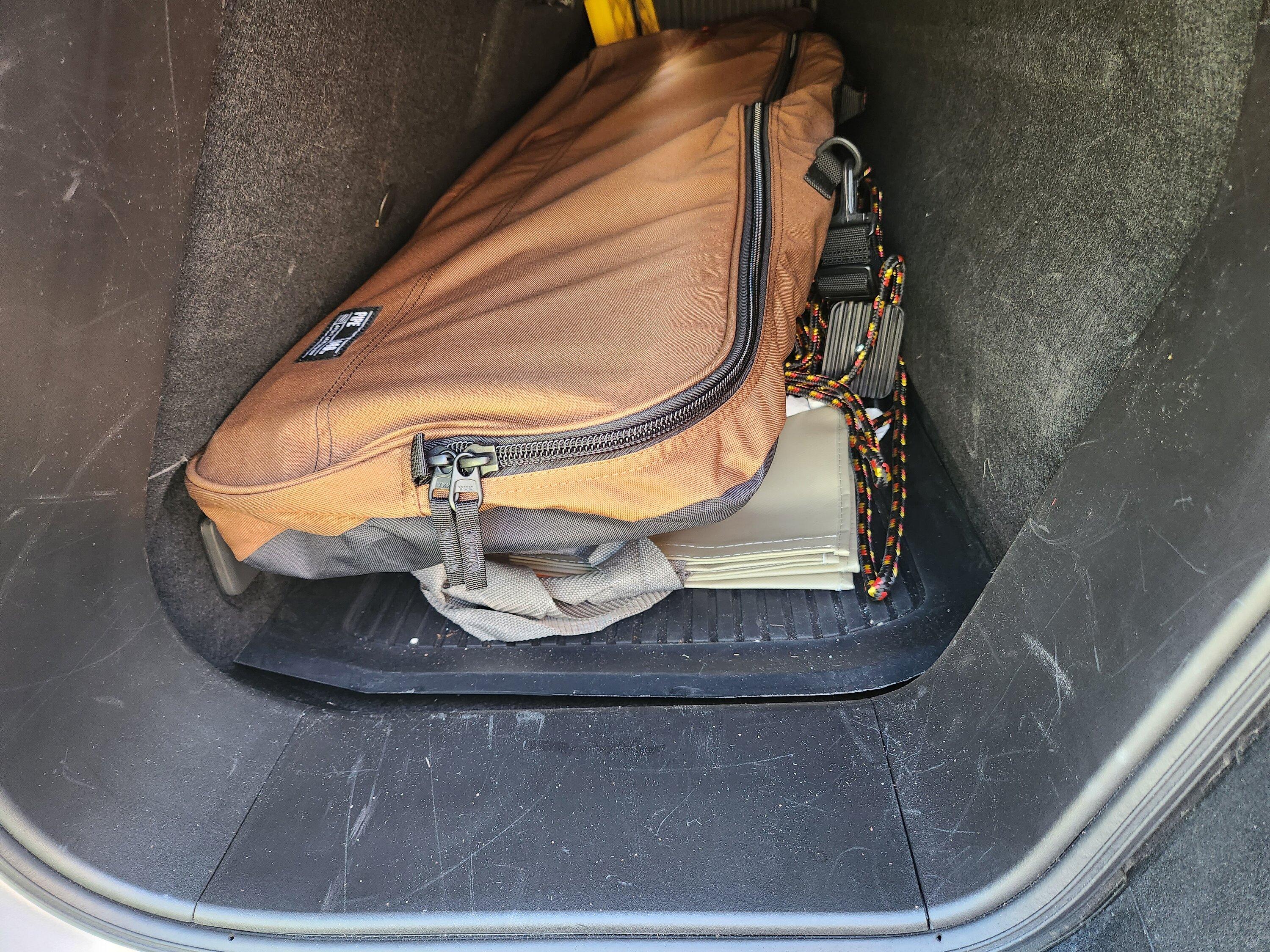

Where'd you get the bag? I still use the velcro wrap arounds, but boy, a bag looks much handier!
...for those that have went with the @Bf3 design, are you pulling out the cab-side piece when you take off the tonneau? I'm tempted to just leave that one in place.
I take all mine together, using the velcro to pull it all out and stack on the tailgate. Then it just sits in the tunnel, though the majority of the time it's installed.
