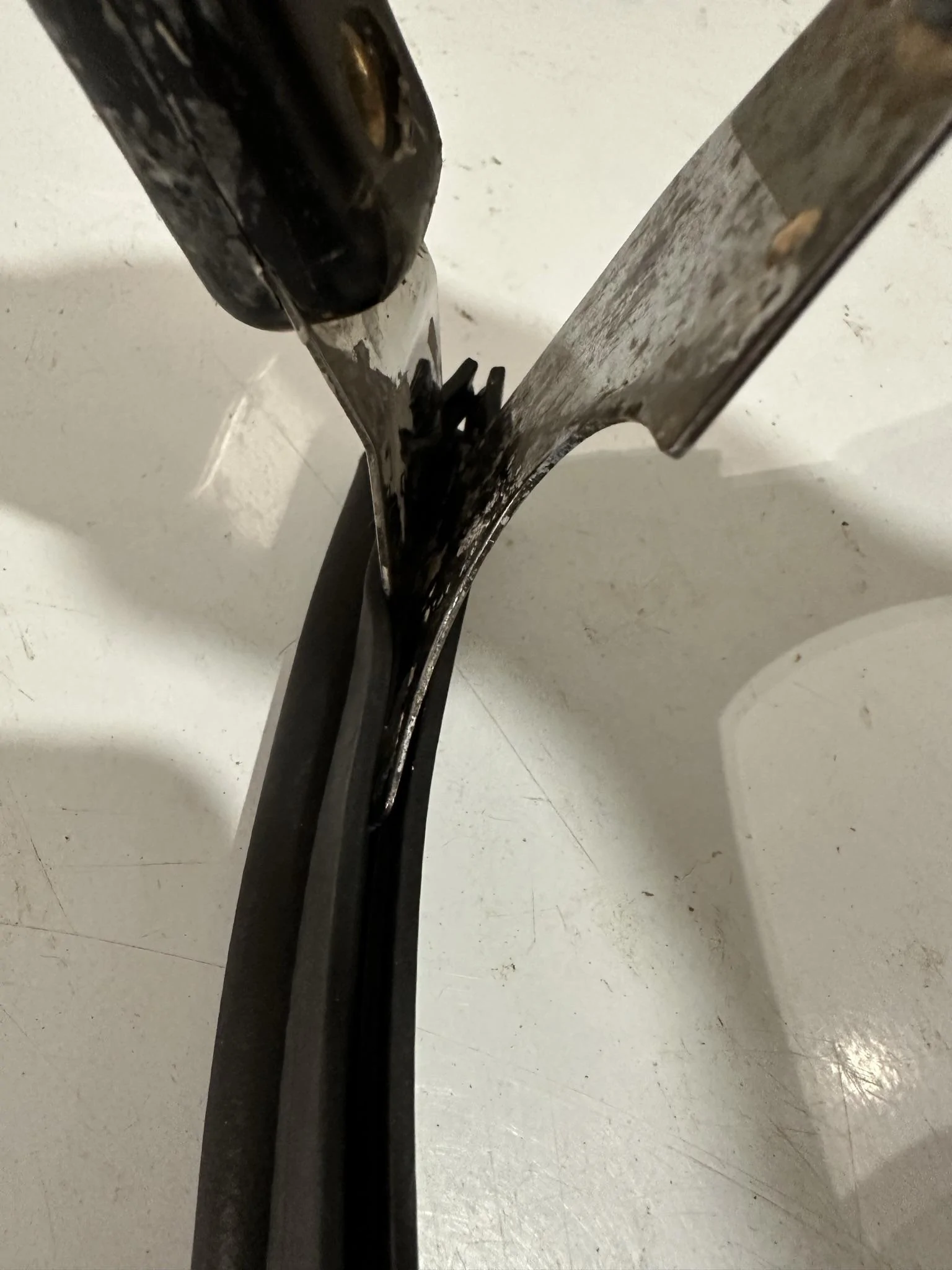

Regarding the rubber weatherstripping at the cab, if you used this one https://www.amazon.com/gp/product/B0B4S1C6NT/ref=ox_sc_saved_title_5?smid=A3FOSOQ6FBSYGB&psc=1, can't you just bend the metal teeth a bit? I have done that when installing the same type of strip on one of my cars when I needed to adjust for the edge thickness but I am not sure if it would also apply to these panels.
Yep, that's the stuff. I made a halfhearted effort to bend the metal outwards but found that it is pretty stiff. Maybe I just need to try harder. ?

I have a similar issue with the weather stripping and the narrow panel
I've got 4 little spots where it's bent, but it's REALLY stiff to bend and difficult to get it to retain the bent size. I'll probably just clean the channel it sits in (it's gotten really dirty in there from some offroading) and then put in a bunch of silicon sealant and then jam the weatherstrippping back in.

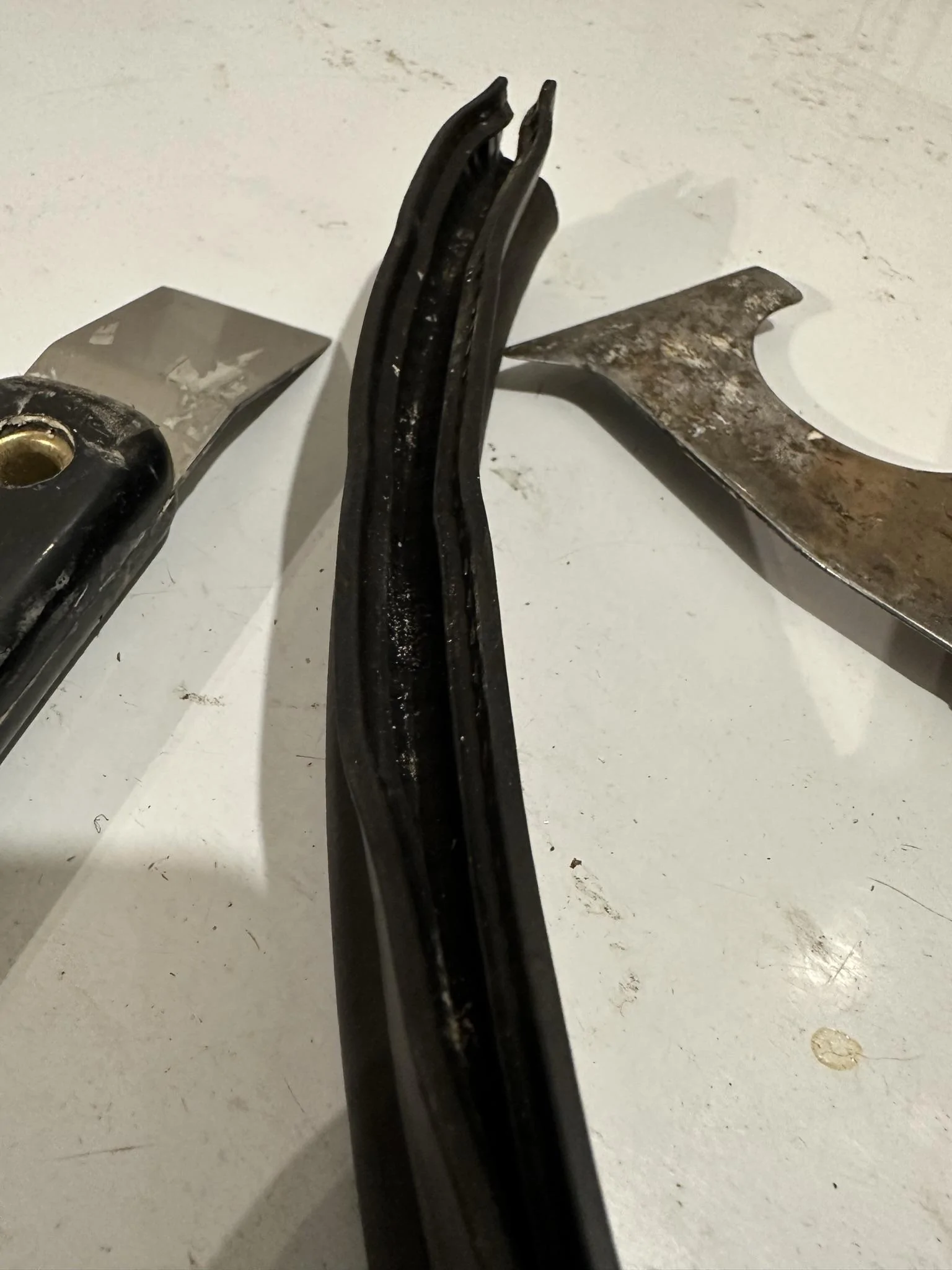

I made a more concerted effort and was able to bend the metal outwards using a painters 5-in-1 tool and glazing tool. Basically, a pair of rigid putty knives. Now it fits more snugly in the gap of the last panel.
