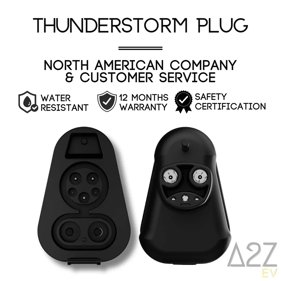

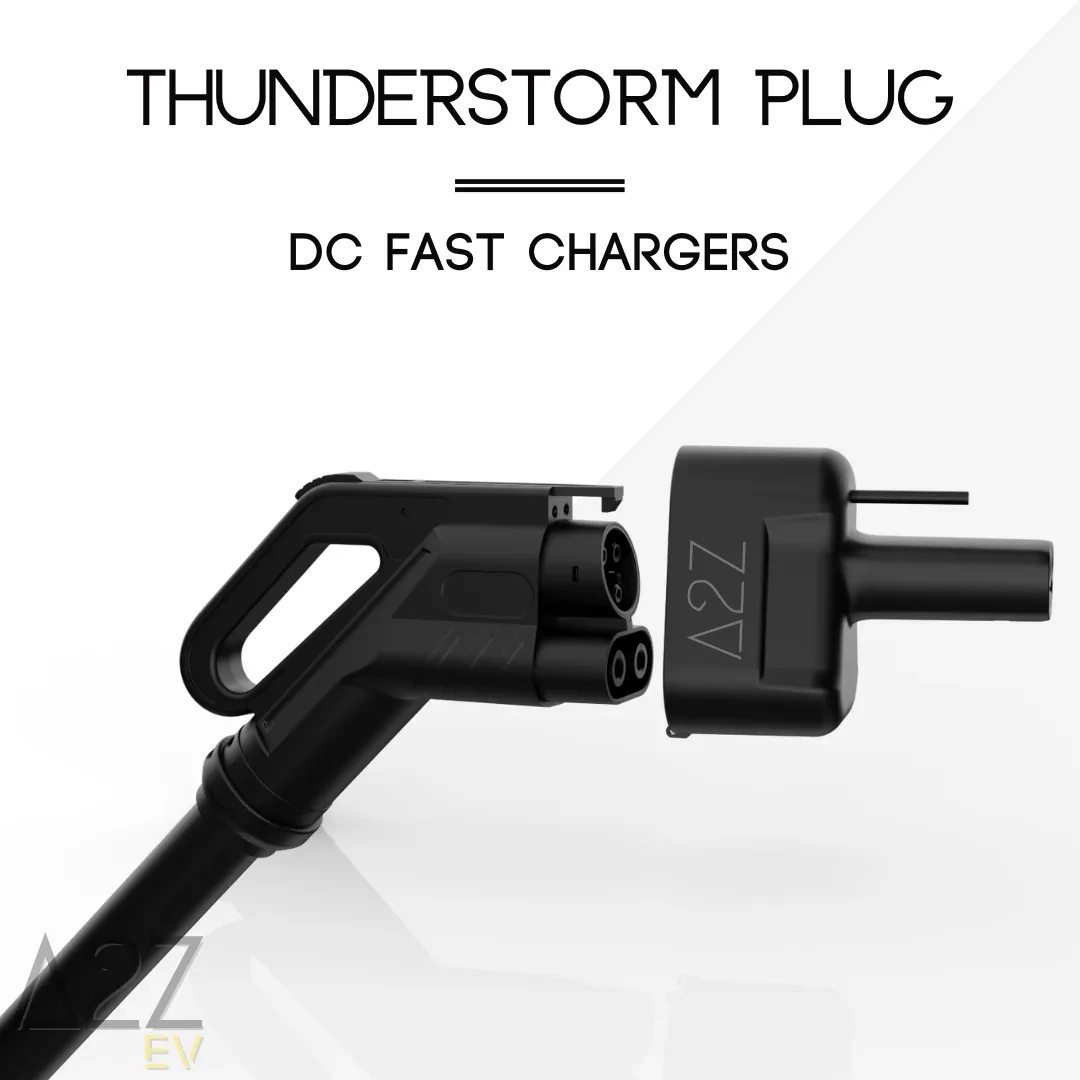

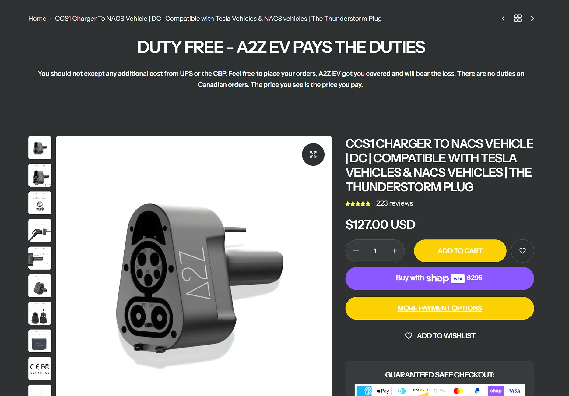

2026 NACS vehicles can order the CCS1 to NACS adapter for their vehicles to get access to even more chargers.
A2Z EV is covering the duties right now as mentioned on the home page.
Flash Sale and Free shipping is still active.
Click the link to chose your below products and stack the temporary code "FLASHSALE" to save 15%.
2026 model vehicles: A2Z EV adapter to go from CCS1 to NACS. Get access to even more chargers with this adapter and the CCS network.
CCS1 Charger To NACS Vehicle | DC | Compatible with Tesla Vehicles & NACS vehicles | The Thunderstorm Plug
