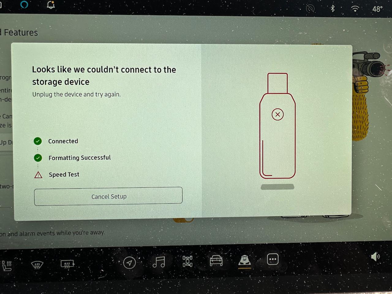

I've tried the following three drives, and setup fails each time.
https://www.amazon.com/gp/product/B09WB2NL8W?th=1
https://www.amazon.com/gp/product/B08GV4YYV7/ref=ppx_yo_dt_b_search_asin_title?ie=UTF8&th=1
https://www.amazon.com/gp/product/B0874XN4D8/ref=ppx_yo_dt_b_search_asin_title?ie=UTF8&th=1
Makes it past connecting and formatting, but then give an error after the speed test. Any ideas?
For others still running into this issue a soft reset helped me get past the speed test error.
