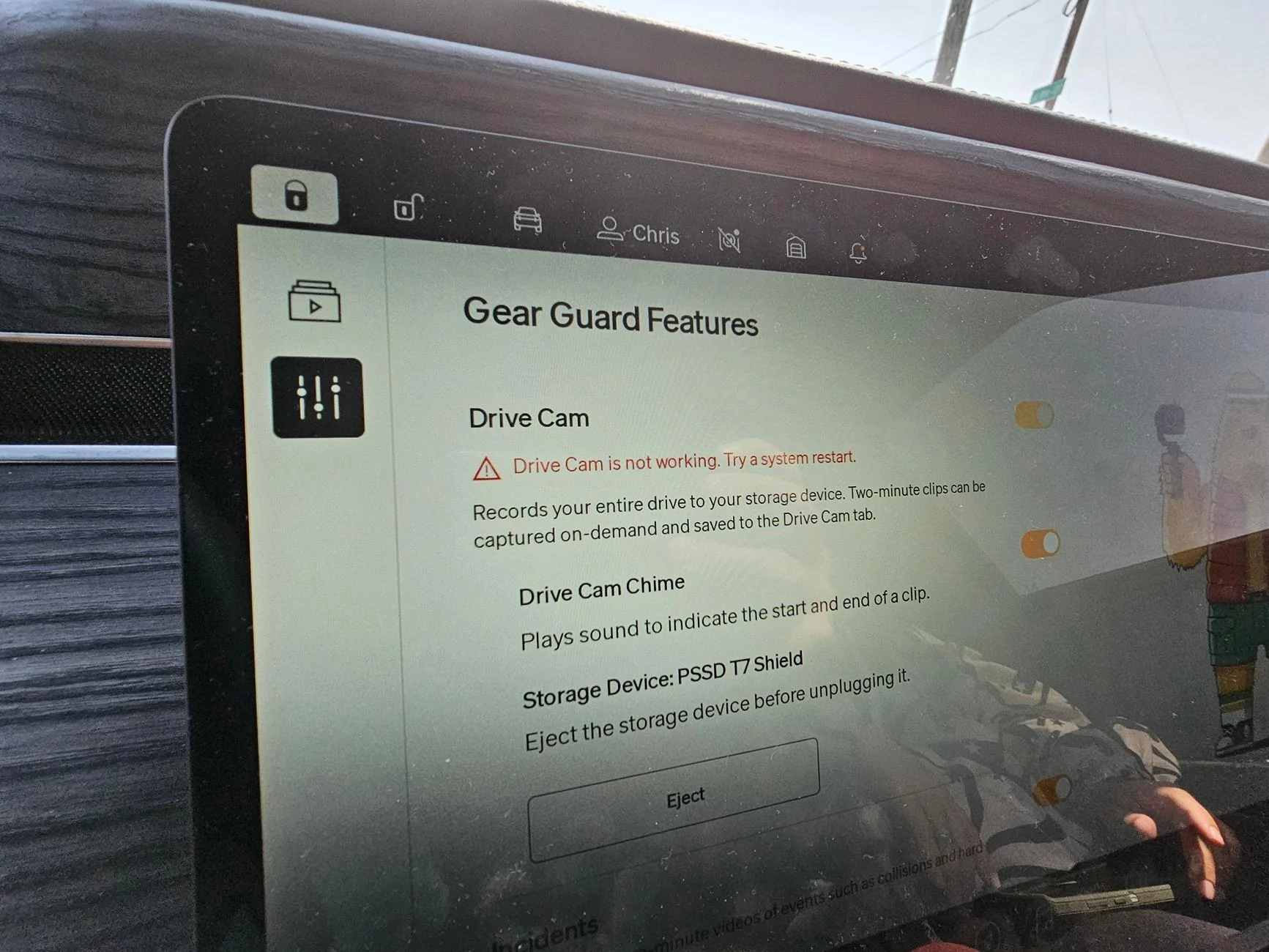

Mine has worked for a year. Same issue since last update. I know its not working when camera icon up top next to chris has a line through it. Both times a infotainment reset has fixed it and never touched or unplugged or formatted the drive. 0 warnings or issues about drive speed. When i go into gear guard it tells me to try a restart.

I emailed rivian my info and issue and screen shot as well. Hopefully someone will look at it and maybe this gets fixed in an update. If it's my storage I don't mind replacing it, but I really think it's vehicle and not the storage.

Mine lasted about a week and stopped working again. I am on 2 infotainment resets to since this last update. This has to be a bug.

Mobile service out today. He was able to test all of the electronics in the vehicle (they're testing fine) and was able to independently test the performance of my USB-C drives (both are great).
He's pretty convinced it's a software bug. I had received the 2024.19.04 (I think--I can't see what it was anymore that the truck is updating) with everyone else, but he's pushing 2024.19.06 to see if it makes any difference. Regardless, he'll be reporting back to Engineering with his findings.
So, HOPEFULLY there's at least some more awareness that this is a prevalent issue. That said, I was cautioned that it might be until the next big software release for a full resolution if it is, in fact, a software bug.
