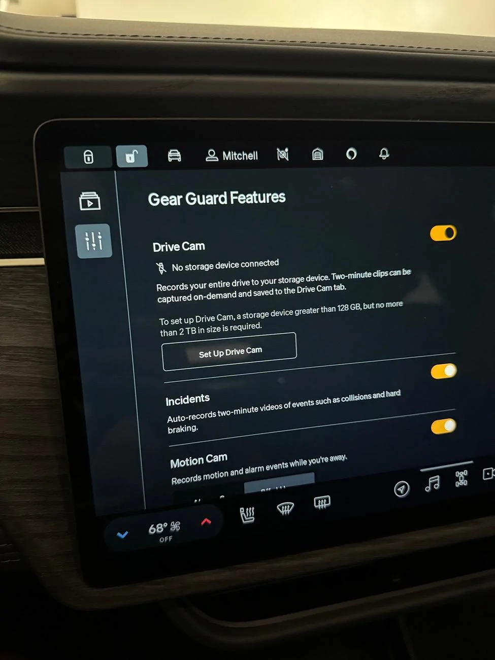

Gen 2 R1S here. I’ve had an issue with my dash cam ever since delivery only July 6. The car shows the drive as not being connected. Every time it happens, I do a soft reset and it goes away for a few days and then resurfaces. When it works, it works fine and everything is seamless.
I’m using a Samsung T7 SSD, which is a recommended drive by the community I believe and works great on my Tesla.
I have a service appointment in Sept for this and a few other things. But hoping this is something they can resolve with a software fix quickly.

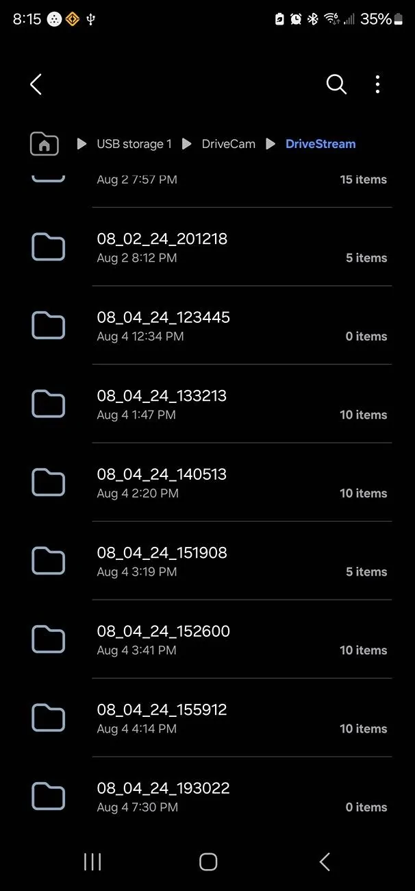

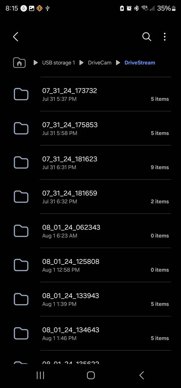

Has anyone who had success with a reset or whatever appears to have worked actually watched a recording? I didn't notice mine wasn't working because I didn't recognize the icon. Eventually, I got a notification about it and checked these hot sheets for a solution. Flasher reset seemed to fix it since the icon no longer has a slash through it. Today, I saw a car with a completely caved in windshield and wanted to show the fam but the folder created for that 40 minute drive has no files. The rest of the day is recorded and several previous drives as well. However, several folders contain 0 files. I reckon a sc appointment could help raise awareness if nothing else.
