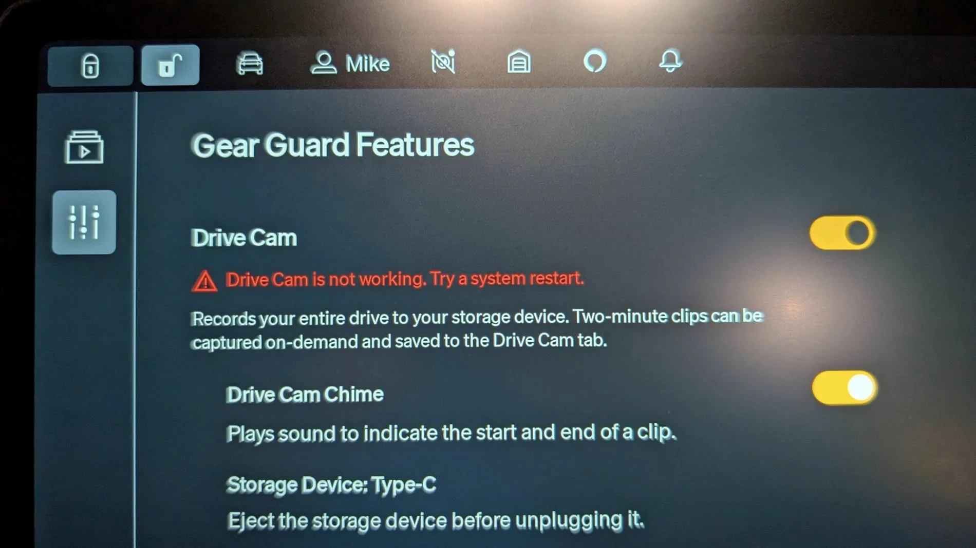

Drivecam requiring Infotainment reset since updating

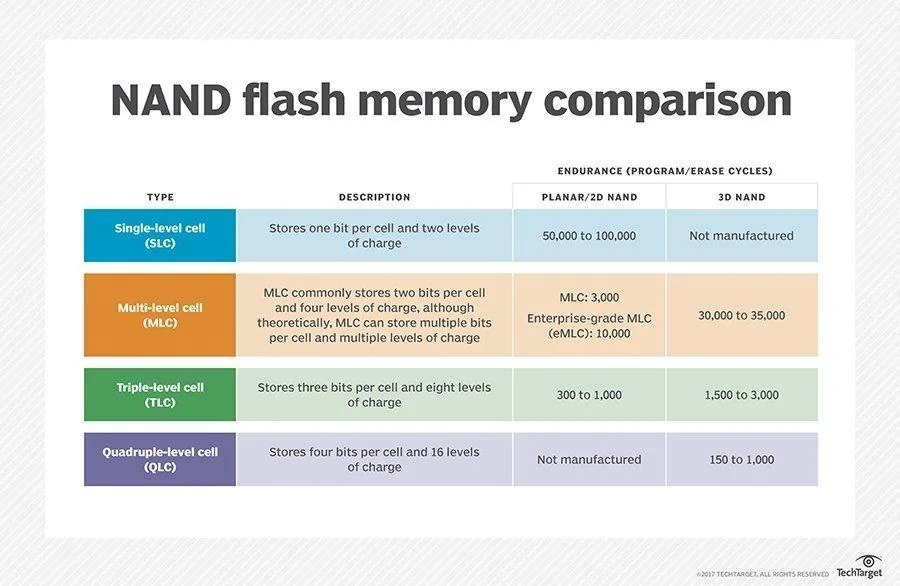

Dumdum MechE here, but can you explain why?
They're both NAND Flash memory, so why would one have higher read/write cycles than the other? What is the 'wear mechanism?' And what are we talking here? 100s vs 1000s? or 1000s vs 10,000s? Or 100,000 vs 1,000,000?

Not all NAND flash created equally.
Rivian R1T R1S Drivecam requiring Infotainment reset since updating IMG_0419
if you can find endurance spec SLC flash in a USB stick, have at it.

Same issue since the update. Info reset resolves it for a couple days....
Frustrating but I expect it to be corrected in the next software update.

reset fixed mine. then it came back a few days later. reset again fixed it. its been a day so we'll see.

Same thing since the last software update. Had to reset the car twice to get the drive cam to work. Hope this is fixed in the next update.

Booo. Got me today, as well. ?
Rivian R1T R1S Drivecam requiring Infotainment reset since updating 1721877022970-7u
Seems to be working again after an infotainment reset. We'll see for how long...
Experience is the best teacher. Best of luck.
Counterpoint: I don't think you're finding endurance level NAND in most micro SD cards either.
And from what I have seen, no one is publishing what type of flash they're using. At all. (Maybe I should see if I can find full spec sheets on the manufacturers' websites...)
Hell, I can't even find anyone talking about cycles (some appear to advertise minimum expected cycles, but that's all I've seen).
I think we're splitting hairs. I'd be willing to bet 99% of any flash memory is going to be perfectly fine for our application. Experience tells me the limiting factors are likely moreso thermal /environmental (sitting in a very hot/very cold vehicle for extended periods and incurring thermal shock when you get in to kick in the heat/AC while it's meant to perform). That said, even then, most will be perfectly fine, because they should have all been tested for this.
It feels akin to people who insist they need ECC memory in the event you get a bit flip due to a rogue neutron...

Perhaps you’re right. I posted my original replies based on my experience w Tesla Dashcam for the same application since 2018, having several usb sticks fail on me after a few months. Maybe it was just 2018 tech, or a series of bad sticks. After switching to endurance microSD cards, been going for 5+ years without failures. Maybe your experience differs. Just trying to help from my personal experience and understanding, so it is not splitting hairs for me as I will never go back, but to each their own

Same thing here. Working fine for a year but get this message after the last update.
