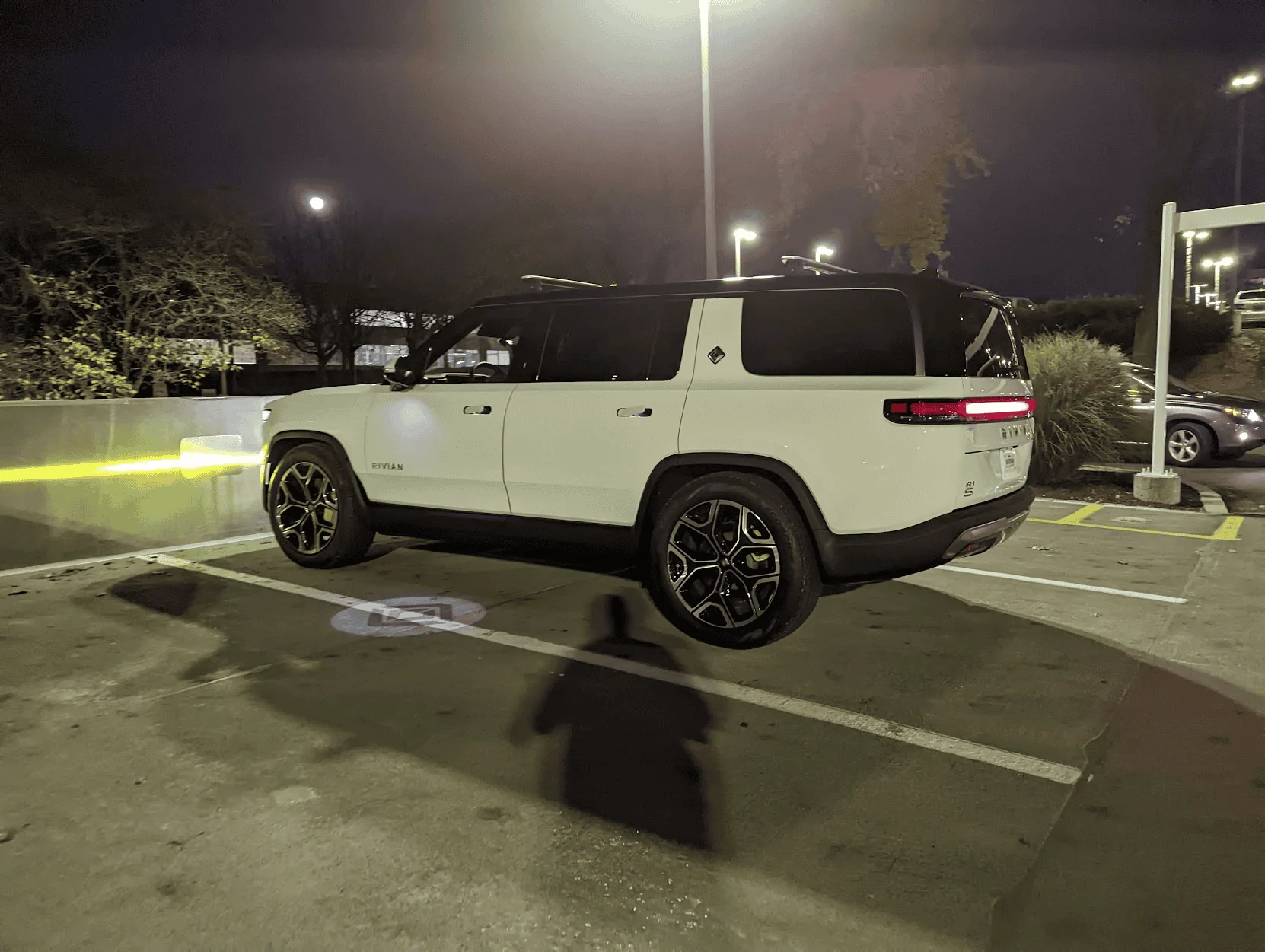

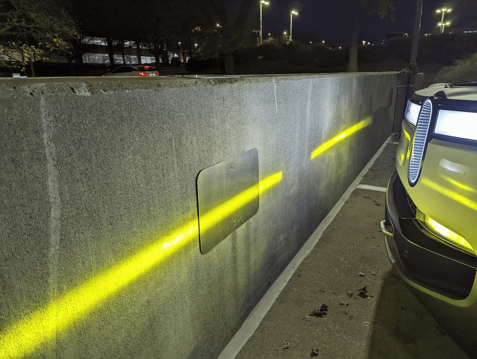

I also covered the R1T fog lights with some yellow tint and that has made a noticeable difference in the fog.
