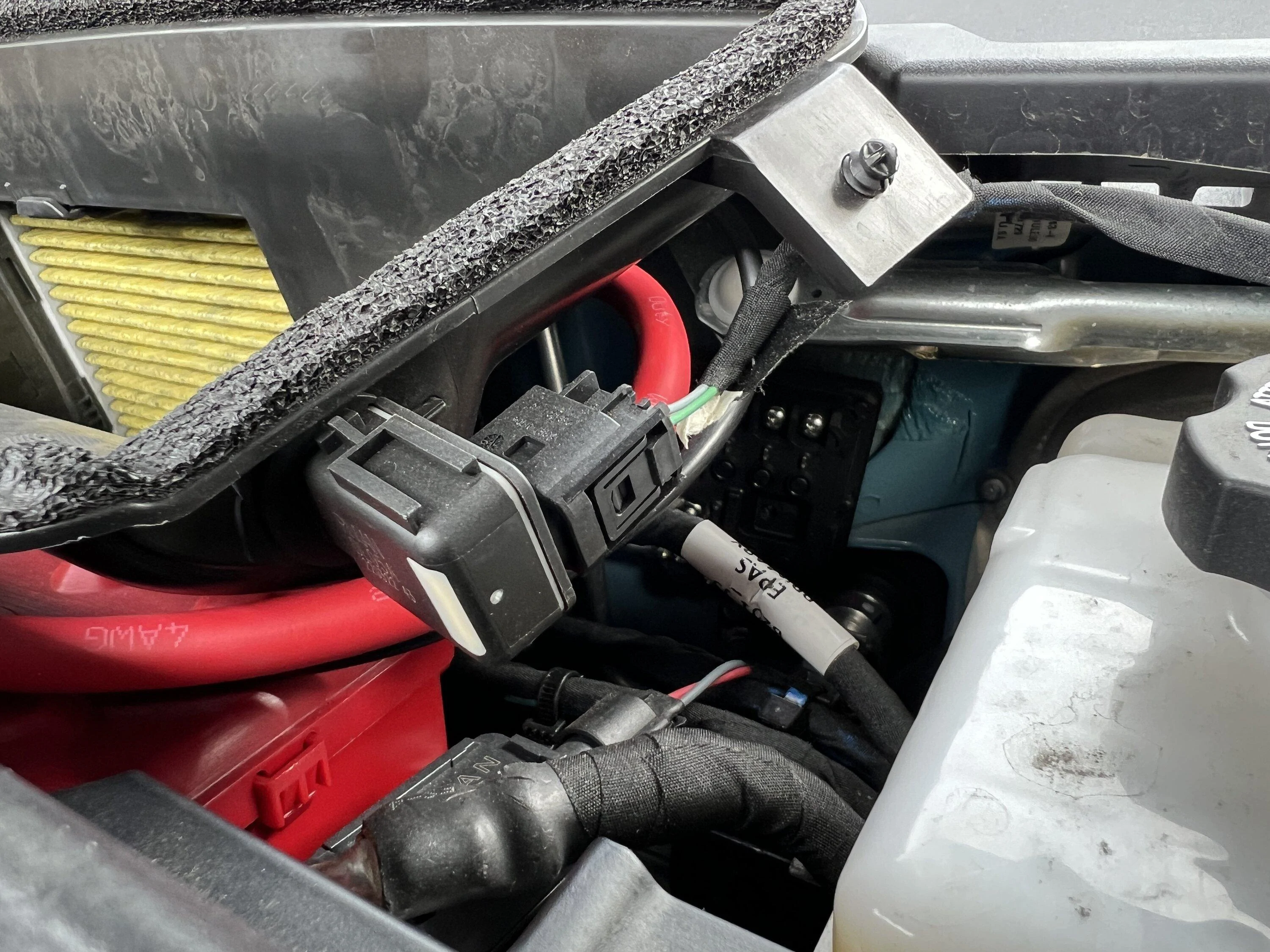

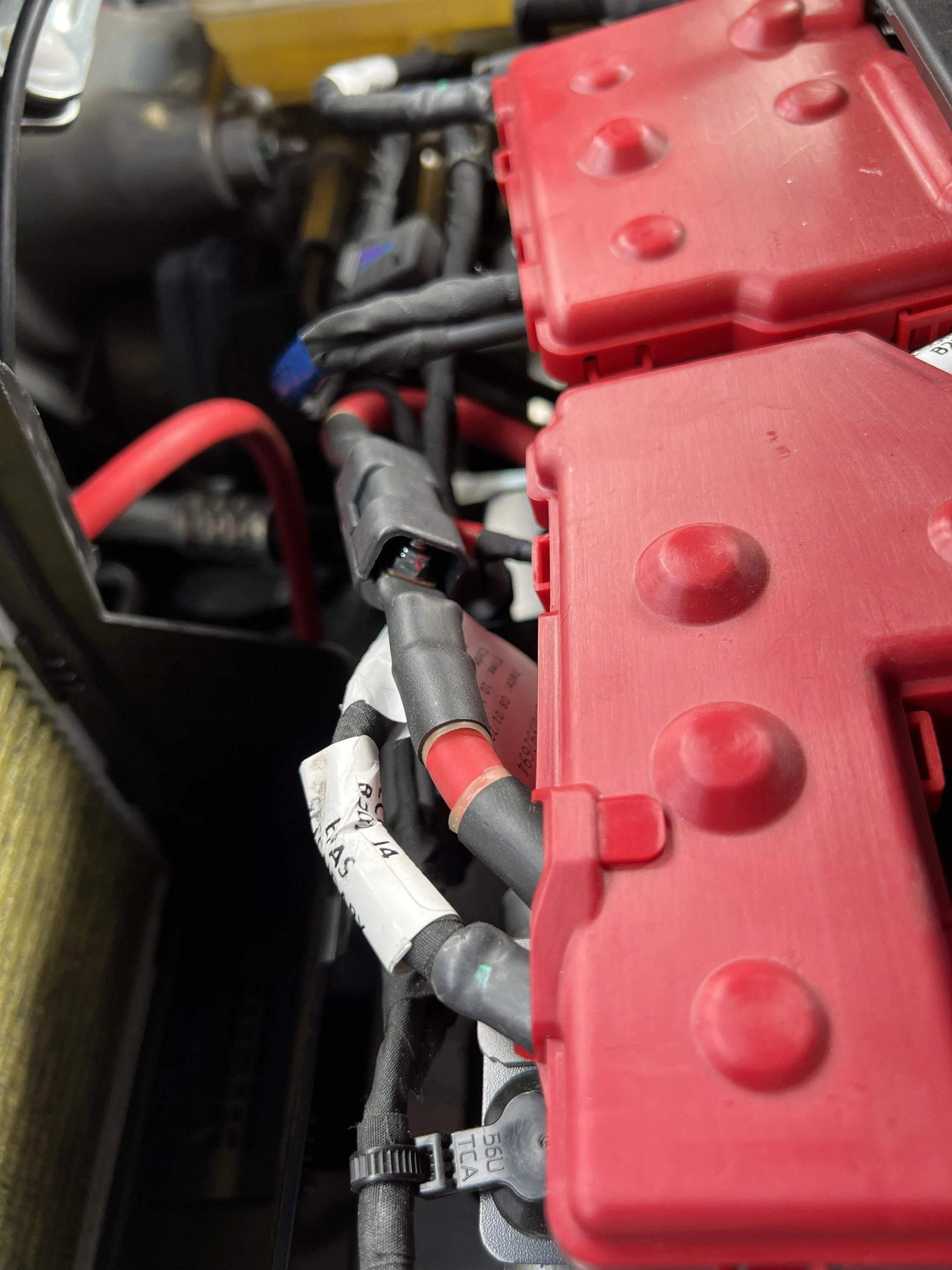

I'm in Seattle and David from S00nish and I have been talking about it. I have a temp fix for it, but she ain't purdy.

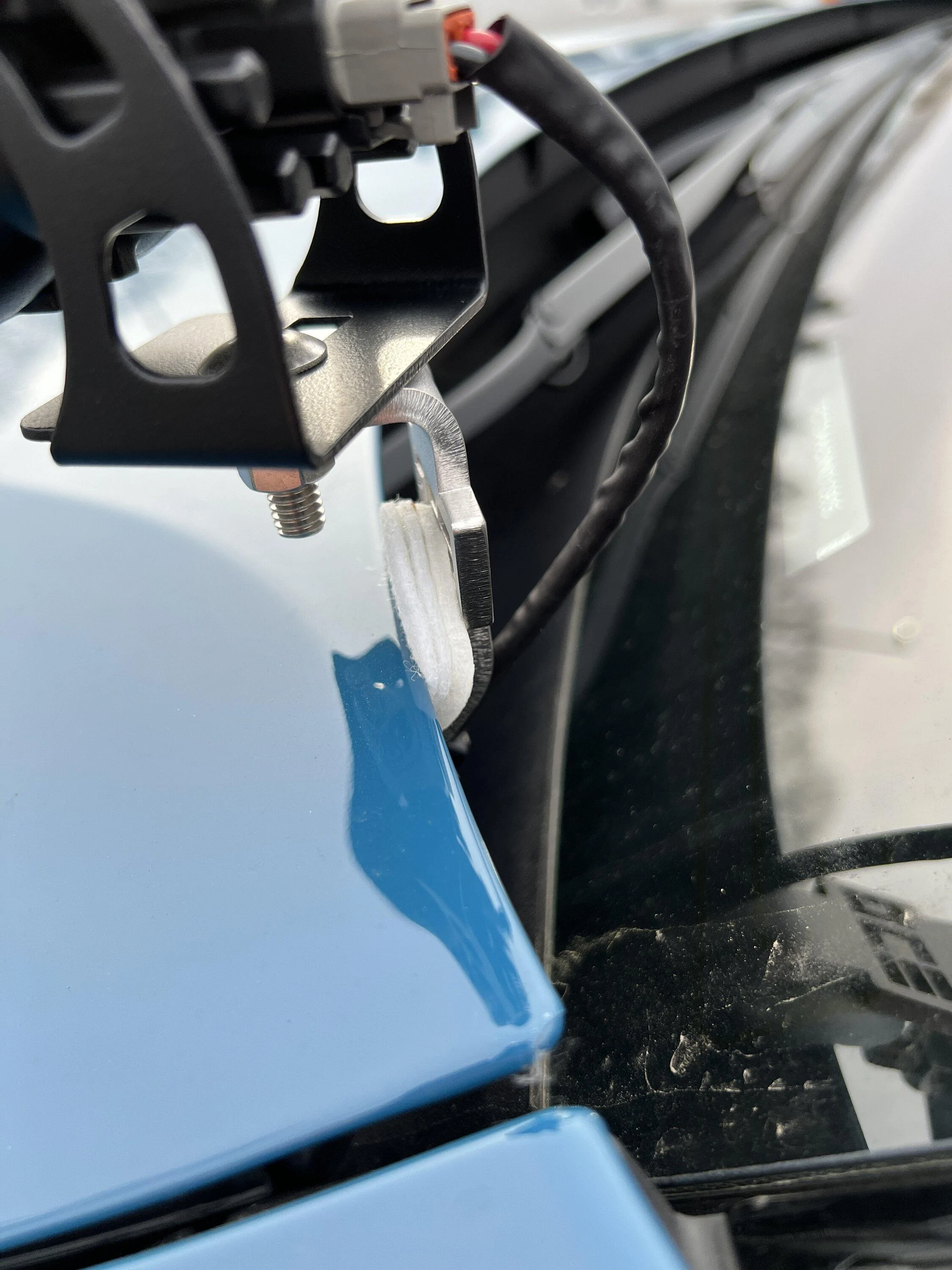

Basically, per David's idea, I stuffed 3 furniture pads (the ones you put under seat or table legs) between the hood ridge and the bracket. This stopped 90% of the vibrations, so we are on the right track there.
@Sojhinn can chime in as well, as well as plug the s00nish parts
While that’s what we ended up doing. That’s not the location we did it in. We went a different route for where to dampen the vibrations.
Also for the final product. This piece will be a piece of rubber.

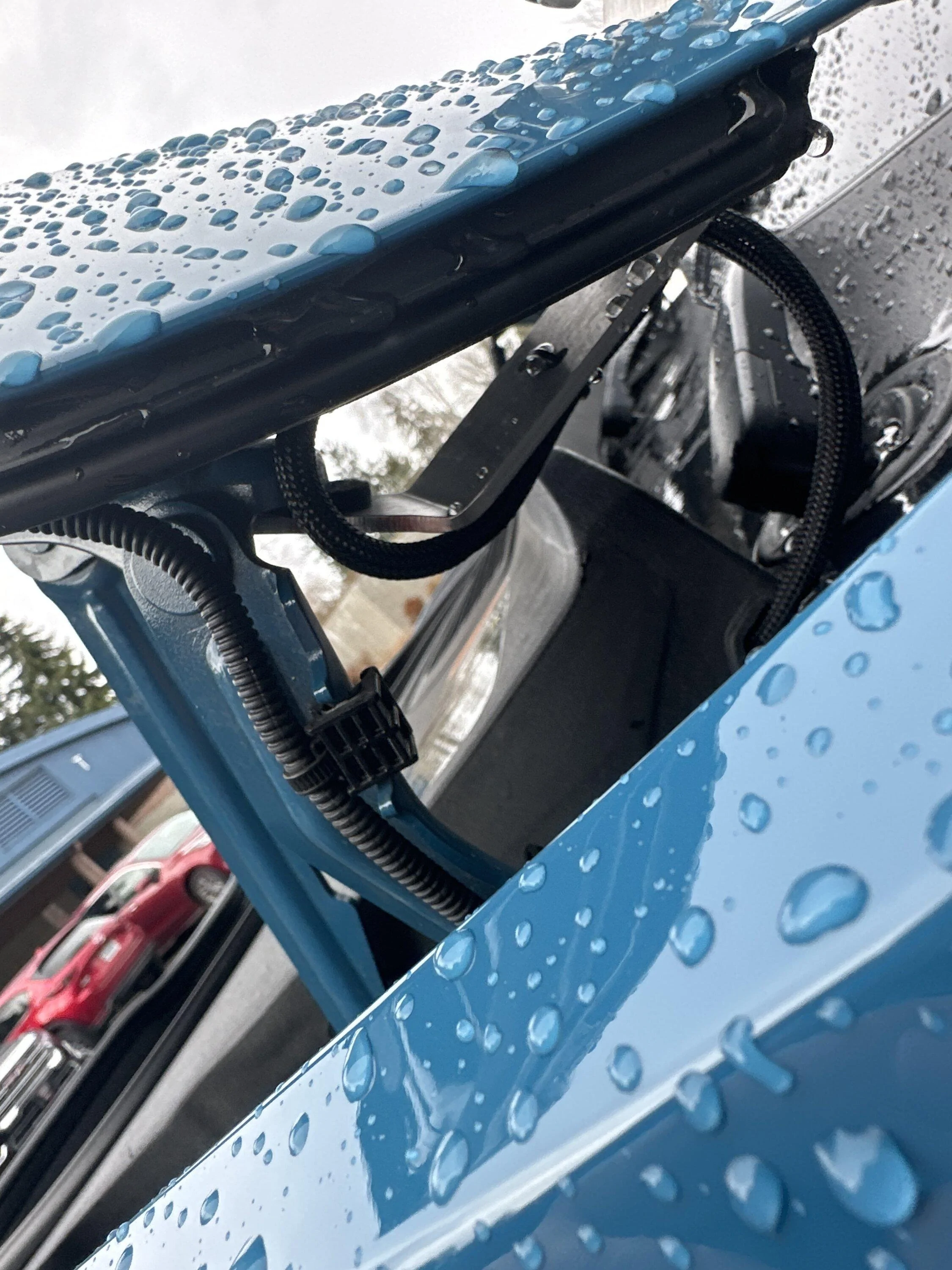

The reason it's vibrating is due to the amount of bridging that is needed to get the lights in position, and the fact the Rivian hood vibrates a crap ton. Even going with a higher gauge of metal would increase the frequency of the vibration, though it would minimize the amplitude.
See picture how we fixed it.
