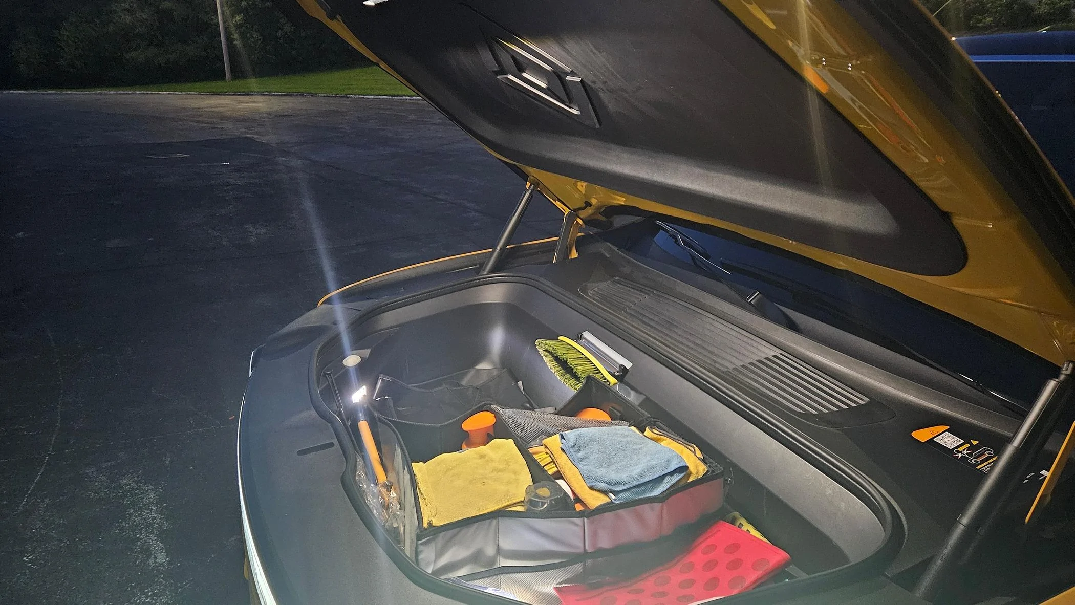

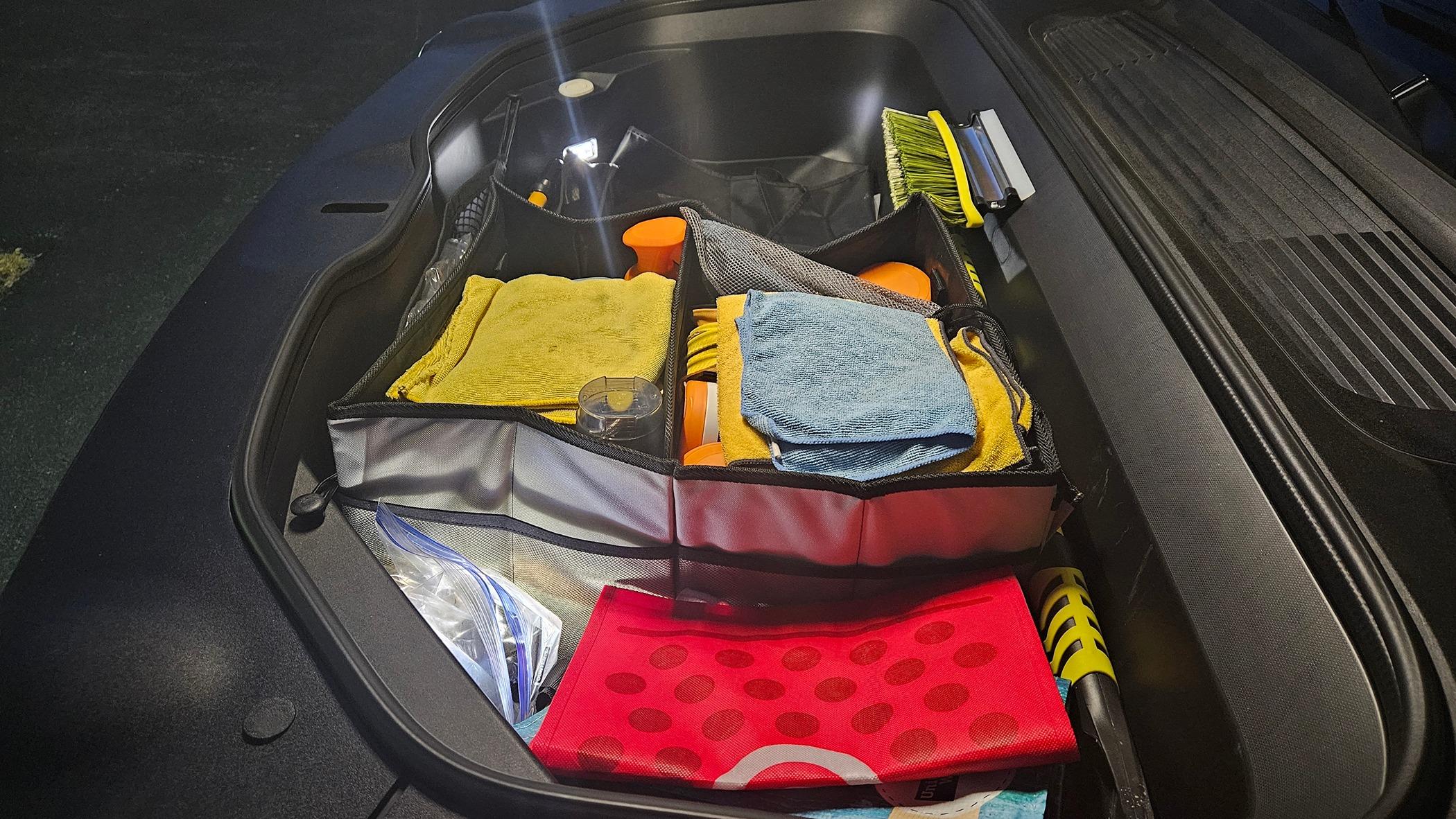

I don't know about you all, but the front trunk lighting only works well when it's empty. Once you put stuff in there, it's hard to see at night since the items are essentially blocking the lights. To remedy, I installed two of these. They're USB rechargeable, magnetic, offer warm or white lighting while being motion and photosensitive. This means they're off unless I open the hood at night. Since they're held by magnets, I could conceivably remove them for use at campsites, tailgate events, etc. Build quality is pretty good. I was expecting something cheaper a la typical Chinese manufacturing, but these are well-made. They feel solid.
One note: the frunk liner seems to be made of UMHW or similar (it's slick) so we'll see how long the sticker magnets hold.
I know someone on here did something similar, but I can't find the post anymore. If that was you, thanks for the inspiration. Hope this helps someone.

Not yet, but I'm thinking it'll eventually be an issue. The frunk liner is pretty slick, so unsure how long the adhesive securing the mating magnet will hold.
Speaking of the slickness.. anyone know if there is anything we can apply to it to make it less slick? I tried to attach stickers before but they fall in the heat.

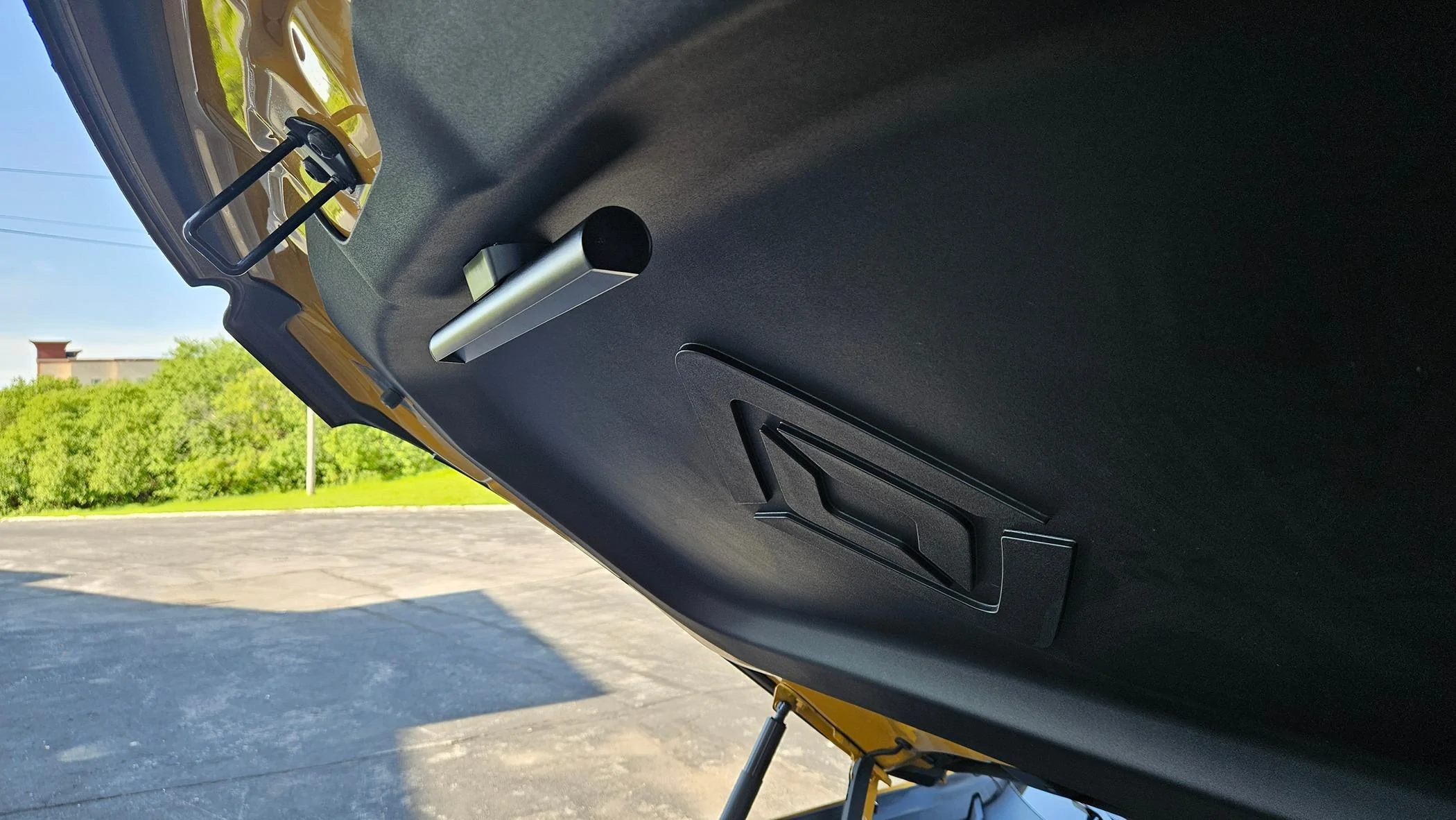

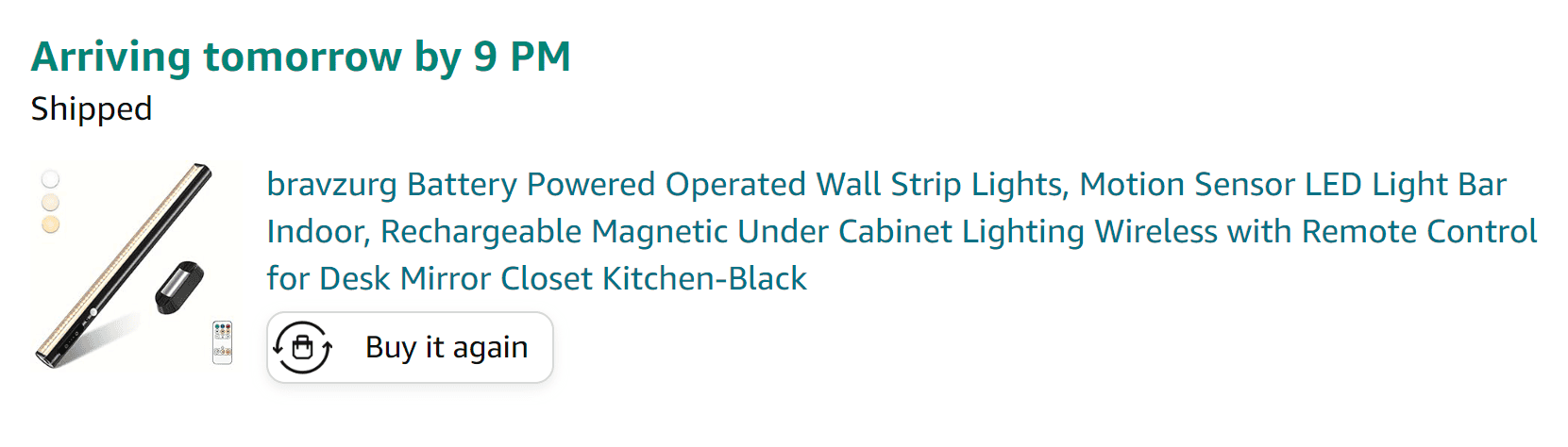

I have this coming tomorrow & plan to use "Alien Tape" to stick it to the underside of the frunk lid, Keep Ya Posted... :cool:
Rivian R1T R1S Simple Frunk / Front Trunk Lighting Solution 1716058459340-8x

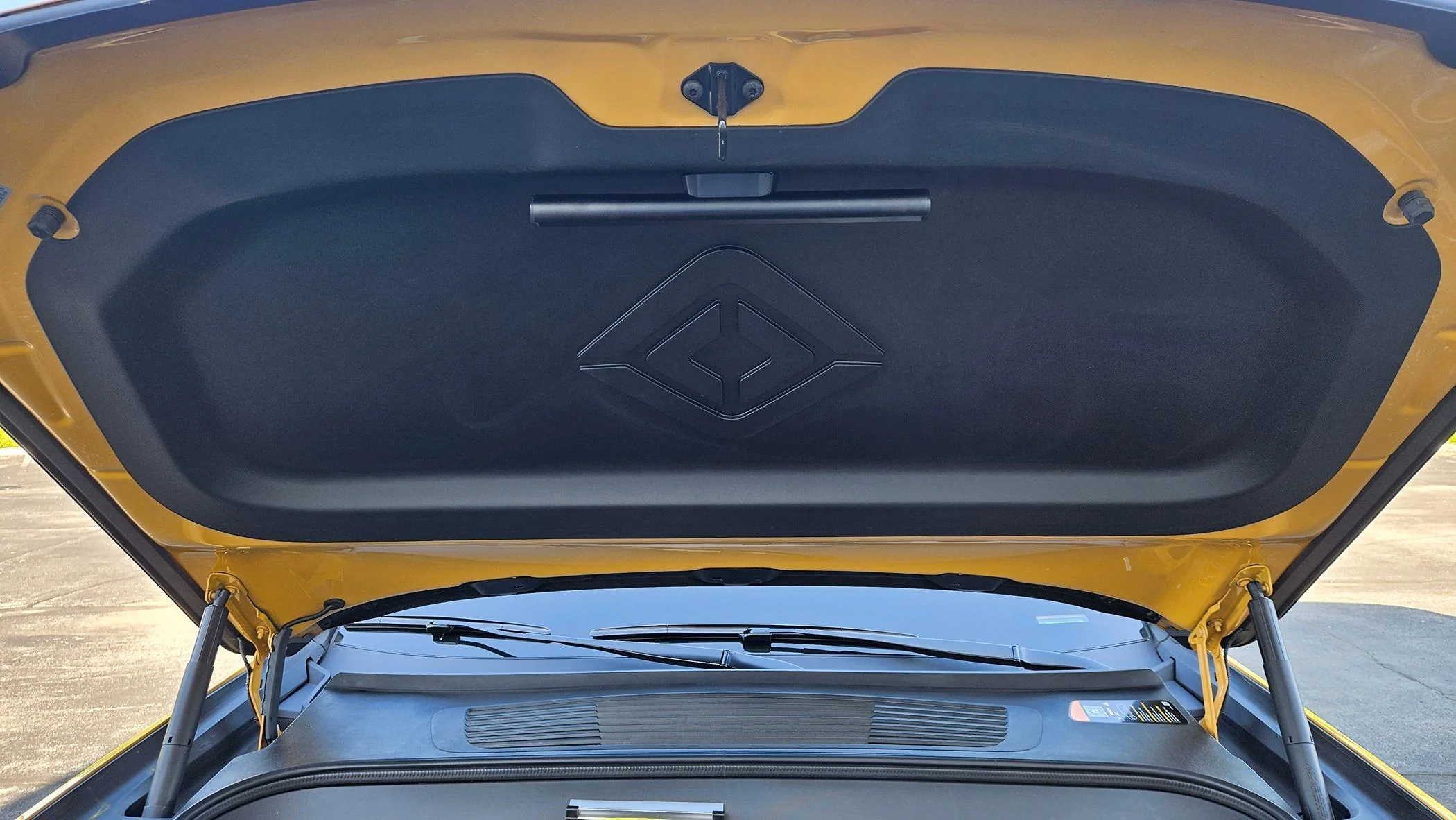

UPDATE: Here's the light bar installed & the alien tape and it's sticking very well ?
Rivian R1T R1S Simple Frunk / Front Trunk Lighting Solution 20240520_172745
Rivian R1T R1S Simple Frunk / Front Trunk Lighting Solution 20240520_172724
Rivian R1T R1S Simple Frunk / Front Trunk Lighting Solution 20240520_210116
Rivian R1T R1S Simple Frunk / Front Trunk Lighting Solution 20240520_210128
Lots of light :like:

There was another thread with a Abstract Ocean video applying their (now illegal) Rivian decals to the underside of the frunk lid and it showed how easily the plastic frunk lid liner was removed. If the tape solution doesn't work, I imagine it would be pretty easy remove the lid liner, mount a strip of steel by drilling a couple of small holes and using some small bolts, and then attach the magnetic light to that.

You can use Adhesion promotor, makes a world of difference. Just apply, let it cure for 5-15 mins, then stick the lights.
Not exactly illegal ?, just relegated to special order. Here's the video where I remove the interior frunk trim...depending on how old it is, these panels tend to off-gas or sweat quite a bit (we notice the issue with the vinyl adhesion), so again, the adhesion promotor will help with that.
