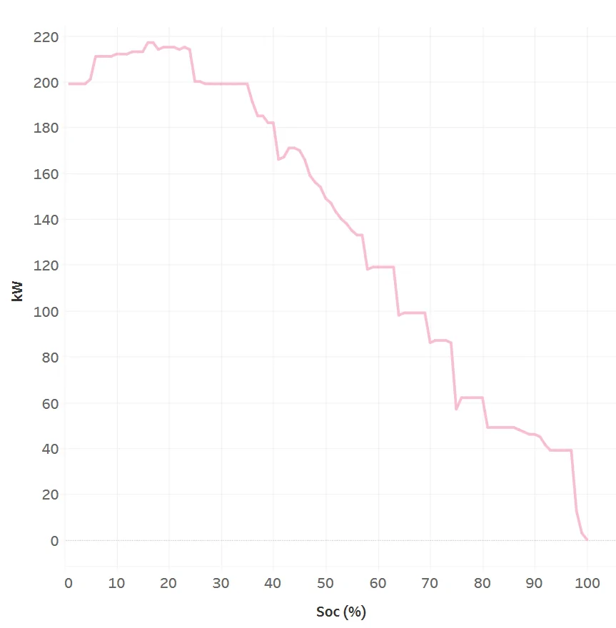

You aren't wrong - my LFP R1S automatically changes the max charge to 100% on me very frequently. I think they previous poster was saying, for a road trip you wouldn't want to go above 70%. I disagree with this sentiment though. First, I try to arrive to a charger at no more than 10%. I'm fine charging up to 80% on a road trip. You definitely want to arrive with the lowest percentage possible though as the LFP pack charges REALLY fast up to about 25% (about 215kw). It slows down from there. Between 70-75% it holds the same speed (admittedly a slow 70-80kw). You definitely want to get out after 80% as it drops to about 40kw at that point -- better to arrive at the next destination sub 20% to take advantage of 200+kw speeds.
Here's the charging curve:
