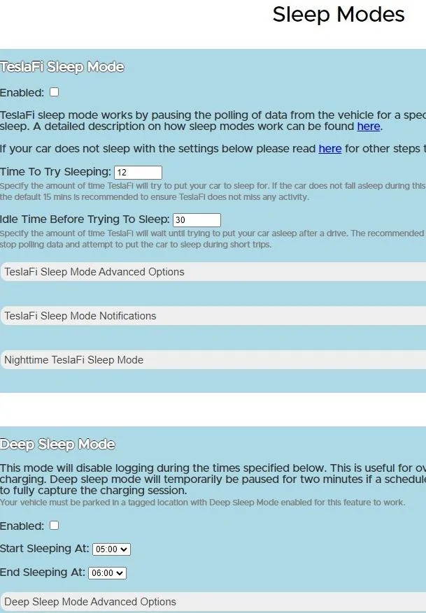

Thing is will this constantly wake it up and prevent it from sleeping?
In TeslaFI, they have various sleep options to let you stop "polling" and letting it sleep.

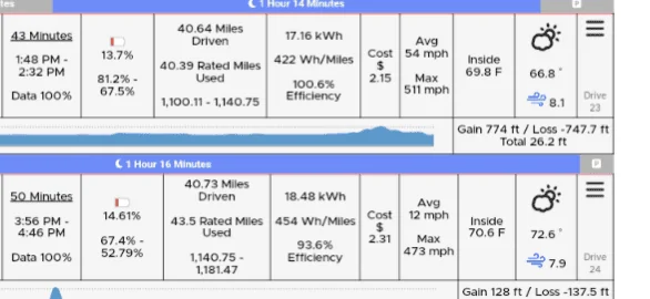

I am a huge fan of teslafi. But this still needs a lot of work. Many of the "stats" it displays are just flat out inaccurate.
Rivian R1T R1S Electrafi (Teslafi) now available for Rivian Screenshot_20230814-215712
While it is possible I exceed the speed limit at some point, I am skeptical that I ever hit 500mph.

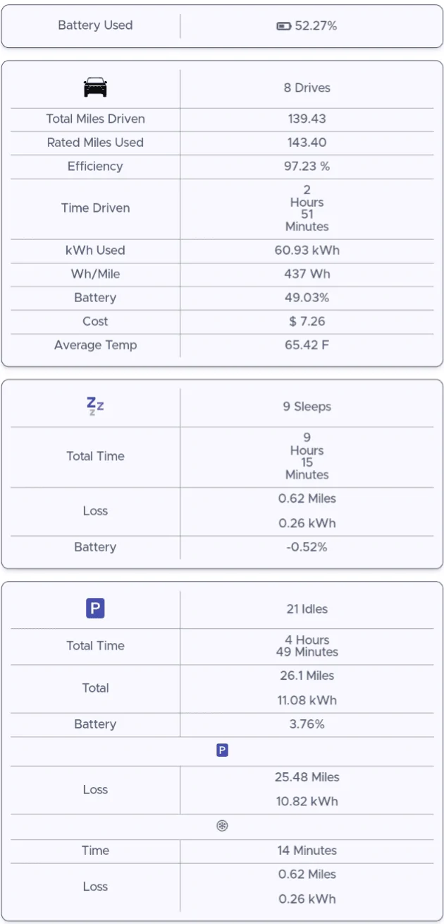

Besides the Max Speed, what other stats do you see as flat out inaccurate?
Here is another example.
It says that I used 11.08 kwh while parked. It also says that I used 3% while parked. At least one of those has to be inaccurate. Unless I have 11/.03 = 367 kwh battery.
Ohh and then somehow the 0.62 kwh that I used while sleeping accounts for -0.52% of the battery.
Did you do a charge to at least 90% after setting up your electrafi account? This is needed to baseline the battery calculations.
The 10.82 and 0.26 combine to give you the 11.08.

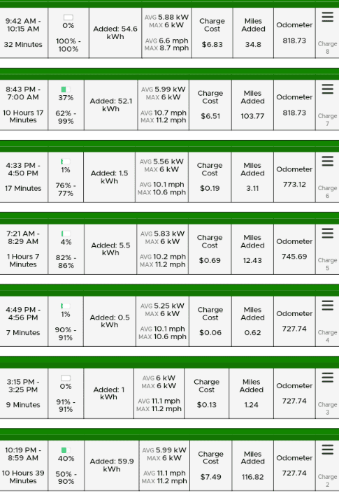

I've had occasion issues with TeslaFi and have contacted them and they've been able to track them down and correct my scenario (assuming others hit it too but hadn't noticed yet).
Yes, since signing up have charged to 90% or more several times since creating the account. And charged to 100% twice since creating the account.
But I haven't ever added 90% or more in one sitting if that is what they mean ( for example 5%-95%) that will probably never happen as I am very unlikely to ever get that low and even less likely to do it when changing past 90% is feasible.

Also, in that same screenshot it says that 60.93kw = 49.03% for energy used driving. That seems slightly off, but is reasonably close.
If it was just a % to kwh miscalibration it seems like both the driving and the parked stats would be off by the same amount. But the driving stat is close and the parked stats is obviously way off.

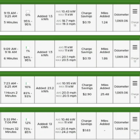

I also noticed the charging stats were off. It said I put in only 24kwh when I charged from 40-70%. Should have been around 37 kwh
It's early days. I'm sure they will work on it.
