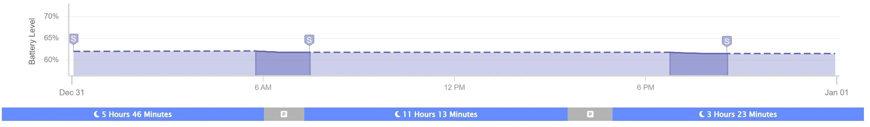

Just diving into my electrafi data for the first time. I do have gear guard on and park in a large garage serving a dual high rise building, so always expected some loss with that setting. I've always had vampire drain around 1-2% per day. Key is always 25 floors away from the vehicle.
However, I am seeing the same pattern that you have noted - generally 2 hours of sleep, followed by 1 hour of idle, give or take. Sometimes the sleep can be up to 1 hour shorter or longer, but the longest sleep I'm seeing over the past few weeks is 3.25 hours. Electrafi is confirming the drain I've noticed, it appears to be closer to 1.5 to 2.5% per day per electrafi. Although, I quit paying attention regularly in the Rivian - I don't drive a ton, so it doesn't really affect how much I need to charge.
My R1S is charging tonight, but will turn off gear guard tomorrow night and see if it makes a difference.
Below is an example. After backing out the legitimate idles where I entered the vehicle lost 1.71%.

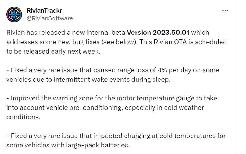

Just saw this posted on Twitter. This sounds similar to what we're seeing. Hopefully this addresses the issue.
Also looks like Rivian finally got sick of all the tickets they had to be getting for the orange motor temperatures when pre-conditioning. ?
So I guess 8% loss/day isn't normal then :rolleyes:
Just more BS from Rivian Service...

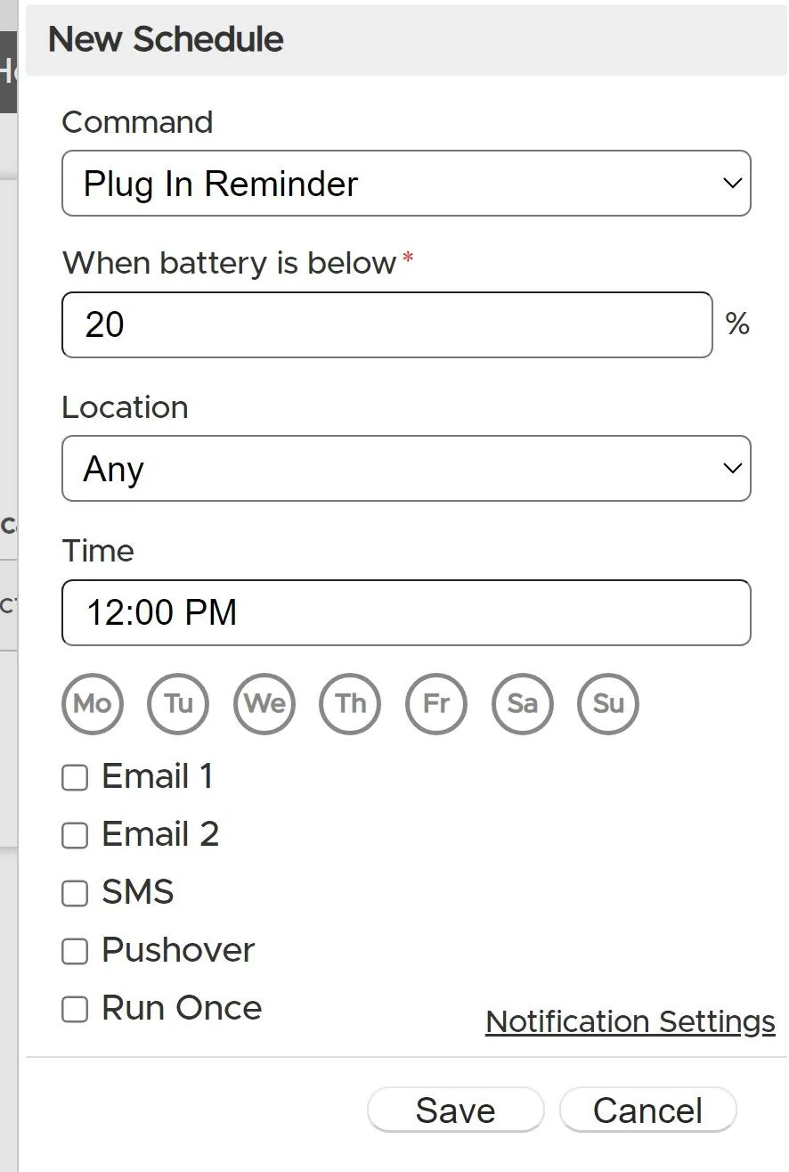

It will do this.
Rivian R1T R1S Electrafi (Teslafi) now available for Rivian Web capture_6-1-2024_172450_www.electrafi.com
