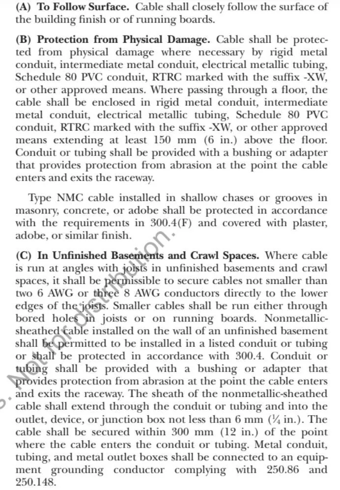

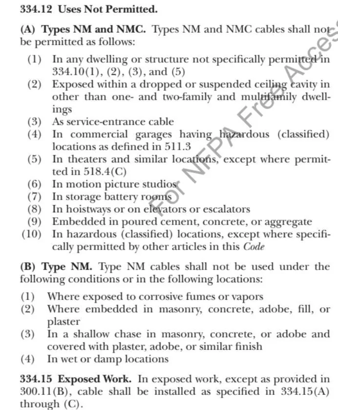

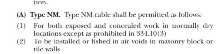

My understanding is that you cannot run NMB in the open (as in, exposed along a wall). It can be in the wall, or in conduit if on the outside wall, but that conduit if it holds NMB can't be in an wet/damp location. I'm not sure how garages factor into wet/damp. So I realized this reply is probably not helpful at all :D
That's not correct. NMB can be run in the open. The problem is the extremely vague 334.15(B) which requires protection "where necessary" (?) and leaves huge leeway to the inspector, leading to arbitrary (depending on where you are and who you ask) "7 foot", "8 foot" and "10 foot" rules meaning if it is above X feet, it is "unlikely" to be subject to physical damage. If you can convince the inspector it's not subject to physical damage, per NEC it can be exposed if it does not violate other parts of the code. However, some local codes may be more specific about this.

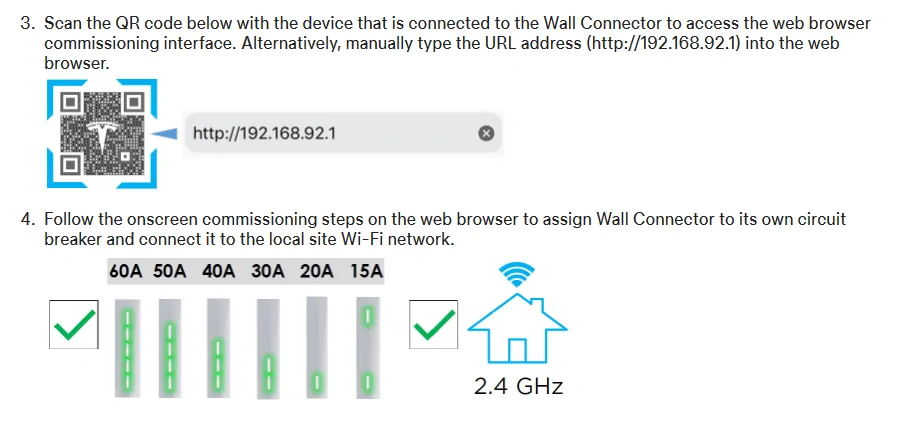

Copper #6 NM-B (Romex) is only rated for 55 amps non-continuous load, de-rate that by 20% for continuous loads, and you're now at 44 amps, so set your EVSE at 40amps and sleep well at night. For the small price diff between #6 and #8 THHN from the shutoff to the EVSE run, I'd keep it all #6 for safety... installing a 50 amp breaker on 55amp rated #8 THNN is cutting it kind of close if something shorts out that #8.
Ehhh, I think there's a provision to round up or we are missing something. If not, every Tesla HPWC in the last 10 years would be in code violation.
My AHJ let me run NMB in conduit for the garage portion of the run (not inside the house) for this reason of "protection". It was a good 25ft.
The Tesla HPWC has quite a few max amperage settings, 40 amps is one of them.
Rivian R1T R1S Electrical people. Opinions on this L2 Install? 1737754029675-dj
7,450
12,757
Some codes allow to round up as a 55 amp breaker is rare.
Personally I’m not a fan of rounding up as at some point the person installing that circuit will not be around and all people will see is the 60 amp breaker and thing that circuit is good for 48 amp continuous load. I’d prefer the 50 amp breaker so the lowest portion of that circuit is visible and not hidden in a wall.
