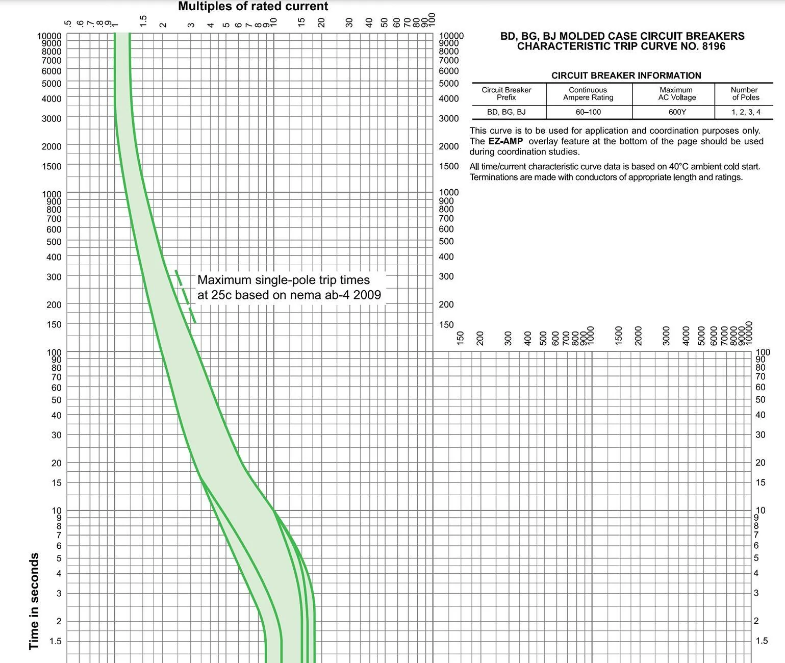

There's a lot of misunderstanding about what circuit breakers are for, what they do, and most importantly when they do it.
A 60 amp circuit breaker can experience a 62 amp continuous load and NEVER trip, by design. At 90 amp load, it might take that breaker 16 minutes to trip, by design.
A few of you are probably thinking @Zoidz is full of crap. Let's take a somewhat technical dive to see what a breaker really does.
There is a graph referred to as a Breaker Curve. It illustrates the designed trip characteristics of the breaker. The graph below is for a common brand most have heard of - Square D. You can see on the left that it is time to trip in secconds, and across the top is multiples of rated current. Using our 60 amp breaker example, you can see that the green "trip" area goes stright up "off the chart" at 10,000 seconds (16 minutes) where it is at 1x to 1.25x rated current.
This illustrates that a 60 amp breaker may never trip at 62 amps.
Let's look at a current load of 120 amps - that's 2x of the breaker rated current and the wire. Find the 2 multiple across the top, and follow it down to the green area. It's roughly 150 to 400 seconds until the breaker trips.
This is by design - the breaker will (is supposed to) heat up and trip BEFORE the wire gets hot enough to melt the insulation. That's why the current rating differs by insulation type. It's not the wire melting that is the concern, it's the insulation melting and causing a massive high amperage short circuit.
If there was a massive high amperage short, such as 15x, (900 amps) the curve shows the breaker tripping in just a second or two. Again, the wires don't have time to get hot enough to melt the insulation.
Why is there this delay? Many devices (motors, heaters, even larger old school light bulbs) draw 2x or 3x their rated current on start up until the motor starts spinning. the heater element gets hot, etc. You don't want the breaker to trip every time you turn on your electric oven or range, right?
