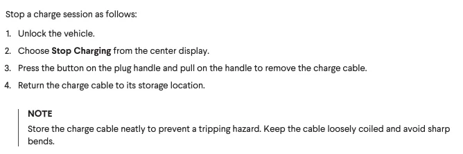

When you press the button on the connector to remove it the charging stops and then the handle releases. This is how I often end my charging sessions.
Unless the connector was malfunctioning I can't see how an arc is possible but then again something here was definitely malfunctioning.
Maybe they didn't stop the charger before removing the locked plug.

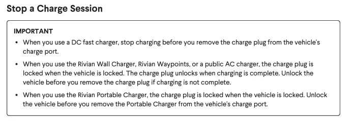

I never do this with Tesla home chargers, J1772, or superchargers.
I just press the button on the connector and it stops charging and releases the connector.
Is there a reason you have to do this with CCS/Rivian chargers?

I always stop in the truck first, but I understand that's how it works. I was just saying, there really is very little chance this initiated outside of the vehicle.
I stop in the vehicle, because there have been discussions where just pulling the cable with EA sometimes would not register on the charging head that the session had ended causing issues later trying to charge again on EA plus the head would never cycle out for use by someone else.

The CCS connector is locked by the vehicle, until the charging is stopped.
