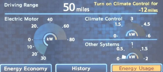

My Leaf always displays 2 things relating to energy on the display directly behind the steering wheel.
  1. SOC - Level of Charge as a percentage (0-100%)
  2. Estimated Range in miles or km
Rivian R1T R1S Energy Displays 1633695908620
I can choose on this same display to show additional energy information such as mi/kWh as an average and instantaneous but the first two are there regardless.
Rivian R1T R1S Energy Displays 1633695963261
These two are all I need for the majority of the time, but seeing something like mi/kWh can be useful when I'm trying to evaluate driving efficiency and calculating the "true" range that you might have available to you. The display in the center has even more options to see energy consumption.
Rivian R1T R1S Energy Displays 1633696066896
The "why" to my response that they should have any and all of these options is because it is simple to do. They have the data and Nissan has been showing it since 2011, why can't Rivian in 2021?
Give us visual to the data they already have and allow us to choose what is most useful to us as clearly we all use it a little differently.
