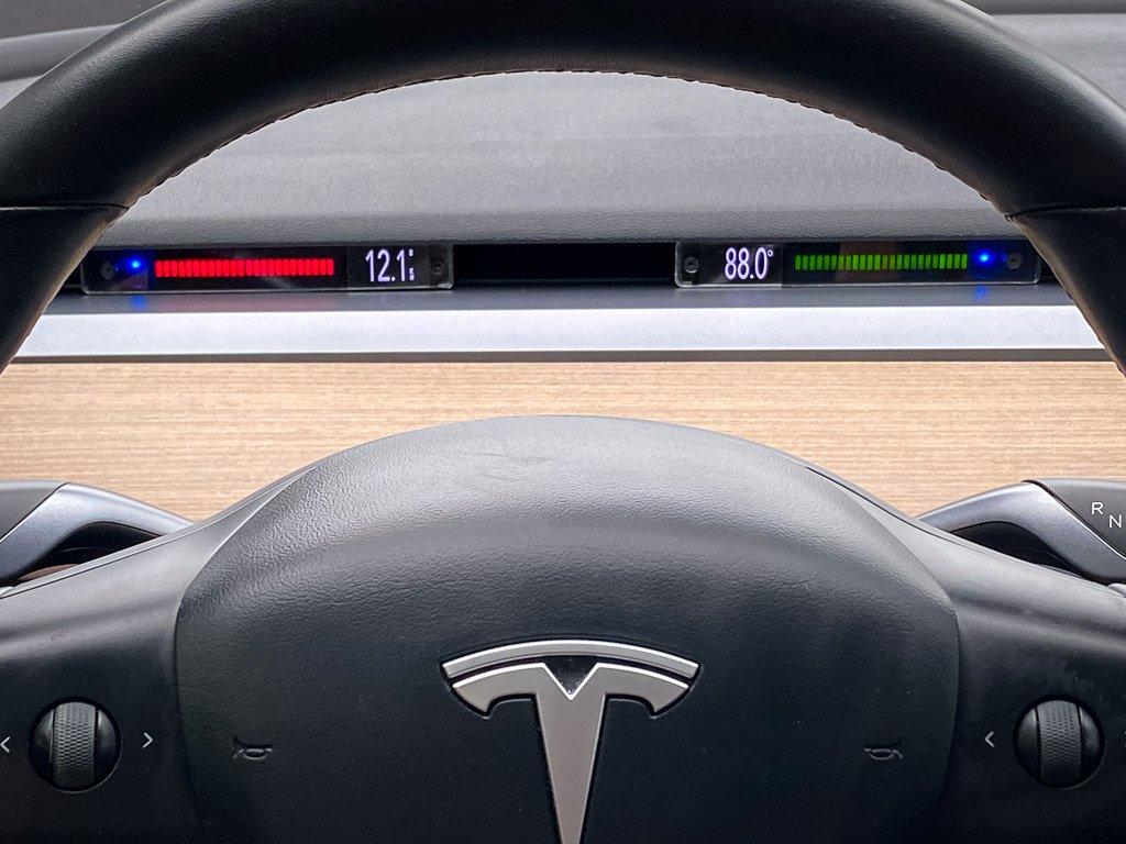

Here are the two displays I find I want to see at all times: Instantaneous battery wattage, and pack temperature.
WIth the choice of thousands, they are the two I like to watch while driving, and have front in center in front of me on my dash:
Rivian R1T R1S Energy Displays 20200927-093447_2048x2048
Power of course is great to see when you hit the pedal, but it's also great to see how much you are sucking at a steady speed in various situations. It's even useful when not driving, to see how much AC or heat is taking, or how much charge power is going into the battery.
Battery pack temperature communicates how the car will perform, and why...as it falls below room temperature your regen gets weaker and none if it's below freezing. You can also see if the battery is warm enough to accept full speed DC charging, or if it's limiting the charge (or more often, the charger).
But ultimate there are thousands of signals I occasionally am interested in...I can always log them all and graph them later on the computer but nothing is better at experiencing things live and seeing how all the systems and sensors react to various situations. EVs are a lot of fun for data nerds :)

What's that a picture of?
I too would love to see battery temperature and kWh remaining but there is no way I know of to get either of these numbers before me in the current X I am driving. Tesla seems as determined as any of the other manufacturers to hide real battery capacity info from the diver. And I have noticed that the latest software version has taken the numbers off the power meter.
You can tap into the CAN and get everything you can imagine. Then view it on a phone app, or one of my little displays there, or log and analyze later.
My battery display now shows me temp, cell balance, max regen and max discharge, again all values describing performance.
This is why I'm waiting to see if Rivian spits out data over CAN through an OBD port, or we can find it elsewhere, or if it's all ethernet as rumored. I'm determined to tap in :)
