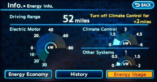

I've seen other EVs that break this information down and display the overall consumption but also show how much is due to HVAC and non-propulsion uses. I like that.
SlaterGS
Oct 14, 2019
588
1,055
Ohio
Yea, this is how my Leaf displays it. I don't view this particular page all that often, but the data is available, they should be able to provide it!
