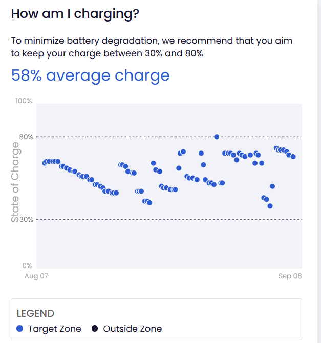

My R1T is the first electric vehicle I've owned, so have zero prior experience in the care and feeding of EV batteries. From what I've read, including the comments in this thread, the general rule is to keep the SOC between about 70% and 30% and to charge frequently. I follow the first of the suggestions pretty scrupulously, but really only plug the Rivian a few times each week. This appears to be ignoring the "always be charging" rule, and I wonder if doing so has a deleterious impact to battery health and longevity.
Should I be charging more frequently? Another question: how do I determine the number of cycles? If I go from 30% to 65% three times is that roughly one complete cycle (~35% each time)?
Here's a graph of my charging from Recurrent. The outlier charge to 80% was in preparation for a trip to the mountains, about 110 miles away. I can easily get there on less than that of course, but wanted some buffer to allow me to run several errands before being able to plug in again.
I would not let the battery get below 40% on a regular basis. That is just me, because 40%-60% is the happiest place for the battery, and low charge is not a good thing for battery health. So, I would continue doing what you have been doing but change the floor to 40%.
Again, as I posted and others (like Glembi a new minutes ago), it really isn't going to make that much of a difference anyway unless you plan to keep the truck for 10 or 20 years. And then maybe, just maybe, being so careful will result in a battery with a measurably higher health.
Rivian and other BEV manufacturers put a lot of effort into the Battery Management System (BMS) so that it keeps the battery healthy for a long time, even if you often charge to 100%. Rivian recommends you don't do 100% charges regularly, as does everyone I think, but even if you do the increased stress on the battery health might not ever be noticeable to you. Ever. Especially if you keep the truck for less than 5 years.
Just do what makes you feel good and use it like it is meant to be used. Charge it as high as you need to.
Personally, I never let the battery get below 60% when at home because I want the car ready to go if I need to take an unexpected trip. My charge zone is 60-80%. But that is just me. Yes, 80% is more stressful than 70%, but I don't like having a vehicle I cannot use because the charge is too low to get me where I need to go.
