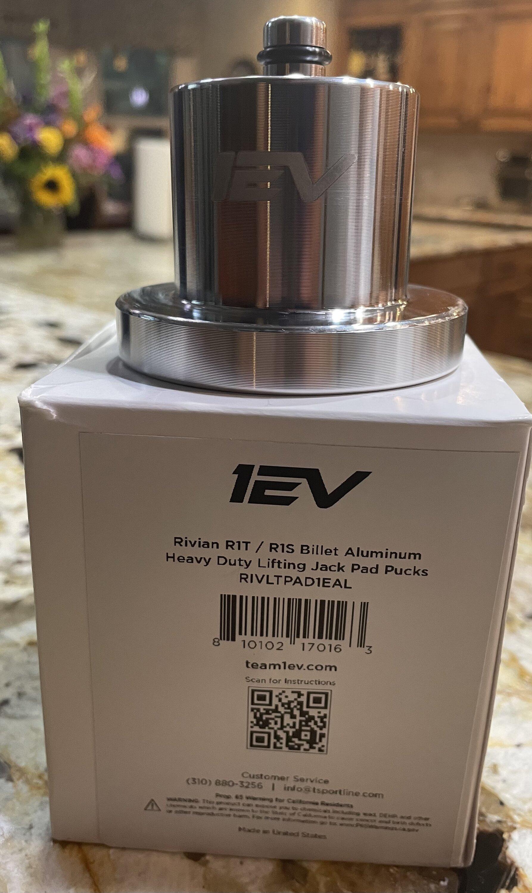

Whoa Nelly. I just got one for my floor jack.
Didn’t mean to send folks diving for their manuals. Guess it’s better than doing so on the side of the road at night.

Do these work with the supplied jack?
The supplied jack includes a puck designed for it, so use the two together.
The billet pucks are for aftermarket floor jacks and lifts.
