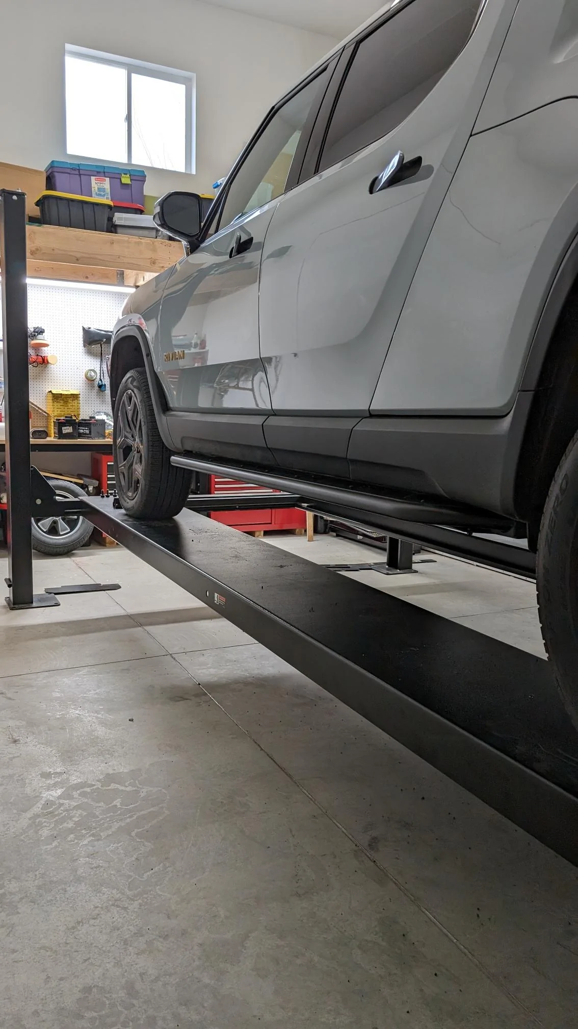

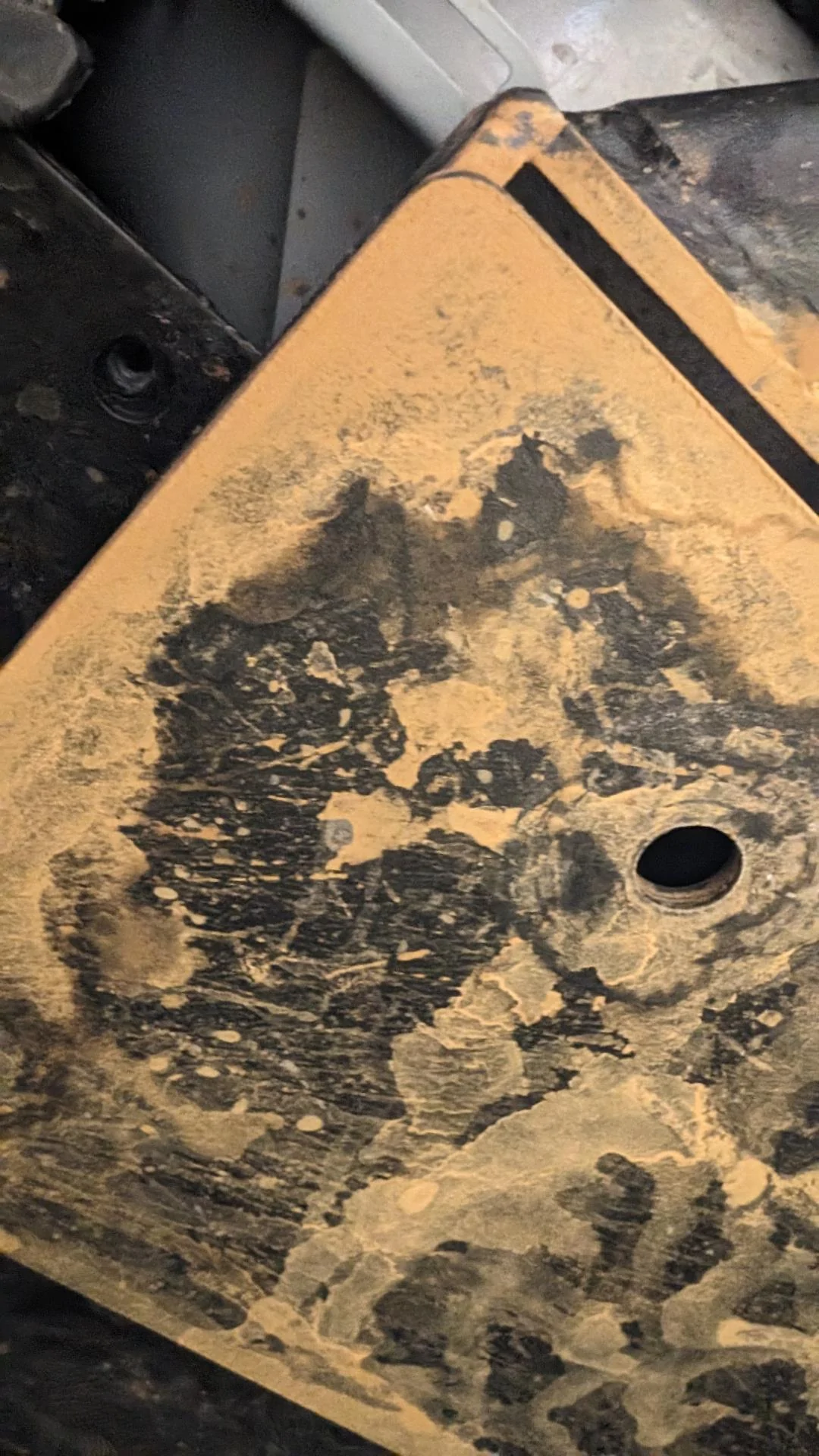

Seems that the rusting issue is all too common and possibly not a "one off" or "solved issue". I have about 100 miles on my sliders and they are already rusting. These are from the latest batch.
I know that EVSportline will warranty them, but they won't warranty my 1/2 of day of labor replacing the rusted ones and disposal of the old ones.
Quite frustrating...

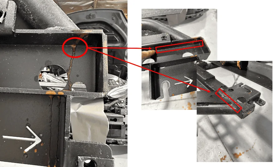

Yes, apologies here - FYI there is a quick(er) an easy solve option too - this slider rust you're seeing is surface rust from "inside the tube", not a powder coat issue (any small pinhole or edge gap in weld can allow water to get 'inside the tube', we're adding a new production QC step to inspect against this). The rust stain can be washed off...and a dab of silicone can seal off any edge seam that isn't welded. PM me if you need any help!

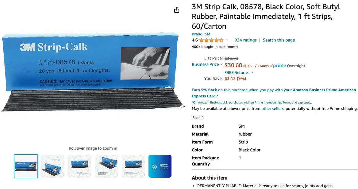

Great idea! thanks for asking:
Okay, look for a spot that is 'leaking' the rust / water. Clean and dry it well. Apply this strip calk (or silicone, or whatever you like)....done!
Rivian R1T R1S EV Sportline Running Boards Rusting after 2 Months Screenshot 2024-02-11 at 1.17.23 PM
Strip caulk
https://a.co/d/4OZAGUn
Strip caulk
Not sure I'm quite following along.... do I have to remove the sliders to inspect / do this? Sure hope not.
1. You dont need to do anything unless you spot rust stain. This only applies if you spotted a rust stain on bottom of slider (from water getting into the tube and leaking out as rust water).
2. If you have a rust stain, pull off the skid plate and find where the water is leaking out of the tube. you'll see it dribbling out like the photo I shared. Simply seal that spot.
