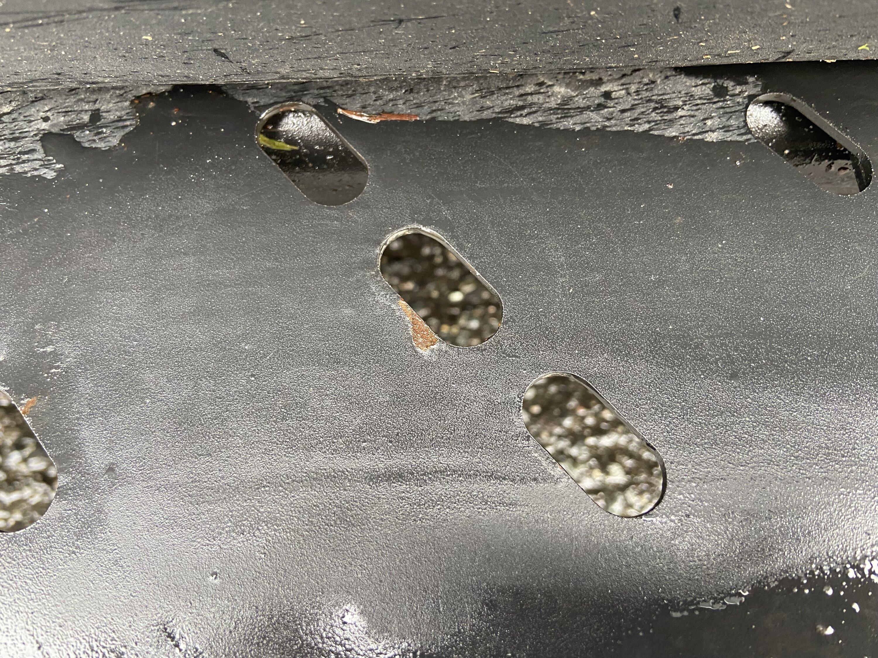

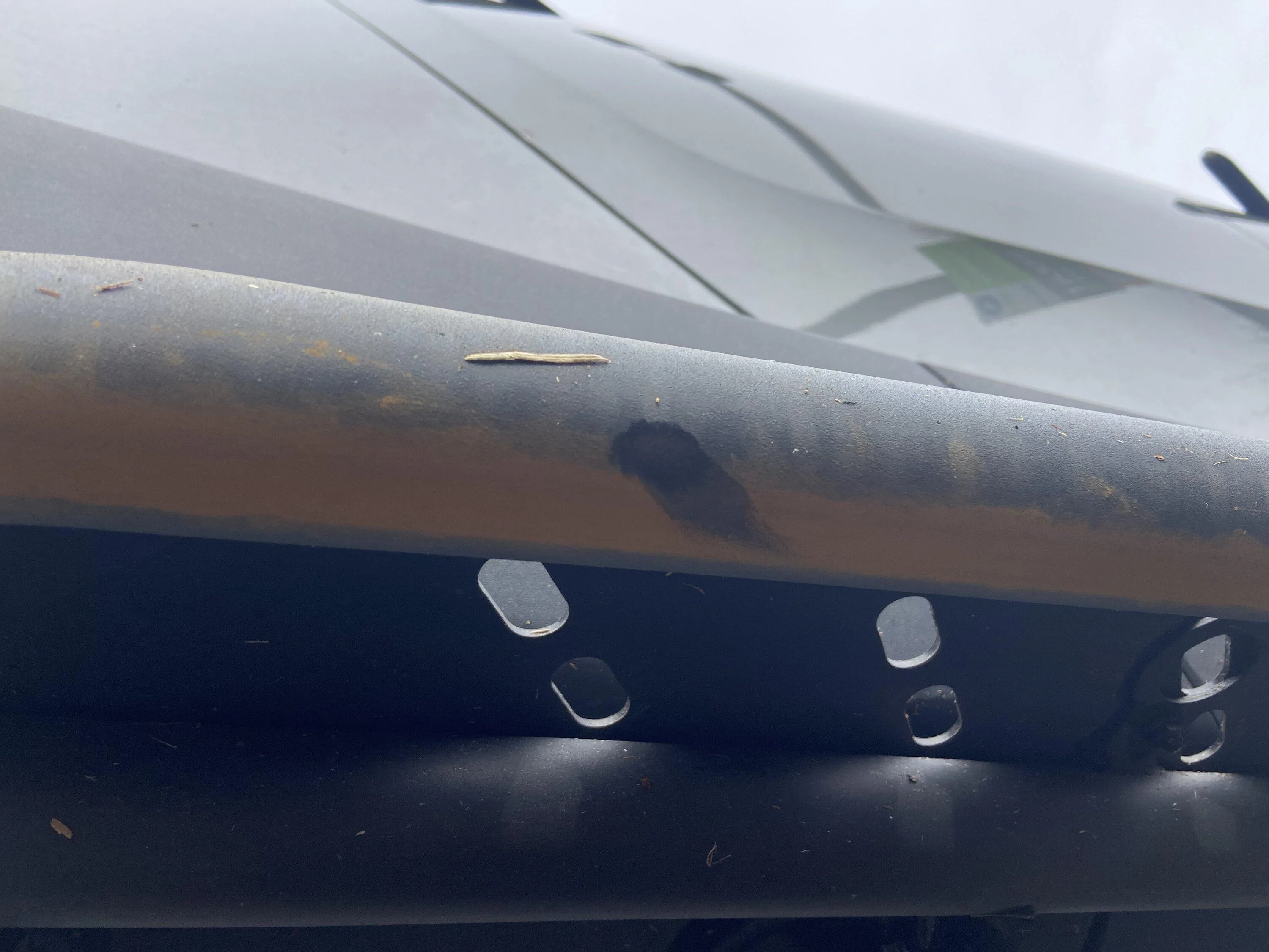

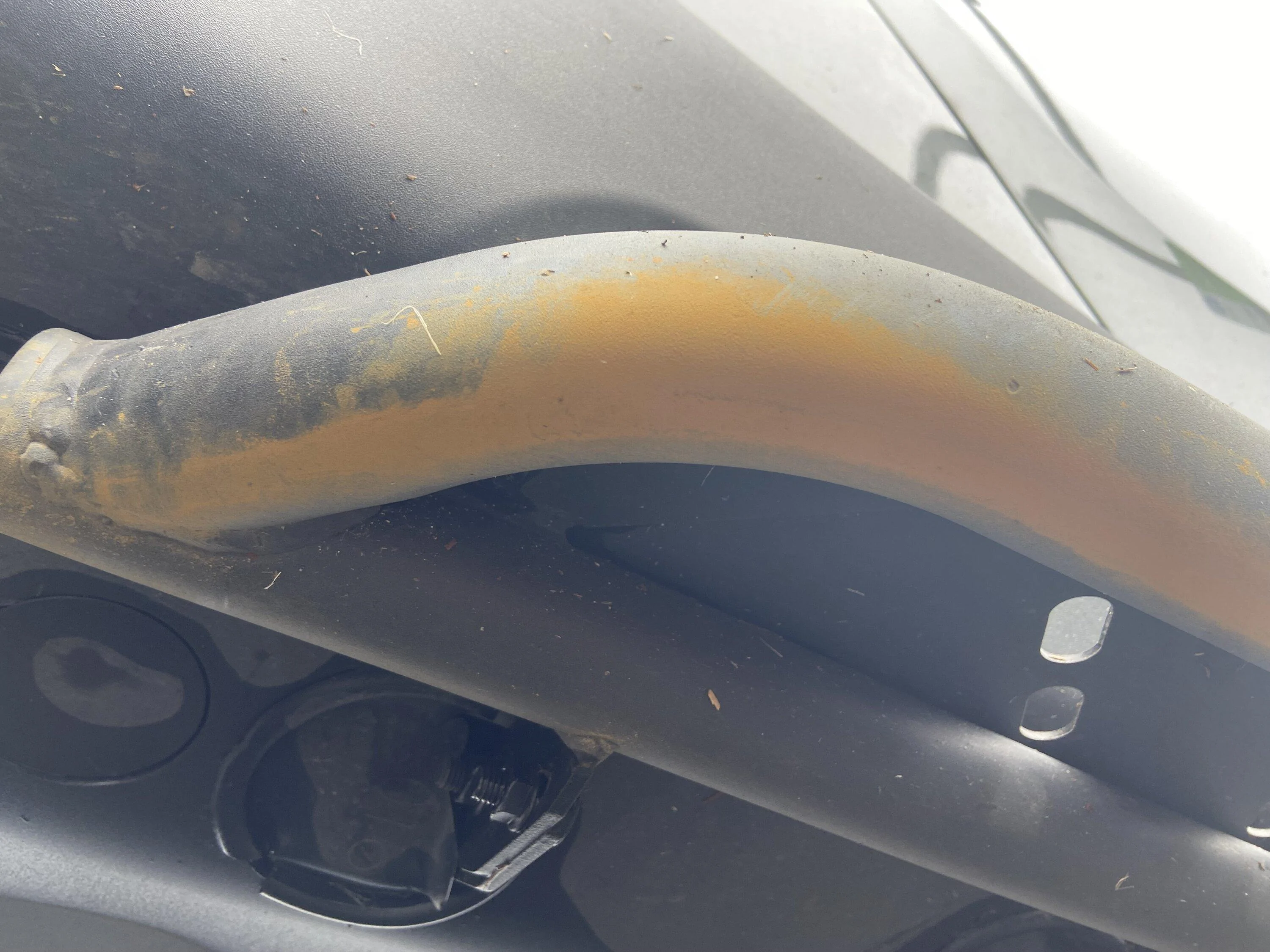

unfortunately i've got rusting on both running boards. on the drivers side theres an exposed spot and on the passenger side you can see rust along the bottom about 1/3 of the length. could you start a warranty replacement?
sure, just contact us at [email protected] - fastest way to solve!

I emailed and got a response very shortly. I was told its covered under warranty. Appreciate the support and great customer service.
just got the email that the replacement boards are on the way. thank you @EV Sportline. top notch customer service.
