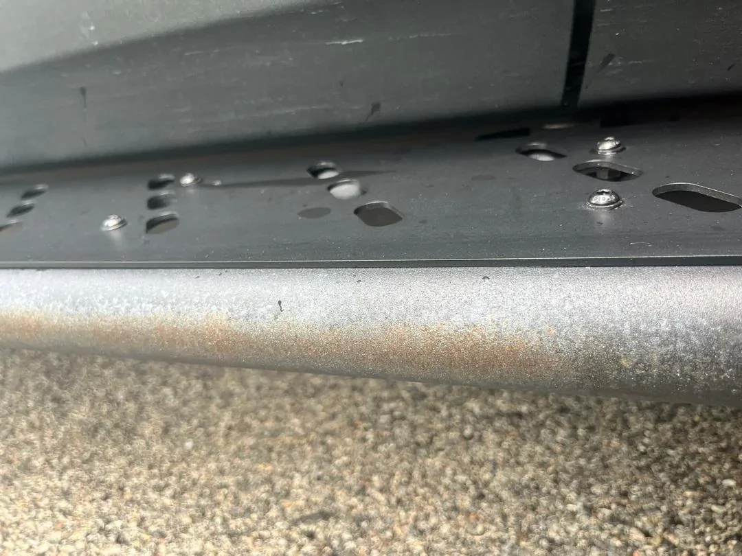

I came across this photo on reddit from a guy that has had his EV Sportline running boards for just two months and they are rusting. Has anyone else had this issue? This looks really bad.
"I had the EV Sportline running boards for about 2 mos now and just noticed today, it started to show rust. Anyone else notice this? I just reached out to them and waiting on a response.
The truck is parked on the driveway, rarely in the garage, as the garage is too small."

looks like you got a defective one. maybe that one didnt get coated properly. how does the other side look?

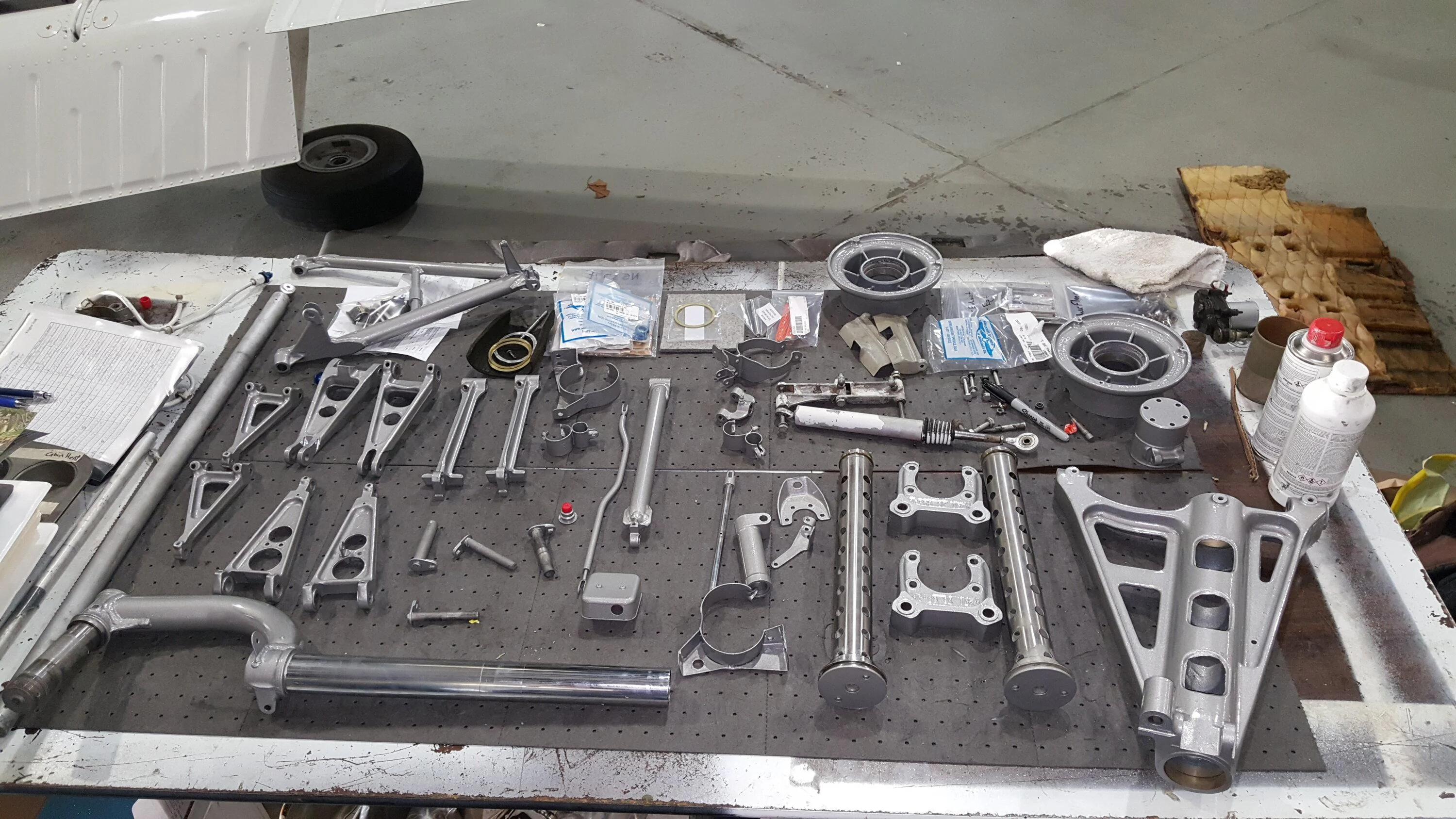

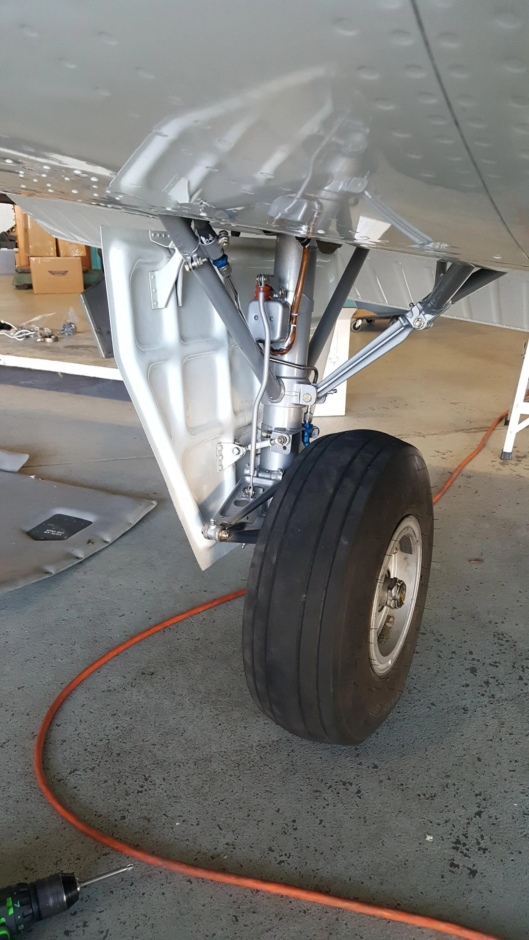

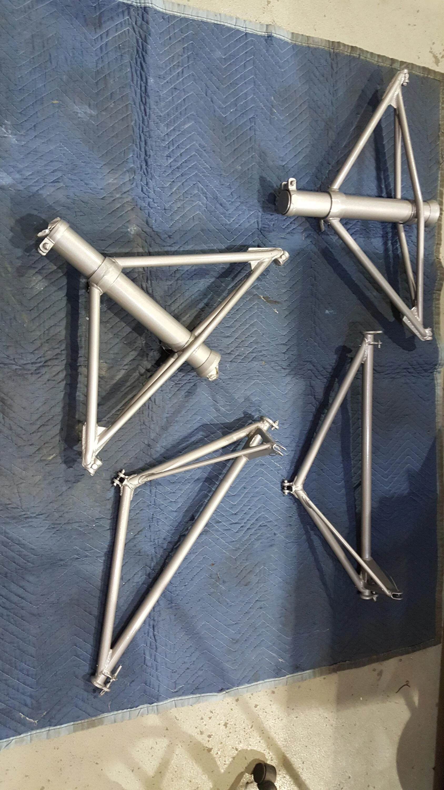

It’s best to anodize black or silver cad plating before powder coat in epoxy
when I do aircraft landing gear or wheels , I do a chem strip and then silver cad plate before the powder coat or epoxy paint.

I bet it’s cheap China flash coating

I noticed the thin coverage like that when I installed them. 99% sure it’s only a matter of time before it starts to rust, I just happen to park in a garage

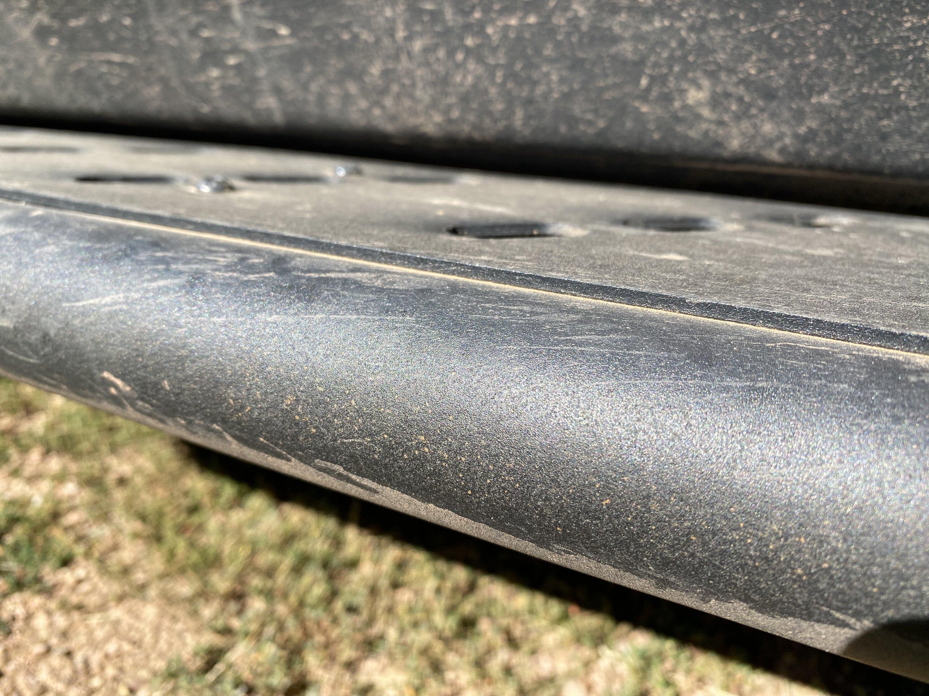

I'm probably going to have the same issue but so far they are holding up well. My concern is coverage of the powder coat on the flat step portion. There are some areas at each end where it's apparent that the powder coat coverage is thin. I've held off letting EV Sportline know because it's difficult to photograph. I've had mine on for 5 months and seen some rain a few times.

These really need a zinc primer, galvanizing, or something similar under the top-coat. One coat powder coating or paint systems don't have significant corrosion resistance- and once they're scratched, they have none. The most durable/corrosion resistant systems are generally 3 part. Zinc primer, epoxy mid coat, and urethane top coat.
