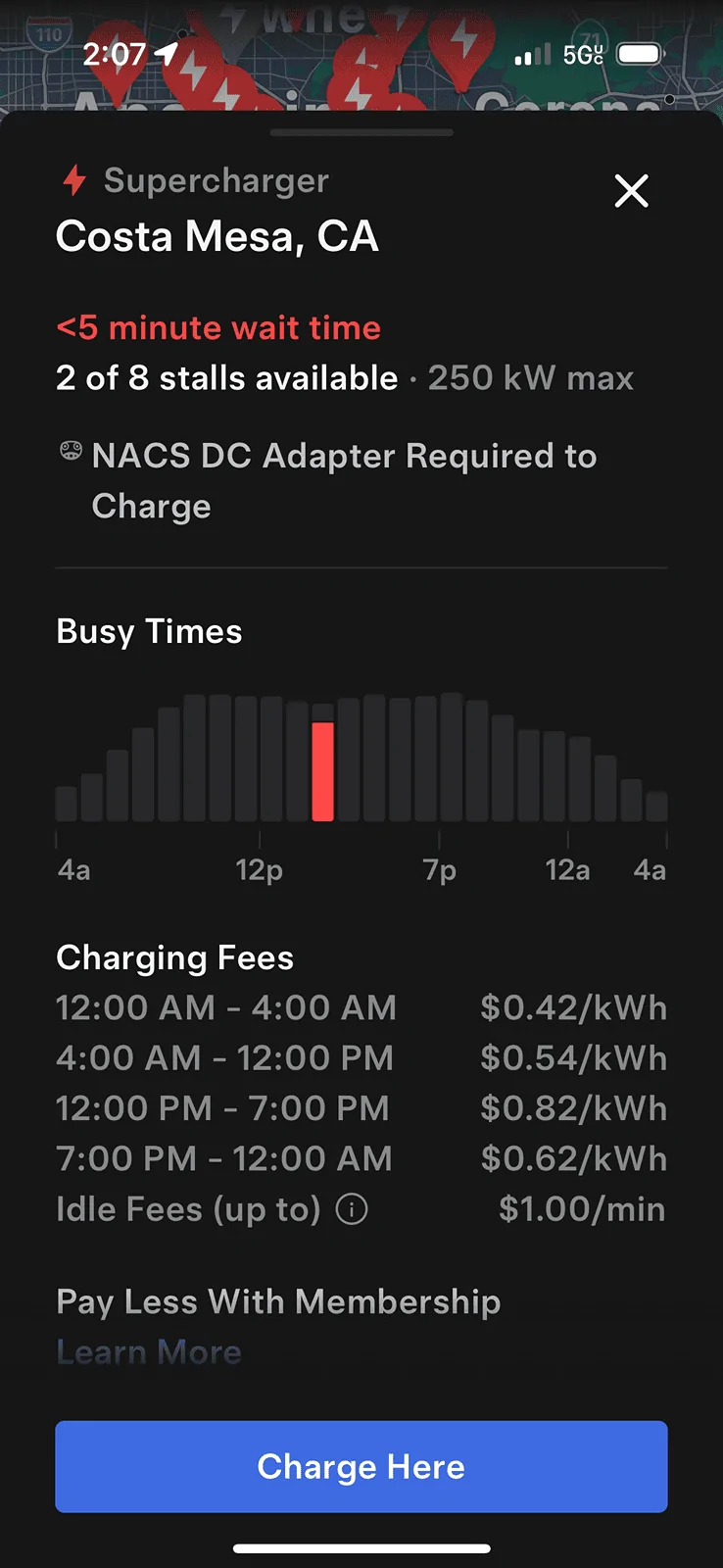

Have you ever compared your expenses on ev vs gas. I used my r1s this weekend and charged it a bit at a public charging station. It was $.50/kwh. It cost me $12.50 for a 57miles added miles. I then realized that it's actually going to cost me more to do a long drive with EV rather than a gas SUV. I would spend about $60 to get about 400 miles added for a range rover evoque while it would end up costing me about $87 to charge multiple times to get up to 400 miles added.
What are your experiences? Is charging in public always going to be costly?
Few weeks ago, I charged my R1S at a Tesla Supercharger. Few min after plugging in, I saw the cost already at $10, then realized that I was paying 80cents/Kwh !!! That mean cost $120 to go from near empty to full - to go for 260 miles at most.
I can spend $100 to top of my Escalade ESV (at $4.20/gal), and that can carry me from OC to Zion park (400 miles). I was in Dallas few days earlier, and with gas at $3/gal, you get even more for your money.
So it only makes sense if you charge at home, especially if you have solar.

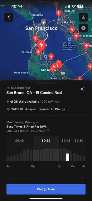

With recent hikes in electricity rates by PG&E it has become very expensive to charge your car at home in California, even during off peak hours. I get around 40 cents per kwH when charging at off peak rates. That is just crazy expensive now.
The truck is a tight fit in the garage, so my options are limited. I’ve only used public charging as it’s about the same price as home charging due to PG&E rates. The EV2-A plan is $0.35 kWh after midnight. RAN is $0.36. Two Tesla superchargers near me at $0.30 with membership & off-peak ToU. In hindsight I should have done more research beforehand but TBH it wouldn’t have mattered because the grin it puts on my face is priceless! ?
Is there a ToU rate for Tesla superchargers? I charge my Model 3 all this time and didn't know.
Maybe it only applies for non-Teslas or certain locations?
