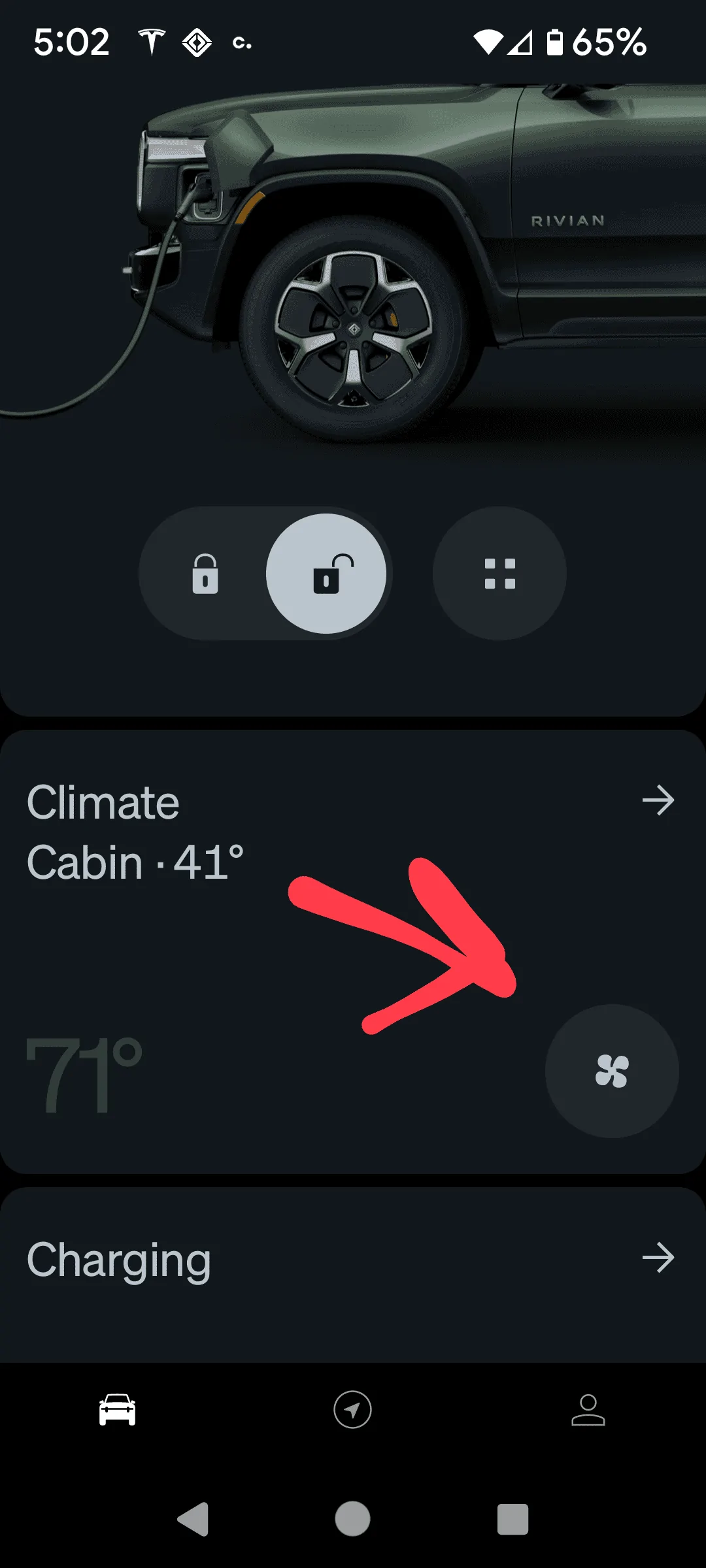

I've recently had the snowflake icon on my screen and it telling me "accelleration and regenerative braking will be limited while until the battery is warmed up".
I've heart that Tesla and other vehicles allow you to tell the vehicle to warm up the battery via the app (ahead of time). Is there any way to do this with the Rivian??
Loving my R1S!
Turn on the climate control from the app, it will not only warm the cabin but it will get the other processes warming as well.
Are you sure?? I tried that the other day, but the battery didn't seem any warmer...?
