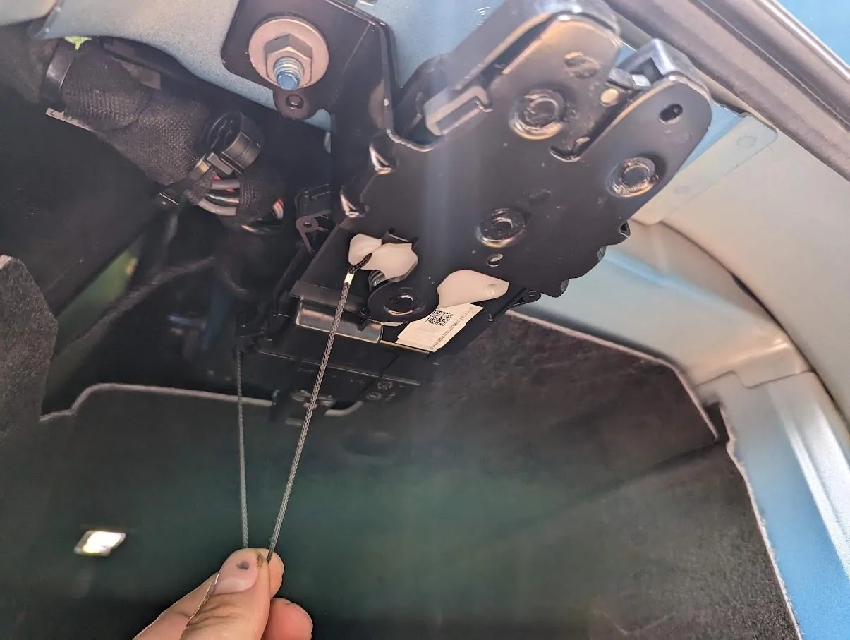

My driver side gear tunnel door latch will not release. The motor whirs, but the door doesn't budge. I thought it a bright idea to crawl in the tunnel (the passenger side still works) and push on the door while pressing the emergency release button. Bad idea. Now the truck thinks there's a living being in the tunnel and will not stop sounding an alarm when I drive. And I mean will not stop; it's been days. The sound system is disabled to make sure I'm hearing the alarm. Over-the-phone technician says nothing he can do. Next week I'll get a visit from a mobile tech--I hope still to be among the sane when s/he arrives!

There's a physical pull release for those doors too, it's hard to get to though, you either have to remove the upper trim or pry down on it enough to get access.
Rivian R1T R1S Gear Tunnel Door stuck; DON'T USE emergency button! PXL_20230728_180243596
I don't have the interior trim in my gear tunnel currently, so pretty easy to demonstrate it.

I've seen people have this happen because the wiring was starting to come unplugged from the switch, so probably the switch being activated will just show this on the display.

I vote for the manual release @Dark-Fx posted about. If you can get the door opened and back closed it should stop the alarm. Thanks for the FYI though I won't be pulling any releases.

Pulling the manual string was able to open the gear tunnel door AND the alarm was terminated! good thing, it is 9 weeks until my service appointment was able to get on the calendar... I sent my 9 year old in and showed her where to pull. Safety disclaimer, I left the other door and the back seat access open while she was in there! (someone needed that disclaimer).
