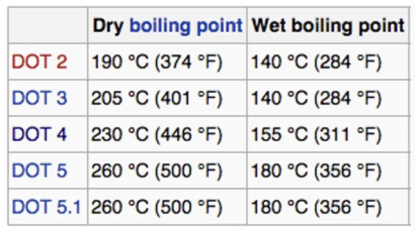

From my understanding, the fluid absorbs moisture and becomes less effective over time. I don't know that mileage matters.
100% on the money. The addition of water to the brake fluid lowers its boiling point. After absorbing water BP drops by 100-150F which can add brake fade within a few hard stops. Braking system function is based on fluid being incompressible. When fluid goes to vapor all bets are off and so is braking performance.
