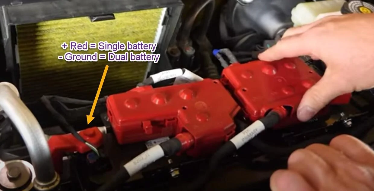

Dumb question is there an easy way to tell if we have one or two 12v batteries? I'm a Mar '23 delivery so right on the edge
It should be fairly easy to pop the cowl cover in the frunk and have a look. Don't know what if there's another way
You'd have to open the panel under the hood to tell, it pops right out. If the passenger side battery block has a ground at the right most position it is dual battery, if positive then single battery. Single battery pictured.
